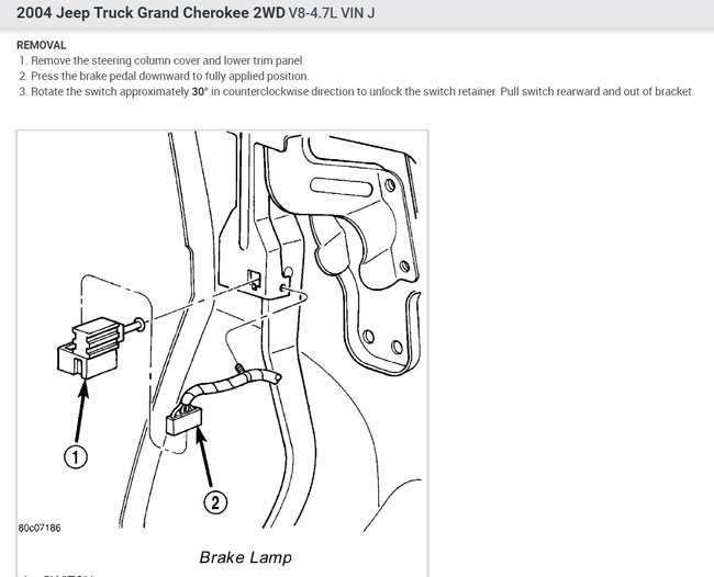

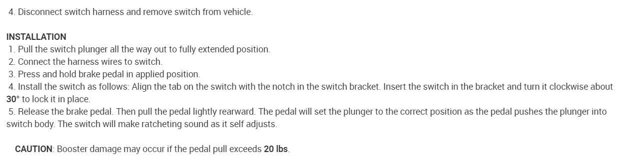

This sounds like the switch is bad or out of adjustment. Here is the location so you can check or replace it. (Diagrams below)
1. Press and hold brake pedal in applied position.
2. Pull switch plunger all the way out to fully extended position.
3. Release brake pedal. Then pull pedal lightly rearward. Pedal will set plunger to correct position as pedal pushes plunger into switch body. Switch will make ratcheting sound as it self adjusts.
CAUTION: Booster damage may occur if the pedal pull exceeds 20 lbs. Check out the diagrams (Below). Please let us know what you find.

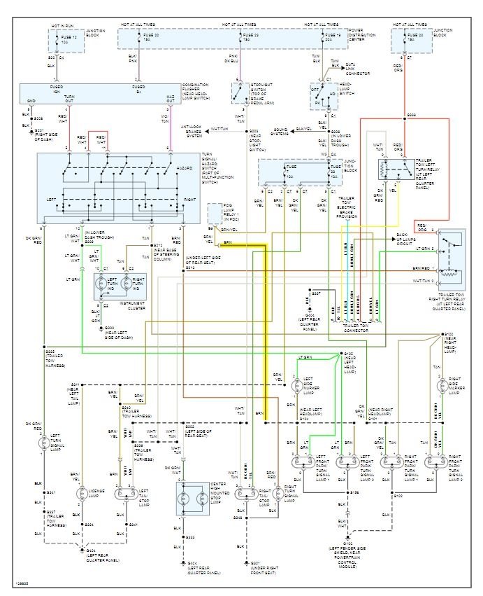

Brake Lights come on when headlights or marker lights are on. When brakes are applied with headlights off, digital odometer readout & radio readout dim. Brakes are working normally. No warning lights are on. Tried replacing stop light switch-no help. Checked all bulbs & wiring to rear lights-lookls OK. Any ideas?
Monday, December 9th, 2019 AT 12:59 PM (Merged)
CARADIODOC
  • 34,489 POSTS
First, if you have a trailer wiring harness, check if it's chewed up and the wires are shorted. One common symptom is the radio display dimming. It has a circuit tied to the tail lights to tell the display to dim when the running lights are on. If you have a U-Haul-installed trailer harness with three red leds in the plug, it used to be common for them to short causing the same symptoms.
If that doesn't look like the problem, there could be a dealer / factory-installed adapter harness that you may be able to remove as a test.
Another common cause used to be using the wrong marker / tail light bulb. Single terminal on the bottom instead of the twin terminal that was needed. Newer vehicles use a flat, plastic-base bulb that this won't happen to. I think that's what you have. This problem applied to the older round, brass-base bulbs.
If none of these solve the problem, search for "beef99". He is a Jeep specialist and may have additional thoughts.

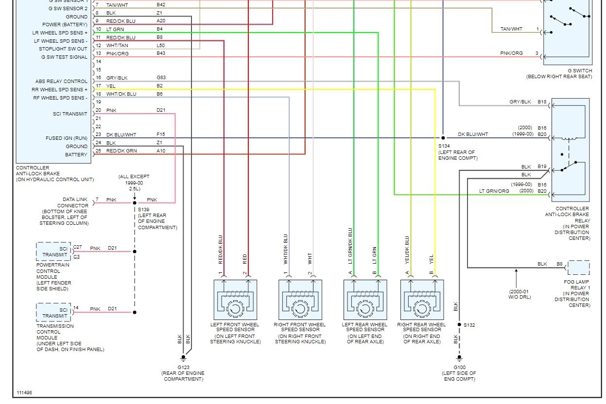

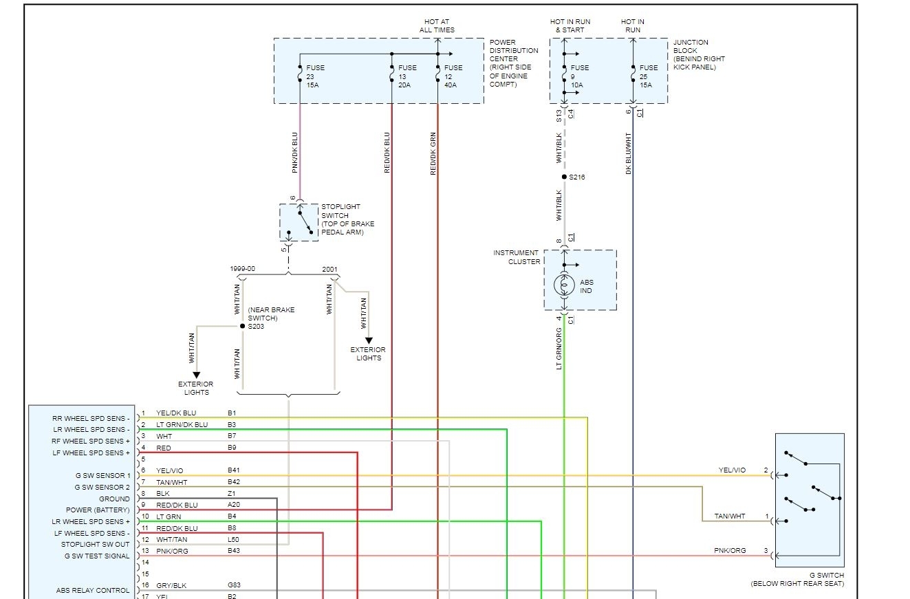

Under your dash you have a brake light switch that has a little button on it. If u follow the arm that has your brake pedal up under your dash you will see a (usually) black switch with a connector on it with a little button that touches the brake pedal arm. There has to be a little rubber bumper in the arm of the pedal to push the button on the brake light switch. If u can crawl up under your dash this is not to hard of a task. You may need to go to the dealer for the part as only select parts stores will have it.
If not the switch, the ABS may have something to do with it
See the guide below on testing wiring
The wiring diagrams for the rear brake lights and the ABS are attached below
