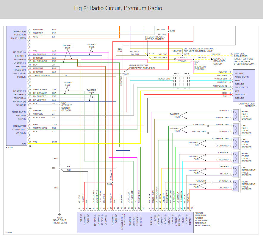

I recently had my car in for repair for the wipers. When I got my car back, the radio display light is no longer working. When I asked the mechanic, he told me that it was "just a coincidence" and "these things happen". As you can imagine, I was not happy about his answer but what could I do. They told me I would need to replace the entire stereo unit. Is this true??? The stereo/radio/CD player still work, but I can't see anything. I can't tell what radio station I'm on, can't see the time, can't see which disc or track I'm on, very frustrating.
Any help is greatly appreciated.

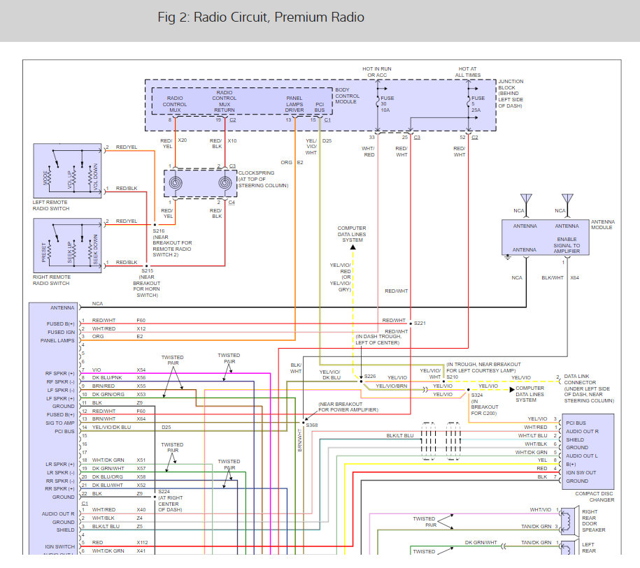

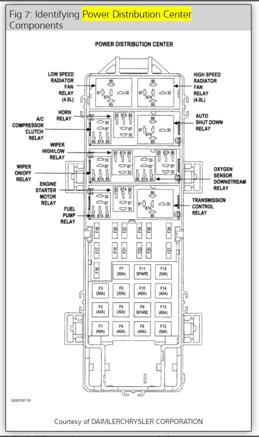

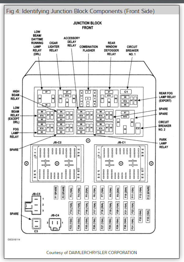

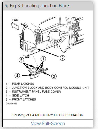

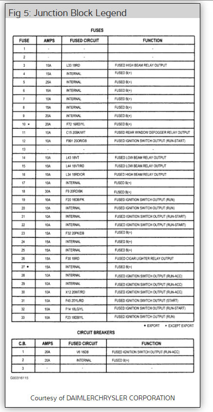

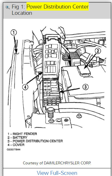

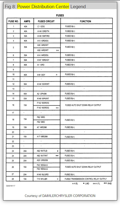

It sounds like the fuse #30 - 10 amp is out. Here is a guide to help you check it and the location of the fuse with the radio wiring diagrams so you can see how then system works.
Check out the diagrams (Below). Please let us know what you find.

I just ran into this problem on a Jeep I just purchased. You'll notice the lights in the buttons all function. Those lights are powered by the same fuse that powers the display. I have seen my display come on intermittently sometimes for short periods and sometimes just flashing once or twice. As a bench repair technician this suggests to me that there's a bad solder joint on the main power supply or main ground to the display inside the radio. I'm actually getting ready to pull it apart in the next day or so to see how difficult it will be to get to the connection. I'm hoping we're dealing with a ribbon or similar such Connection in one easily accessible area. Solder joints are a major cause of faults on Modern electronic equipment.
