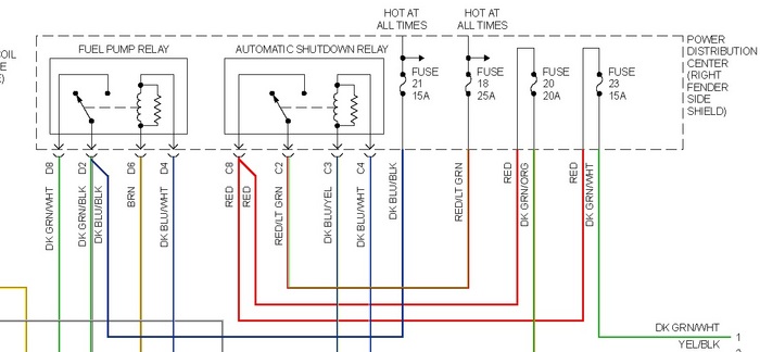

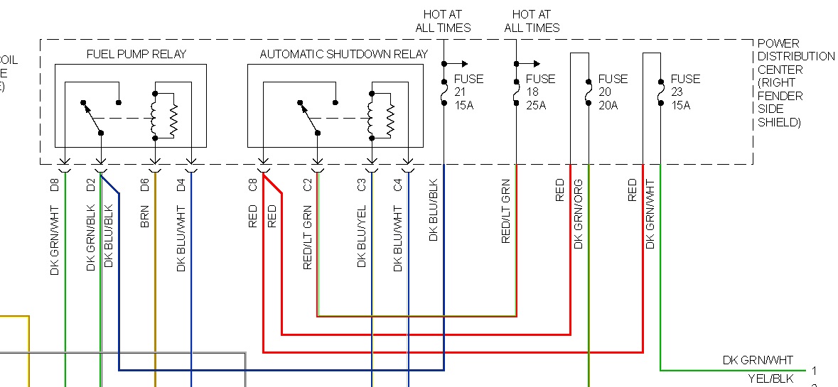

I got a 1997 jeep cherokee, I get no power to fuel pump at all, I checked the relay and it works, but when I test at fuel pump I get no power, there is power going to fuel pump relay, but no power comeing out of it, can you help me?
Monday, March 11th, 2019 AT 3:04 PM (Merged)
JDL
  • 16,098 POSTS
There would be two voltage circuits at the fuel pump relay. One for the circuit/load side of relay, one for the coil/control side of relay. Both circuits are fuse protected. Voltage for the control side of relay, goes hot with key on. Voltage to circuit side of relay, is hot all the time. But, unless the relay is energized, that voltage on the circuit side doesn't go anywhere. When the relay is energized, that line with the arrowhead on it, moves to the other terminal.
Engine cranking, do you have any spark at the plugs. If the computer doesn't see the proper cam and crank signal during cranking, you may not have fuel pump action or spark at the plugs or injector pulse. Any applicable trouble codes?

My jeep would backfire and almost stall, but I could turn the ignition switch off, then on quickly, and it would stop backfiring and run a little better for a mile or so, then the same thing again. Now the fuel pump will not work while in the tank. If I take it out and run a jumper from the battery, the pump motor will run. I am only getting 5.6v to the pump wiring harness plug when I turn on the ignition. I can't even find the pump relay. The Haynes manual says the system has two ballast resistors, but the auto parts stores say they don't show one. Frustrated! Got any ides? Thanks so much for reading this.
JDL
  • 16,098 POSTS
At the pump connector, were you testing the proper wire for voltage, dark green wire with red tracer. A no load test on a fuel pump isn't worth much. I did the same test on a faulty pump, it ran up a storm.
https://www.2carpros.com/forum/automotive_pictures/170934_cherokee_fuel_pump_1_1.jpg
https://www.2carpros.com/forum/automotive_pictures/170934_cherokee_fuel_pump_2_1.jpg
FLATSPIN
I checked the current at the green/red tracer on the fuel pump harness with the switch turned on. I got 5.6 volts, that is not correct, is it? Thanks again, esp, the quick response. Flatspin
+1
JDL
  • 16,098 POSTS
Check it with engine cranking. Have a helper crank it.
Take a reading across battery posts, engine cranking, what is the reading? Then take reading at the wire in question, engine cranking, should be close to same reading?
