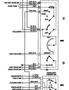

Hi, I'd have to check park fuse, use a testlite, make sure the circuit is hot. Then I'd check the circuits at the headlamp switch.
