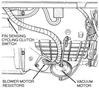

https://www.2carpros.com/forum/automotive_pictures/52960_0900c152800a9d07_1.jpg
Fig. 1: View of the evaporator/blower housing components

Disconnect the wiring at the A/C relay, blower motor resistors and A/C thermostat. Disconnect the vacuum hoses at the vacuum motor.

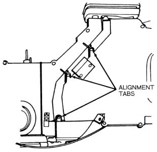

Cut the plastic retaining strap that retains the evaporator housing to the heater core housing.

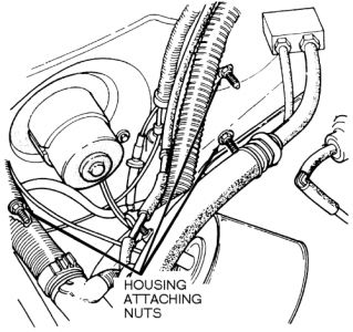

https://www.2carpros.com/forum/automotive_pictures/52960_0900c152800a9d08_1.jpg
Fig. 2: View of the evaporator/blower housing control cable and retainers

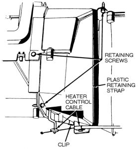

https://www.2carpros.com/forum/automotive_pictures/52960_0900c152800a9d09_1.jpg
Fig. 3: View of the evaporator/blower housing retaining fasteners
https://www.2carpros.com/forum/automotive_pictures/52960_0900c152800a9d0a_1.jpg
Fig. 4: View of the evaporator housing tabs
Disconnect and remove the heater control cable.
Remove the clips at the rear blower housing flange and remove the retaining screws.
Remove the housing attaching nuts from the studs on the engine compartment side of the firewall.

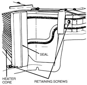

Gently pull out on the right side of the dash and rotate the housing down and toward the rear to disengage the mounting studs from the firewall. Remove the housing.
Unbolt and remove the core from the housing.

https://www.2carpros.com/forum/automotive_pictures/52960_0900c152800a9d0b_1.jpg
Fig. 5: When installing the heater core make sure the seal is properly installed
