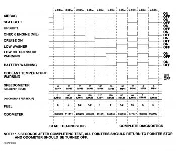

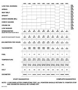

ACTUATOR TEST
Diagnostic Aids
Instrument actuator test will put instrument cluster into self-diagnostic mode. In this mode, instrument cluster will position each of the gauge needles at various specified calibration points, and turn all Chrysler Collision Detection (CCD) data bus message-controlled indicator lights on and off at specified time intervals. See Fig. 1 or Fig. 2 . Successful completion of actuator test will confirm that instrument cluster circuitry, gauges and indicator lights are capable of operating properly. If test is successful, a problem may still exist with CCD data bus, Powertrain Control Module (PCM) or Air Bag Control Module (ACM).
If an individual gauge does not respond properly or at all during actuator test, remove instrument cluster. Check tightness of suspect gauge mounting screws on printed circuit board. If screws are loose, reinstall instrument cluster and retest. If screws are tight, replace instrument cluster.
If an individual indicator light does not illuminate during actuator test, remove instrument cluster. Check indicator light bulb and bulb holder. Repair as necessary and retest. If indicator bulb is okay and bulb holder is installed properly, replace instrument cluster.
Actuator Test
Turn ignition off. Depress and hold down trip odometer reset button. Turn ignition on. DO NOT start engine. Release trip odometer reset button. Compare operation of suspect gauge(s) and/or indicator light(s) with chart. See Fig. 1 or Fig. 2 .
Instrument cluster will exit self-diagnostics mode at completion of test, or if ignition switch is turned off. If instrument cluster gauge(s) and/or indictor light(s) do not respond properly during actuator test, see DIAGNOSTIC AIDS before replacing instrument cluster. Repeat actuator test if necessary.
Fig. 1:
https://www.2carpros.com/forum/automotive_pictures/266999_test_1.jpg
Fig. 2:
https://www.2carpros.com/forum/automotive_pictures/266999_test1_1.jpg
