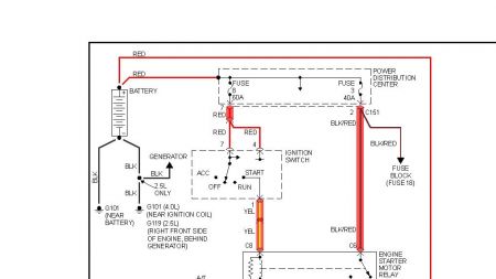

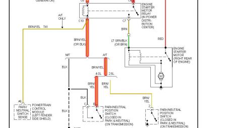

The electrica are onb. I have Lights. Turn egnition. Nothing. Just a click. Have chercked both fuse boxes.
Monday, June 30th, 2008 AT 10:24 AM
MECHANIC
75,992 POSTS
Test the battery/connections -could be fuses/ignition switch/starter relay/park and neutral switch or starter itself -
