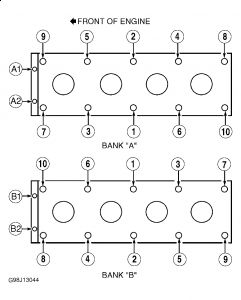

TORQUE SPECS FOR CYLINDER HEADS AND THE PATTERN FOR TORQUE OF THE BOLTS

Cylinder Head Bolts
Step 1 (8 & 10 mm Bolts)........Hand Tight
Step 2 (10 mm Bolts)............Ft.Lbs 15 N.m(20)
Step 3 (10 mm Bolts)....................26 (35)
Step 4 (10 mm Bolts).............Additional 90 Degrees
Step 5 (10 mm Bolts).............Additional 90 Degrees
Step 6 (8 mm Bolts)...................17-20 (23-27)
