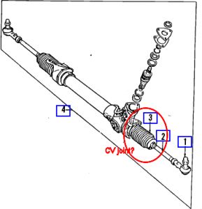

So the two boots on either side of the front shaft cover the CV joints? And those would cause the popping and the noise? I read that when the boots rip and the grease washes away that this will happen. I just want to make sure that I am clear with this. You are right... the Alldata parts explosion diagrams tell you nothing....
Is it safe to drive the vehicle until the part arrives? And if so, can I make a 200 mile round trip?
https://www.2carpros.com/forum/automotive_pictures/220061_helper_2.jpg
Saturday, December 19th, 2009 AT 1:34 AM
IMPALASS
  • 3,112 POSTS
Hello -
Thanks for the info. . .. . ..good pic. . .. . .. . .I believe if you look at the number 3, click on it, it may be called a bellows or a boot. Either way, is item 3 the boot that is torn? If so there is no grease behind this. You can take a good visual and verify.
I included below a pic from a Ford Taurus for you to also see a little bit better break down. The red arrow pointing to number 23 is the boot for this tie rod. Is this what is torn on yours?
https://www.2carpros.com/forum/automotive_pictures/248015_Picture2_64.jpg
When we speak of CV boot, (Constant Velocity) this usually means the boots on the drive axles that come out of the transmissions and go into the center of the wheel spindle. Of course Jag didn't provide us a good pic so what I did was put a pic of the CV boot below from a Ford Taurus for you to see. If you look at number 4 that is circled, you will see a joint that has some ball bearings. The CV boot, number 6 goes around these and fits over number 1 and is held in place by clamps 5 and 7 and is full of grease since this a joint and is spinning at high speeds.
https://www.2carpros.com/forum/automotive_pictures/248015_Picture1_101.jpg
Compare yours to this and so if you are sure there is no grease in yours and it is the tie rods coming out of the rack and pinion, then we can press from there.
Now if it is the tie rod boot and not the CV boot, then I would say yes, it is safe to drive if there is no damage to the tie rod itself. The only thing I would do is take some plastic and wrap around it and secure with plastic ties. Make sure the plastic is loose enough to expand and contract as the tie rod goes in and out.
Okay, I know that is a pretty crazy temp fix but I have done it before. Looks stupid. But you are just wanting to keep dirt etc out of that as best as possible.
Now the pop you heard is what concerns me. That could be a ball joint, tie rod end etc. That needs to be checked before your trip.

I believe that the inner tie rod boot is what is ripped. After looking into this more. When my buddy felt around under the car he said that it was sagging a bit. I am starting to think that its the inner tie rod end. I guess that I should stay put until I fix this thing, right? This is my primary car. So this is why I ask. I am not sure of the consequences. I am new to repair.

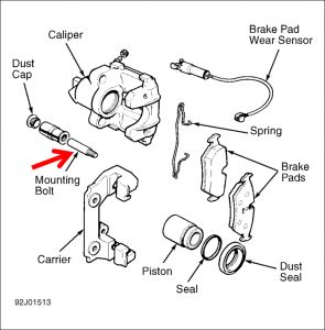

Well, I found my problem. The bearings on the front passenger side were. Well, fried to say the least. As for the tie rod it was fine. The bearings were so far gone that it caused that big of steering issue. I wish that I would have caught on to that earlier.
When I disassembled the wheel I noticed that the brake disc securing screw was gone as well (the screw that secures the rotor to the hub assembly). I am sure that this isn't helping matters in the very least. I can not find the specs on that screw anywhere though. I need size, and torque. Can you help me with this at all?
As for the boot and the leek. The leek is coming from the steering gear and actually getting into the boot. There was no grease in the boot, just fluid. I don't think that should be happening! (Or is this a jag thing?) I have a new boot on order.

Not sure if you did but you might consider remove/replacing the other side bearing too. It has just as many miles. . .. . .. . .how did the grease in it look?
If it is the one in the pic below that most likely will come from the dealer. Some I have gotten from Auto Zone or O'Reilly's but since it's jag. . .. . ...well you know.
That is a special size etc. . .. . .so jag parts for the caliper bolt.
https://www.2carpros.com/forum/automotive_pictures/248015_F7_4.jpg
Caliper Mounting Bolts
Front 50-60 Ft Lbs
Rear 49-55 Ft Lbs
No, shouldn't be any fluid. . ...There is an O-ring in there at the end of the rod. My thought is when you are at Jag have them print out the IPB on that area. Sometimes you can replace the O rings sometimes the entire Rack must be replaced. If it is only a small amount of fluid then I would install the boot and press.
