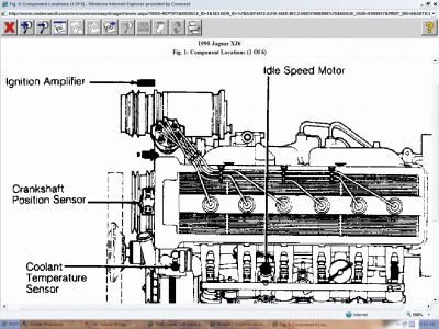

engine cranks but wont start Error code Fuel/fail 24. What are the areas that should be checked

Code 24? That comes up as the ignition amplifier, right front corner of engine compartment.
