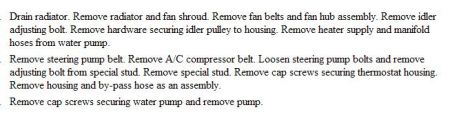

Engine Cooling problem
1986 Jaguar XJ6 6 cyl Two Wheel Drive Automatic
How do I replace a water pump on a 1986 jaguar xj6 thanks.

Procedures are below for replacing your vehicle's water pump...
