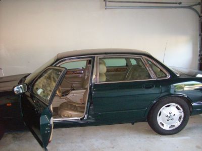

1995 Other Jaguar Models 6 cyl 200000 miles
need to get info. on problem code# P1777.
Also, Trac light is showing as off. Unable to
pass emissions inspection. [img:98c8c5fe34]http://www.2carpros.com/forum/automotive_pictures/374723_1995_Jaguar_XJ6_1.jpg[/img:98c8c5fe34]
