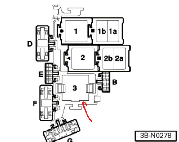

It will crank over but wont start its giving me a P0685 code I replaced all fuses i found the fuel pump relay bad bought a new one and it still did not start i checked if it was getting fire it was not getting fire i dont know what to do can someone please help me thank you

Okay, this code is the clue, we need to check the engine computer fuses and if they are okay change out the relay.
P0685 - ECM/PCM Power Relay Control Circuit/Open
Here is a guide to help you check the fuses, be sure the key is on before testing.
Check out the images (below). Let us know how it goes

I replaced all fuses with new but i dont know where all the relays are i know where some are but i dont have diagram for what they are because i dont have a owners manual or anything

Ken i cant find where that panel is on my car i cant find it

The relay panel and 13-position auxiliary relay panel are located in the driver side footwell, behind the lower instrument panel trim. The 8-position auxiliary relay panel is located just behind the relay panel and 13-position auxiliary relay panel.

Can you send me a picture of the relays and what they run like the ignition coils and stuff like that cuz I don't know what relay runs the ignition coils cuz they are not firing
