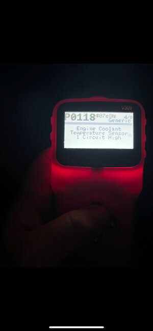

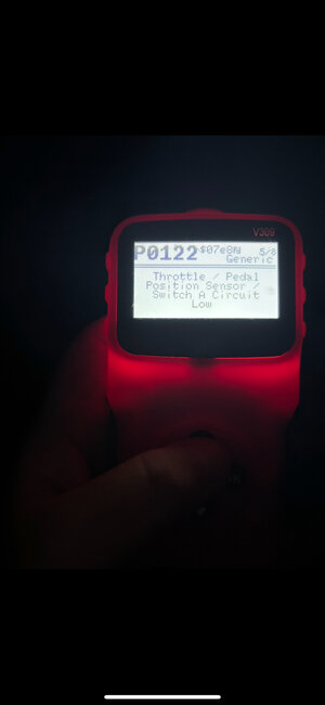

KKIRKMAN12
  • 9 POSTS
Here’s what it says, along with a video that shows what it sounds like. It gives the throttle pedal code, but it’s already been replaced and the throttle body sensor as well. So not sure why it still throws that code.

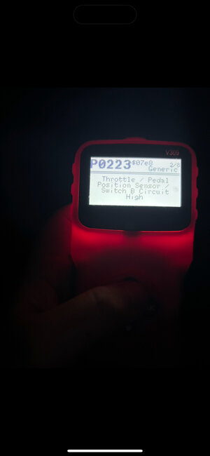

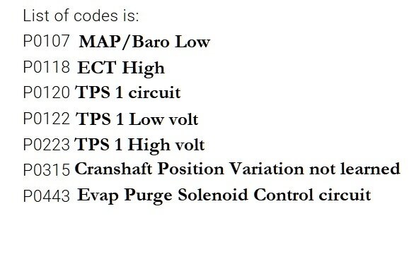

It gives code for everything that has been replaced already. So, I am not sure what else to do or what else it could be. I reran the codes, and this is what it gives me.
List of codes is:
P0107
P0118
P0120
P0122

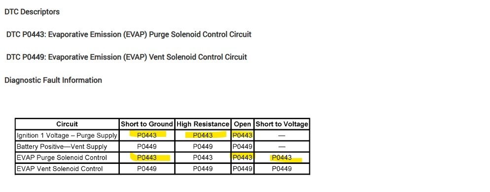

P0223
P0315
P0443
Sunday, October 27th, 2024 AT 2:17 PM

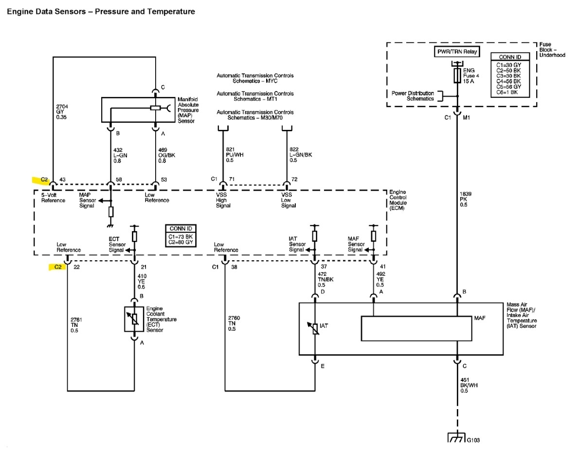

AL514
  • 5,595 POSTS
Just because you're getting a code for a component does not mean that part is bad, never replace a part without testing the circuits that go to it first. Let me look up all these codes and see if there is any circuit that may be related to each sensor.

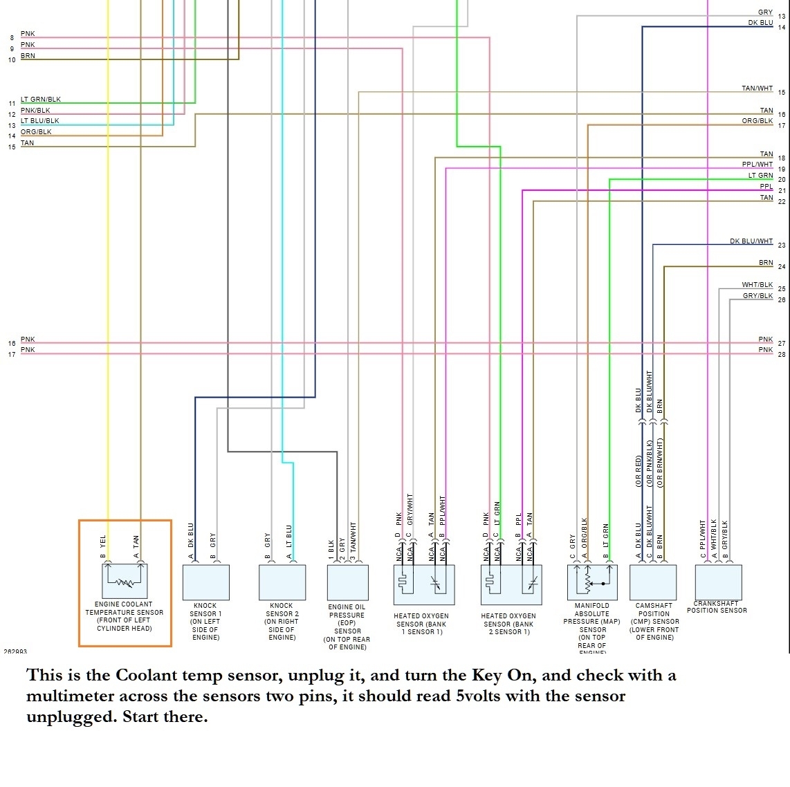

But also, this P0118 Coolant temperature high code is probably why you are getting that message, let me get the PCM wiring diagrams together really quick.

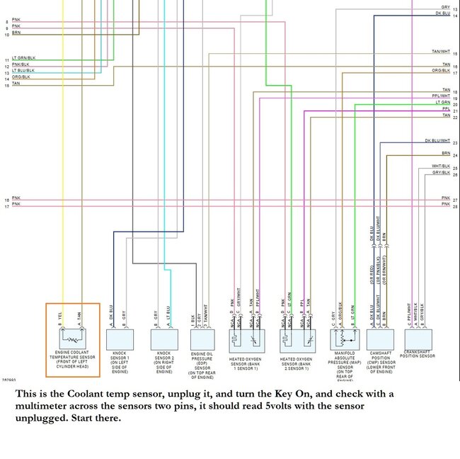

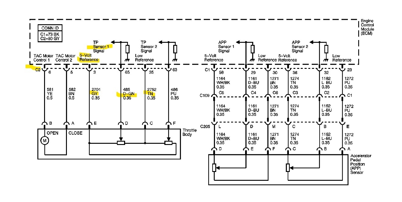

AL514
  • 5,595 POSTS
Start here, this the coolant temperature sensor, first check the voltage reading from the wiring harness plug with the sensor unplugged. Key On, you should read 5 volts.
Notice it is a 2-wire sensor, with one yellow wire and the other tan.
Sunday, October 27th, 2024 AT 2:28 PM
KKIRKMAN12
  • 9 POSTS
It reads 3.09 but we’ve replaced it when we changed everything else too, thinking that was part of the problem. We changed it with the crankshaft sensor and still having the same issue.

AL514
  • 5,595 POSTS

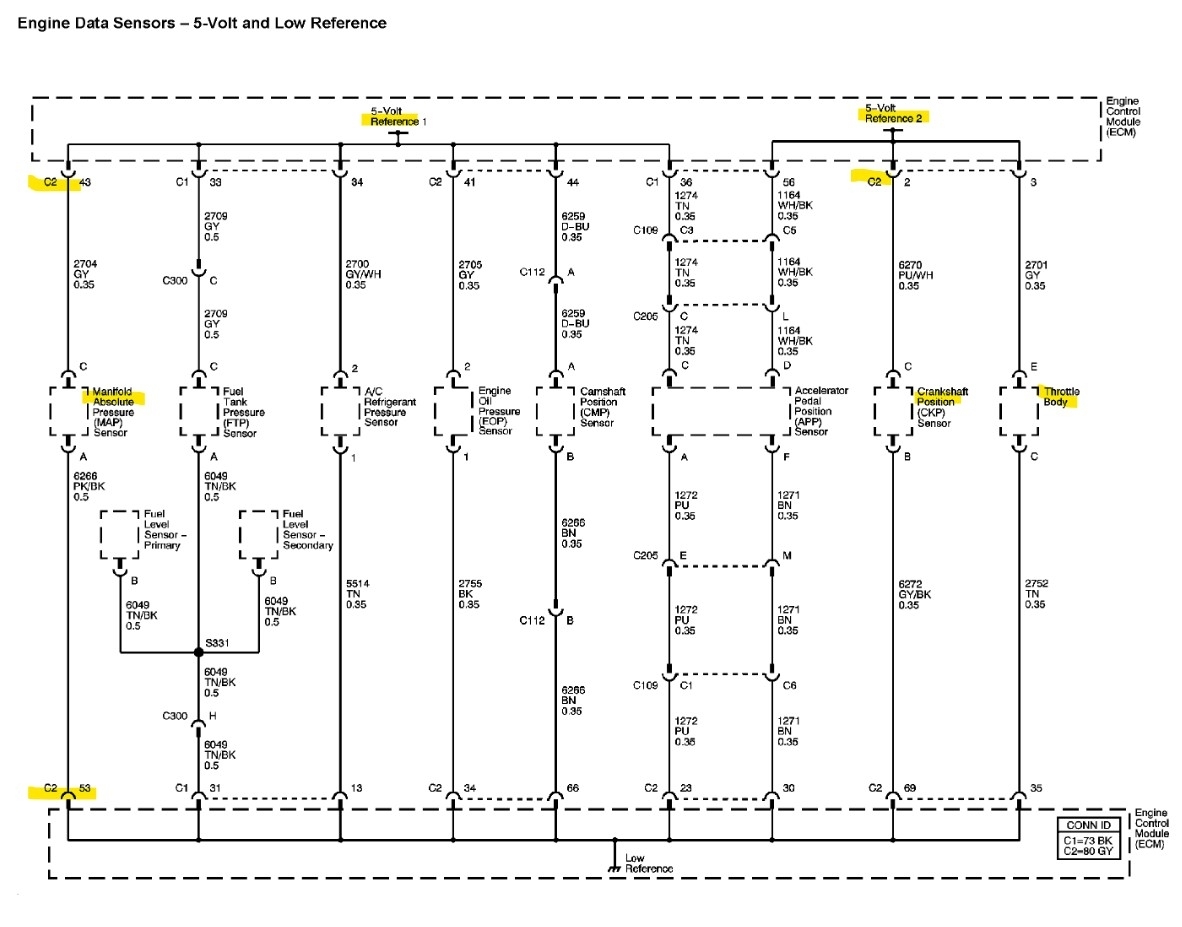

The Coolant temperature sensor harness plug reads only 3-volts while unplugged from the sensor? It doesnt matter if you replaced it, Im asking about the wiring going to the sensor, not the sensor itself. With this many codes, you have a wiring or PCM issue.
If you read 3volts on the yellow wire with the sensor unplugged, so its out of the picture completely. That 3 volts should be 5volts, and thats the issue here. Low Reference voltage is also what is probably causing all the other codes as well,
The Crank pos sensor code is because you replaced the sensor but did not do the Crankshaft variation Relearn Procedure, so ignore that for now. The 3-volts is a problem.

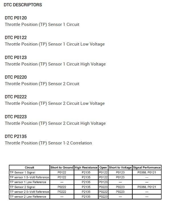

AL514
  • 5,595 POSTS
Well, charge the battery overnight, and we will proceed with testing tomorrow then, but you have a wiring or connector issue happening here. Here are all the OEM diagrams for everything setting a code, but you need to have a fully charged battery and then keep and maintainer on it while testing later so battery voltage doesn't drop off.

So, am I supposed to test the harness that is unplugged from the sensor or the sensor itself? I did the sensor that is on the motor not the harness and that read 3V.

Yes, unplugged and check the ECT not the TPS right now but let the battery charge overnight or the readings are going to be incorrect, and the testing will not give accurate results, I'll help you test the harness and these sensors tomorrow, so we have time to go over them correctly. Check the PCM connectors for any green corrosion inside the connector pins on the harness side.
