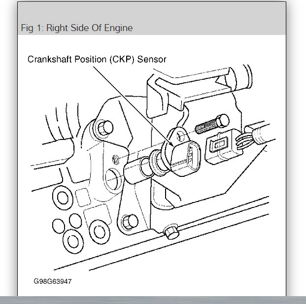

My trooper will turn over but won't start. Engine has spark and makes grinding noise when attempting to start it.

Do me a favor, see if it will start for a couple seconds using starting fluid. If it does,. then we know it is a fuel related issue. Since you have spark, either it is fuel related or something internal has failed.
As far as the noise, is it the starter making the noise or the engine itself? You have me questioning of it is a timing belt issue. If it is a belt or timing issue, it won't start with starting fluid and we will need to confirm timing by performing a compression test.
The good news is that this isn't an interference engine, so no damage would have happened if the belt broke or jumped.
Here is a link you may find helpful. Also, if it is possible, record the engine cranking and upload it so I can hear what is happening.
Let me know what happens.

It was the crankshaft angle sensor, I got a new one started right up thank you.

SCGRANTURISMO
  • 4,897 POSTS
This could be a problem with your vehicle's Crankshaft Position Sensor (CKP). Your vehicle uses the information from the CKP to determine the rotational speed of the crankshaft for ignition timing. If your vehicle's Power-train Control Module (PCM) does not get this signal it will not spark the spark plugs and your vehicle will not start. I have included a few links below for you to go to.
https://www.2carpros.com/articles/how-a-crank-shaft-angle-sensor-works
I have also included in the diagrams down below the information on the location of the CKP for your vehicle. Please go through these guides and get to us with what you are able to find out.
Thanks,
Alex
2CarPros
