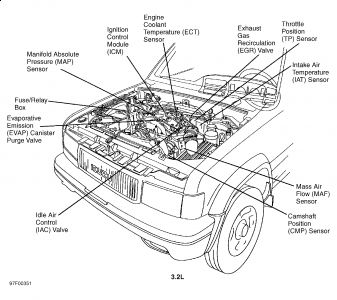

Codes indicate faulty O2s. cattalytic convertor and miss in cyl. 5 also EGR circuit open /short. How long since last tune? If you have an OHM meter check resistence of Engine Coolant sensor rear engine in coolant manifold.
https://www.2carpros.com/forum/automotive_pictures/198357_Graphic_414.jpg
Clean MAF sensor with appropiate cleaner.
ECT ohm reading at 68 deg is 3500 ohms

Plugs, air&fuel filters clean MAF and throttle body. Check ECT resistence maybe cause for stumbling at cold start
