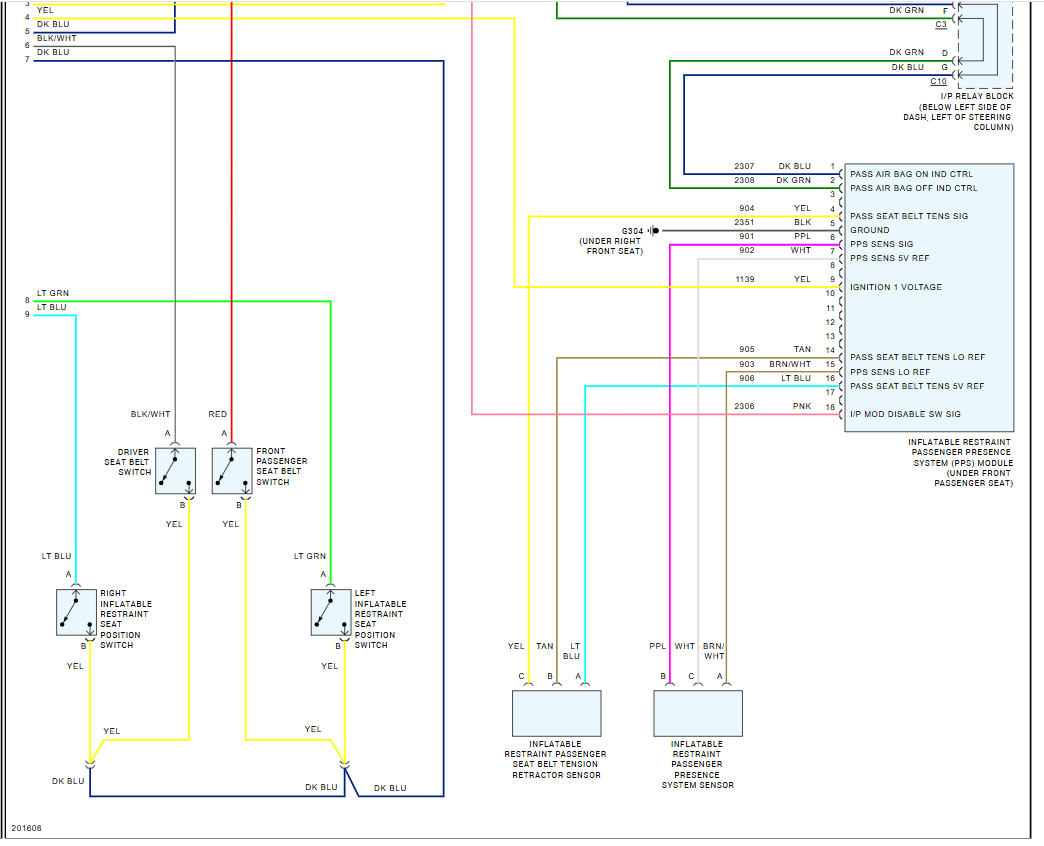

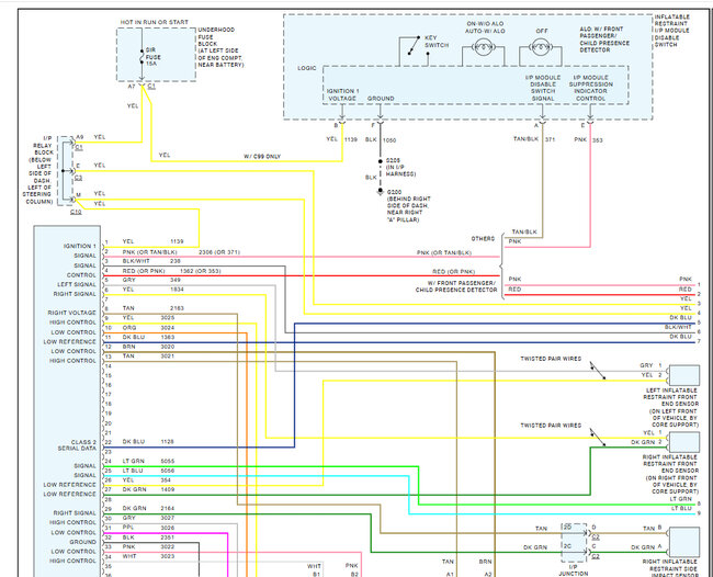

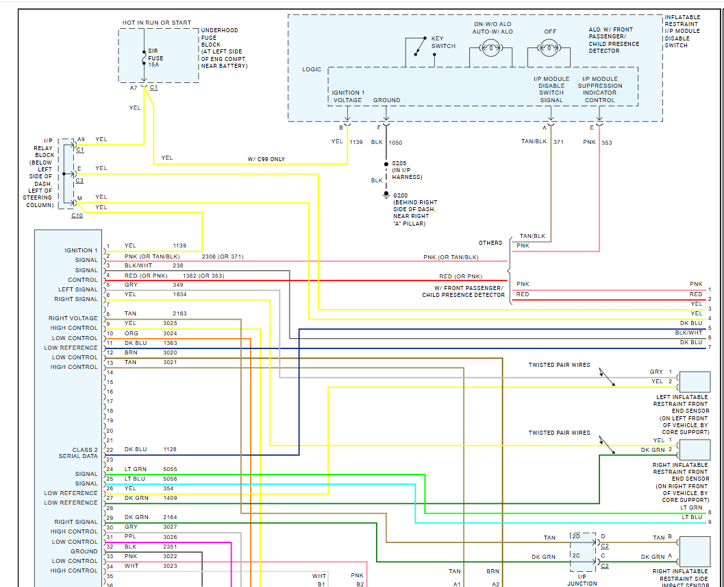

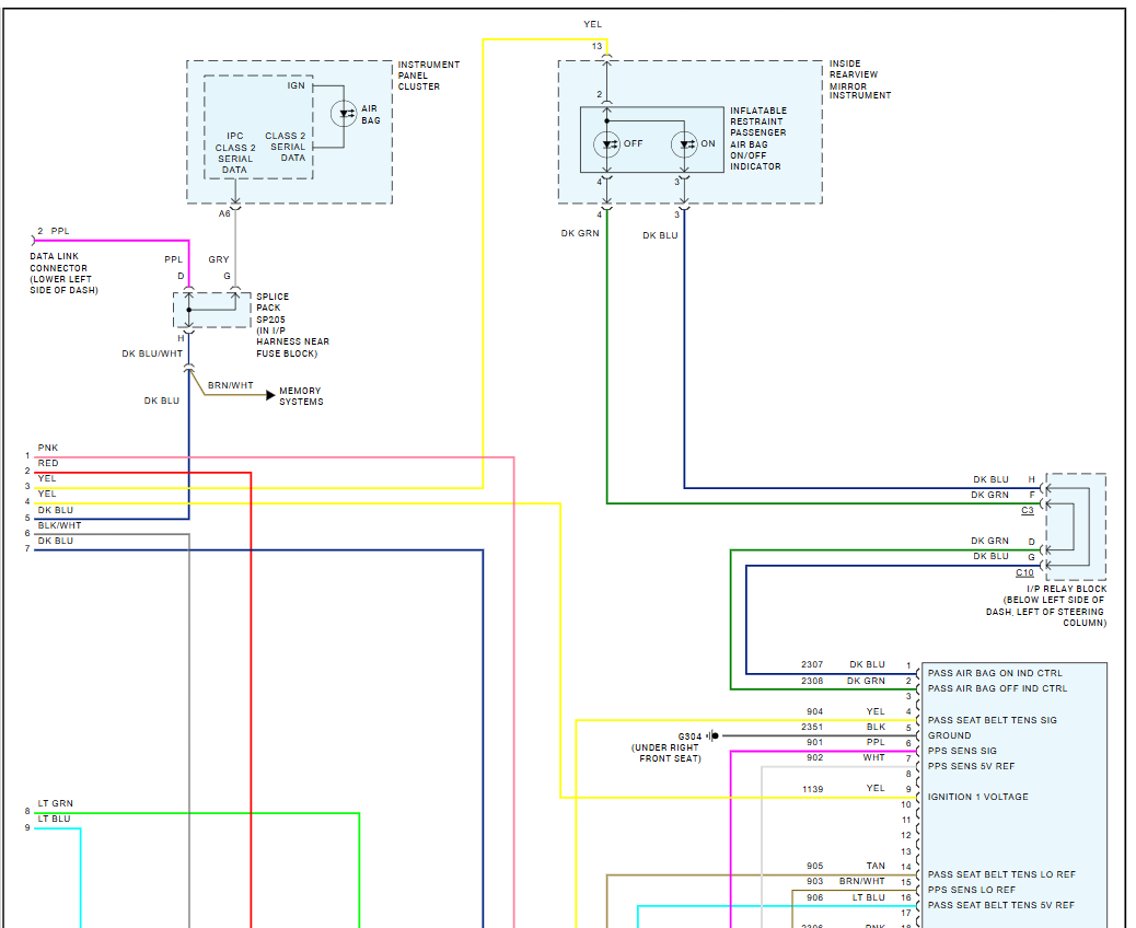

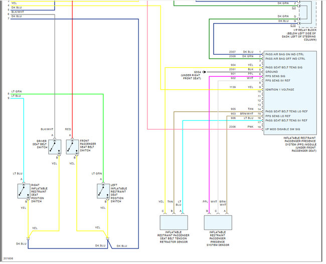

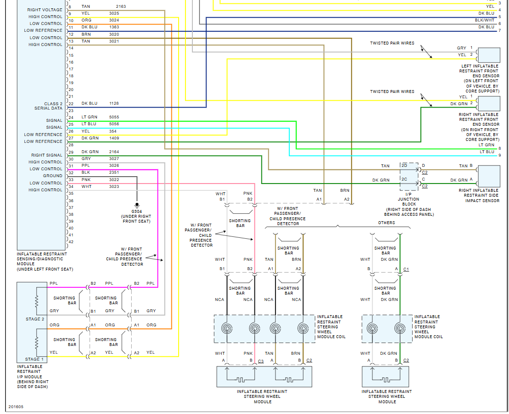

You said the wiring has been tampered with, correct? Because you have many problems, and I don't know if this is one issue or many. I can tell you that LED bulbs can cause the dimmer problem. Can you tell if the airbag system wiring has been cut or spiced into for some reason? Here are the wiring diagrams for the airbag system so I can check it out, I would have the battery disconnected before working on the system. Also, for the battery drain issue please start another thread. I think this problem is separate. Here is a guide so you can check the wiring:
I can tell you that the clock spring behind the steering wheel goes bad. If you find a wiring problem and repair it clear the codes once the job is completed. Check out the images (below). Please let us know what happens.
