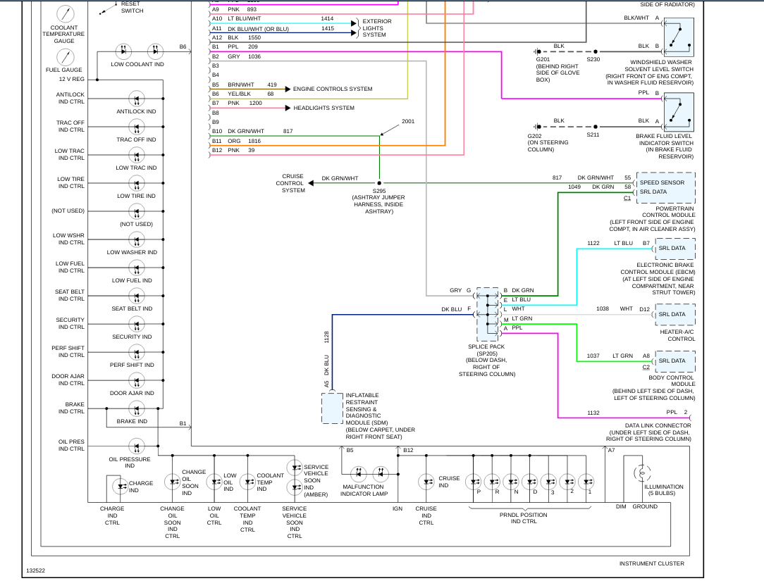

Is there a separate fuse for odometer reading?

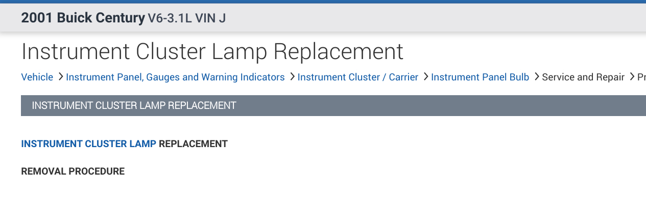

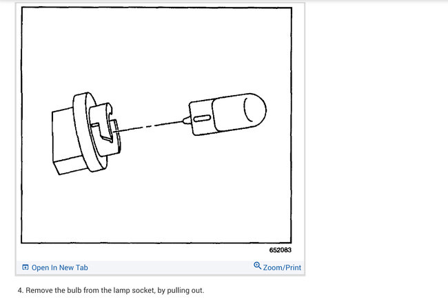

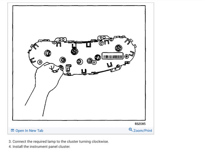

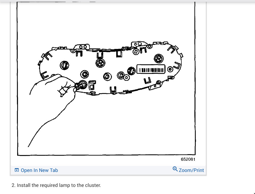

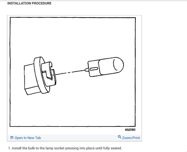

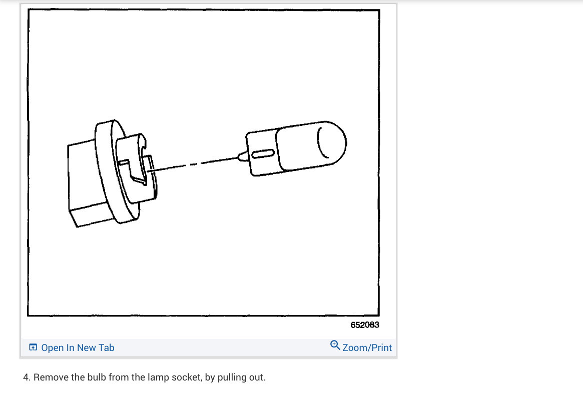

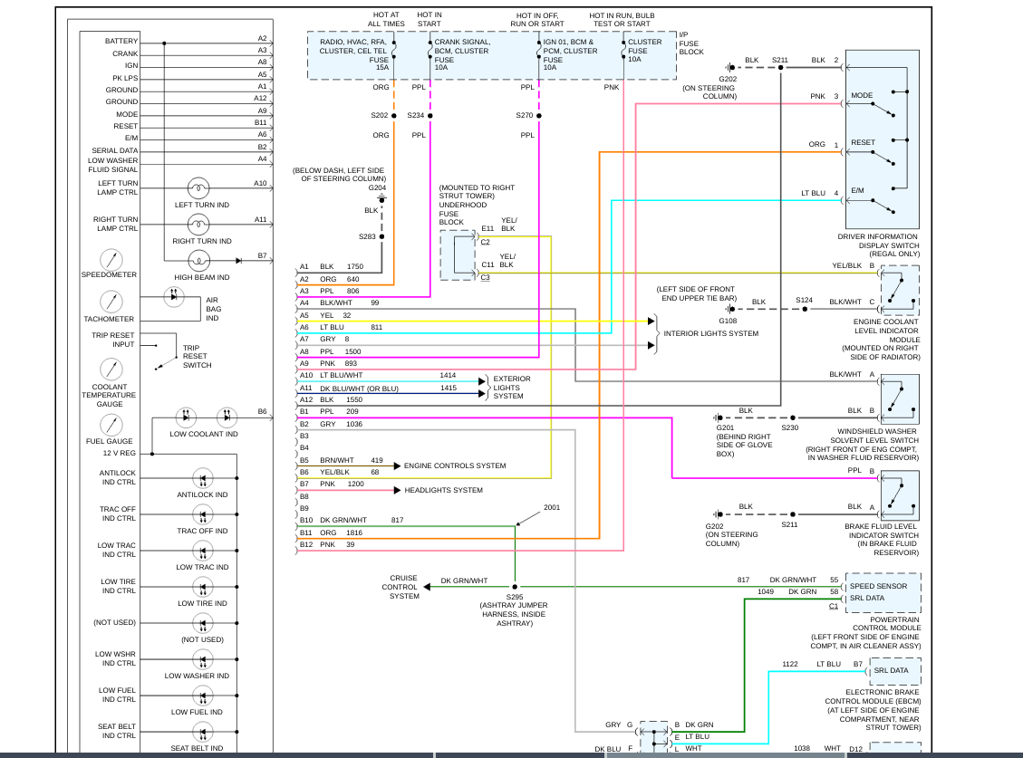

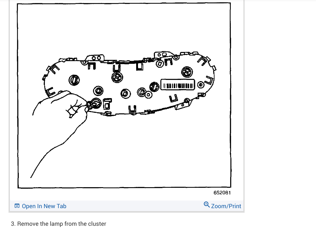

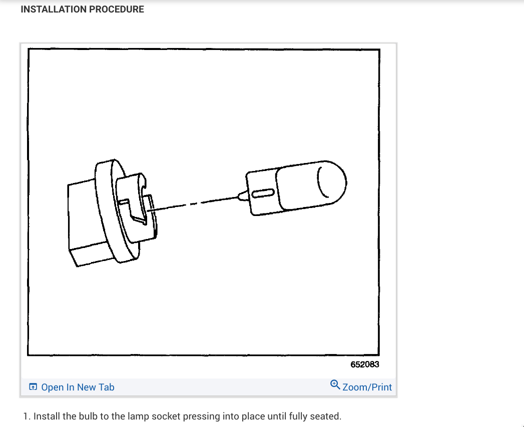

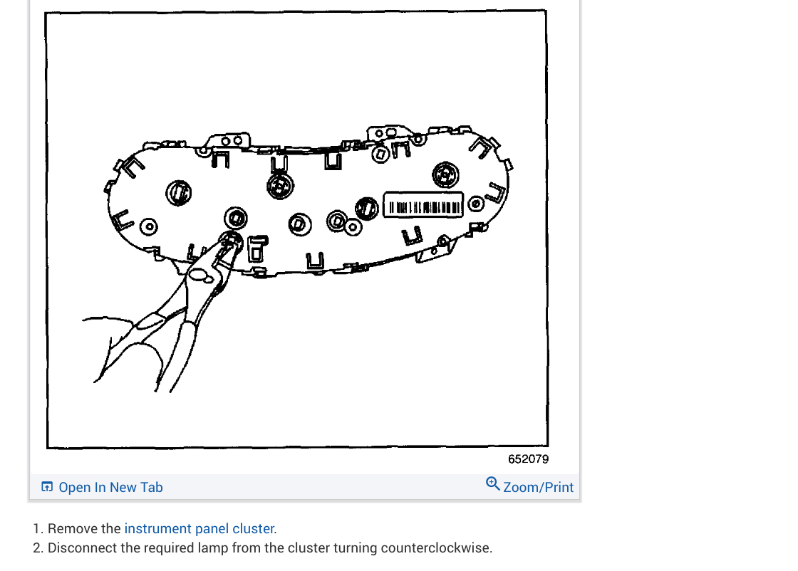

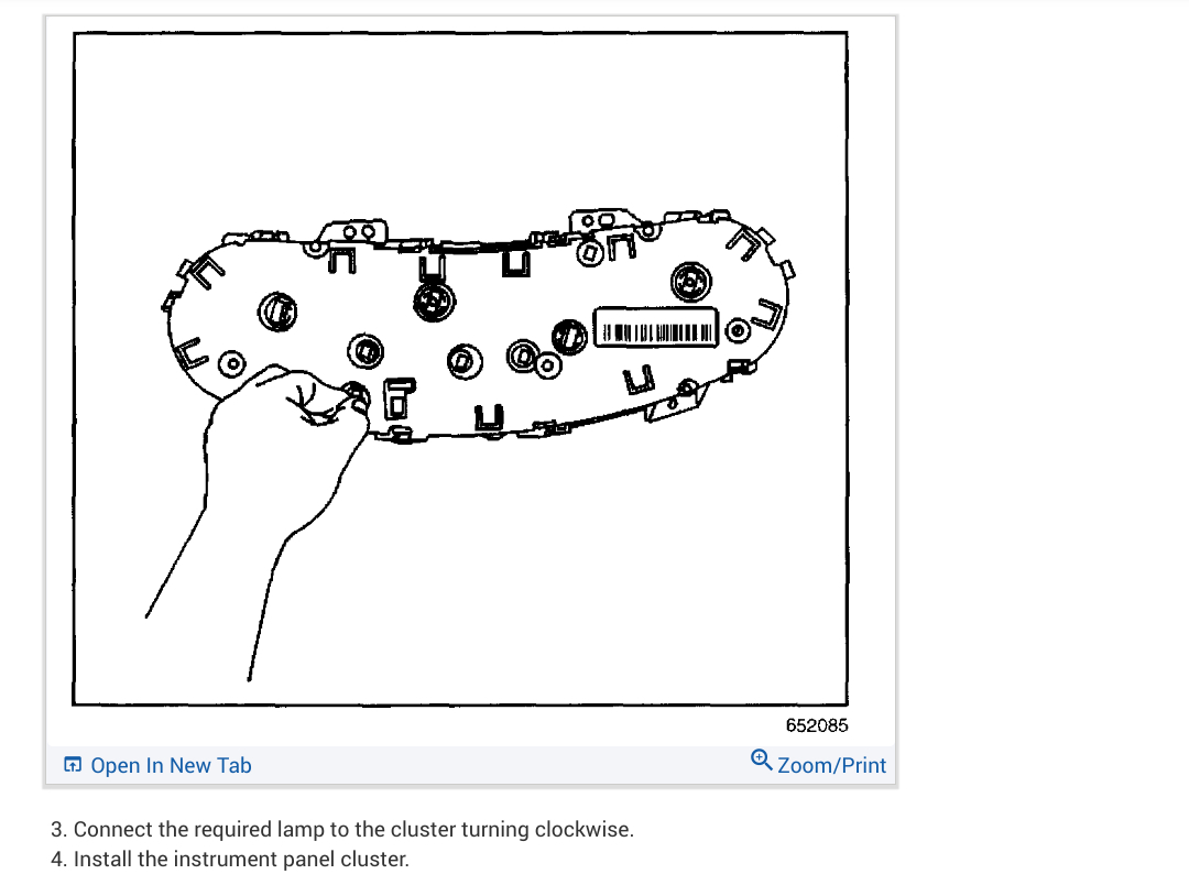

No, this is probably just going to be burnt out bulbs. In the diagrams down below I have included the instrument cluster wiring diagrams and the instructions for the removal and installation of the bulbs in your vehicle's instrument cluster. Please go through these guides and get back to us with how everything turns out.
