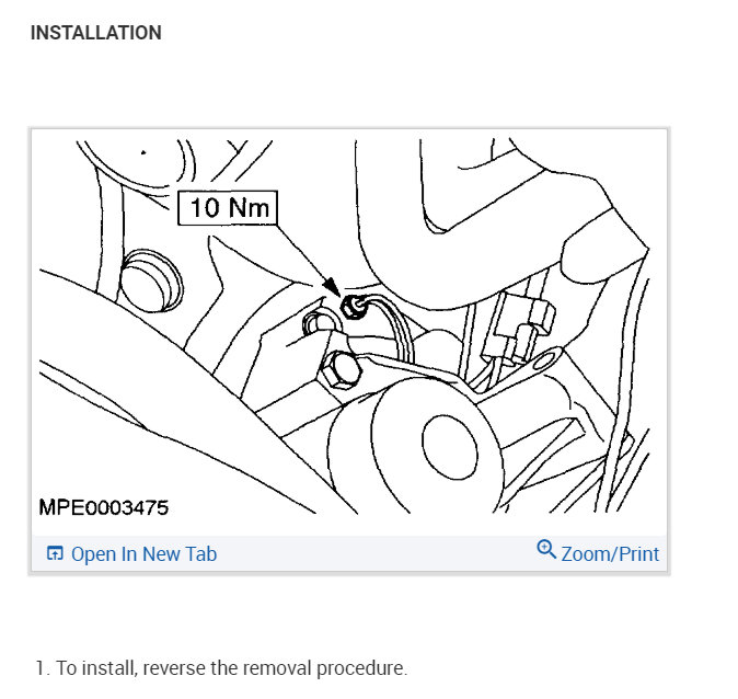

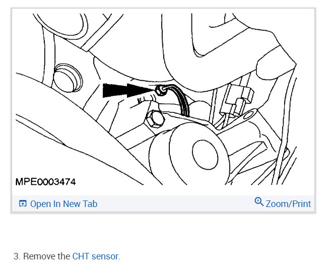

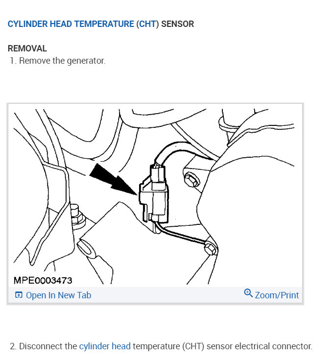

Engine management light came on with code P0118. Is the engine coolant temperature sensor located in the thermostat housing on a 1.6l Sreetka?
Sunday, June 30th, 2019 AT 4:13 AM
KEN L
  • MASTER CERTIFIED MECHANIC
  • 55,350 POSTS
We don't have this car in this state but I think this will work. here is a guide to help walk you through the repair and diagrams below to show you the location on your car below:
https://www.2carpros.com/articles/coolant-temperature-sensor-cts-replacement
