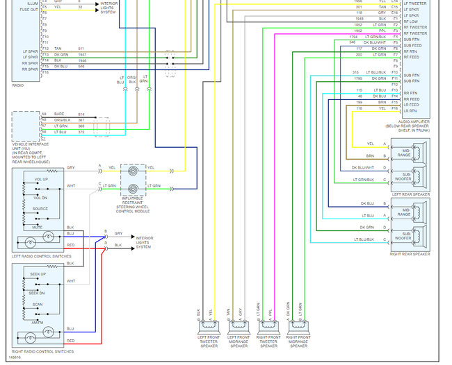

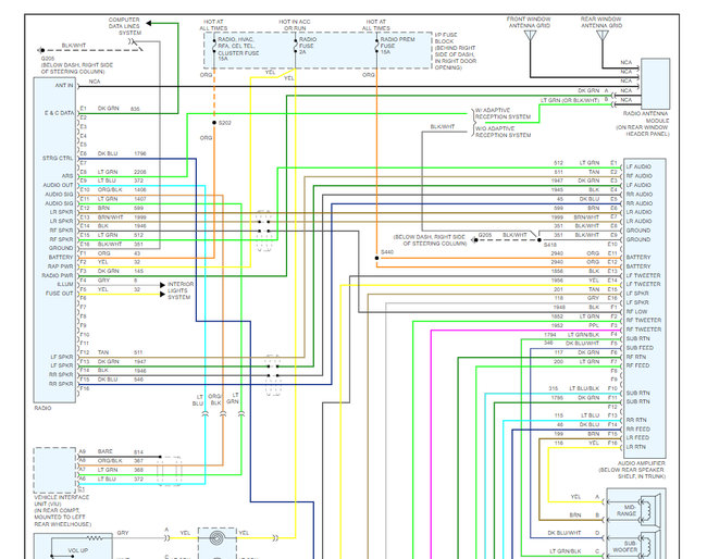

radio wiring diagrams please
2001 BUICK REGAL
120,000 MILES • 3.8L • V6 • 2WD • AUTOMATIC
MECHANICALGENIUS
  • 26 POSTS
I know how to repair odometer and shift indicator display. However none of the gauges including tach and speedo work, Some diagrams would help. Would like pin diagram for instrument cluster plug and possible diagram of printed circuit board, in case something is missing. Car is LS model. Everything else, except radio, seems to work ok. Oh yes, the turn signal indicator and the instrument panel lighting works ok. Currently looking for fuse.
Mar 26, 2021 at 1:15 PM
  • CAR REPAIR CONTRIBUTOR
  • 54,334 POSTS
here are the radio wiring diagrams and a guides to help you do some testing. please create another post to get the info on the instrument cluster there is only one subject per thread.
