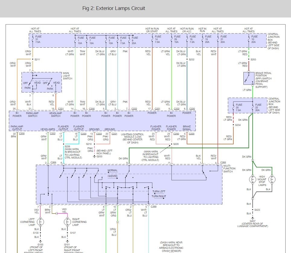

Intermittent turn signals, see loose wire
2000 LINCOLN TOWN CAR
100,000 MILES
2ALEGORIC
Intermittent signals, brake lights, chimes and door lock actions, Now what? I need a wire diagram to know where the wire goes for starters. Probably help uncovering to trace problem etc.
Jun 29, 2017 at 5:33 PM
  • CAR REPAIR CONTRIBUTOR
  • 54,354 POSTS

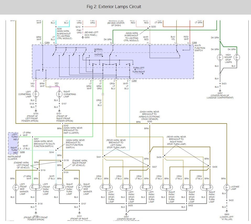

Here is some brake light wiring diagrams (below) and some guides to help you do some testing.
and
Please run some tests and get back to us we are interested to see what it is.
