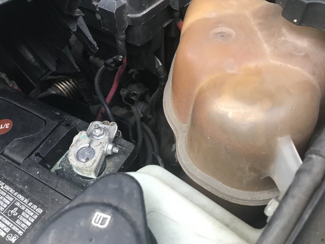

16.1 tells me you have a bad alternator. The regulator is no good. The voltage should be 14 to 14.5 volts only. Anything beyond that is no good for any of the modules.
As far as the wire, it does look like a ground but since you have no other issues, it may be nothing. you could run it to the body and see what happens but I doubt it will make any difference.

Roy,
Since this is a new alternator, is it possible that the ECM is telling the alternator to put out that much power?
Also, the wrapping around the wire and the length suggests that it goes into a wire bundle of some sort. Any idea which one?

Is there any harness around there at all? I cannot see from the picture.

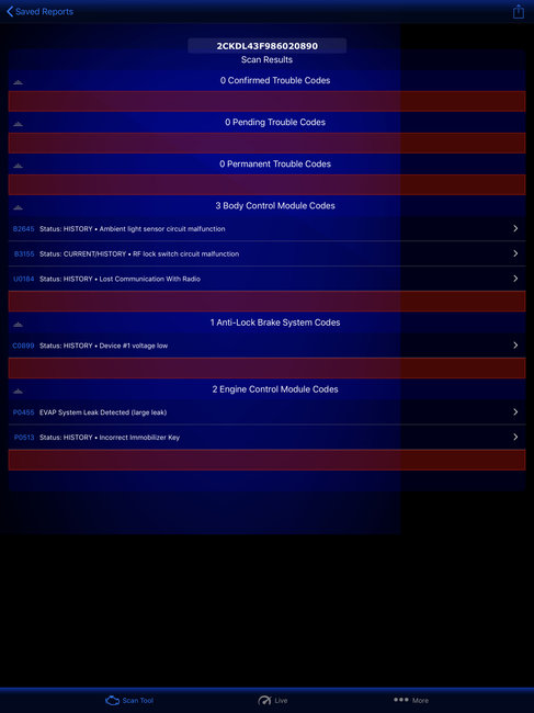

Attached a screen shot of my code scan.
Sep 24, 2018 at 3:03 PM
None of them are related to the transmission.
I cannot see the Body Control codes, too small.
Can you post the Body Control codes?
Sep 24, 2018 at 3:10 PM
VSSOUTLET
  • 57 POSTS
B2625, P0455, C0899. I do not think there is anything wrong with the transmission. Since the problem stopped when I replaced the transmission 2,500 or so miles ago, the problem must be electrical or with a computer.

It is B2645. Does not this collection of codes - especially given the high voltage output, suggest an electrical issue?
Sep 24, 2018 at 4:14 PM
No, it suggests you have issues with these systems.
B2645 is a possible BCM failure. That may be related to the issue you have since it controls all body functions.

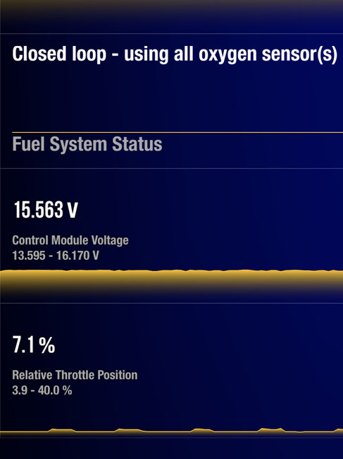

Attached is a live readout of power output. As you can see, the range is 13.595 volts to 16.1 volts on a five mile drive around the neighborhood. Lights, radio and A/C were on. This reading is in sync with my meter readings at the alternator itself. AC output was present, but very low. It fluctuated between 1/4 and 1/2 a volt.
Does this mean that a new alternator with less than 3,000 miles on it has a bad regulator or could it be that the ECM is commanding that much output? Until the voltage output issue is diagnosed, I think every other code is suspect.
Given this new data, what do you think?
Sep 24, 2018 at 5:46 PM
You need a new alternator. There should be 0 AC volts. You have a bad alternator.

I am still concerned about that wire that hangs off the negative terminal of the battery. It must go somewhere and it is not long enough to attach to anything except the wiring bundle directly behind it. I flushed all of the codes out of the computer. Let's see what else shows up over the next day or so.

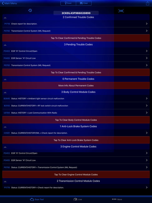

I install a new alternator - magic. The problem stops for a considerable number of miles - probably 3,000 and then it starts up again. Test the alternator and it is throwing out over 16 volts, so bad voltage regulator, right? Replaced the alternator again. Now all heck is really breaking loose. I am getting the following codes:
P1719
P0700
P0403
P0405
B2645
B3155
C0561
P1779

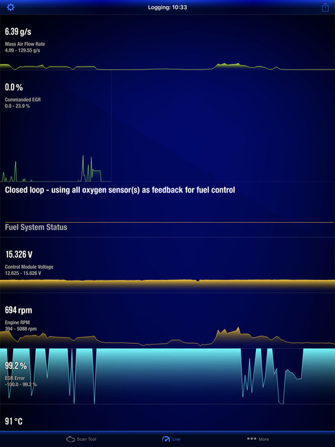

In addition to the transmission slips, it seems like the engine is revving too high. When I am at a light, it feels like my foot is lightly on the gas pedal. If I shift into neutral, RPM's briefly increase by 600 RPM's and then they go back to normal. When I shift into reverse, I can feel it wanting to bolt backwards and the car rumbles a bit.
I suspect that this is all electrical and related to one or two specific things. I am just stumped as to which ones.
I am getting about 15.5vdc on my Fluke at the battery. I am also attaching snapshots of the report and the live computer feed.
Help!

The first thing I would do is to check the voltage at the battery again. This time check for any AC voltage on your meter. If you have any AC voltage, the alternator is no good. The modules do not like AC voltage and do not know what to do with it when they see it and will set many codes and the system will act very strange.
The PCM does turn the field control on and off on the alternator and that needs to be checked as well. See if your scan tool can see the command on the alternator.

Car applying too much power to forward gears - when I take it out of gear and put it in park, the rpm's "surge" briefly to about 2100 before returning to normal.
I cleared the codes to get a fresh set of readings. The last batch of codes that I posted here were present before I cleared them.
Does this mix of symptoms sound more like a bad EGR valve or a bad ECM?
Oct 4, 2018 at 11:25 AM
Do you have any codes?
Do you have a scan tool to see what the command is for the idle air control or the EGR valve?
