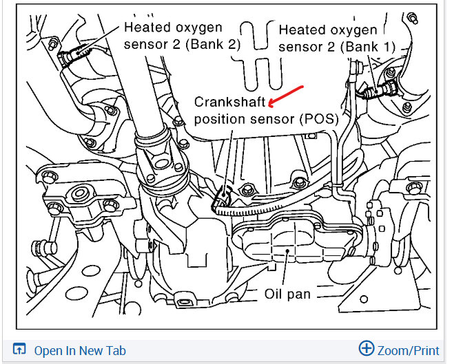

Oh man!, You are right, the engine is having a hard time starting, and then the hard spot is not normal, to me it seems like the crankshaft angle sensor is going out, do me a favor and when the engine start normally see if the tach moves, I noticed it does not in the video. When this sensor goes out it can cause no or erratic spark which will cause the ginch in the cranking. I know "ginch" is not a word technically, but it what we called it in the shop. Here is the location of the sensor. You might want to try running the codes and also, after this episode and the engine does start is there black smoke coming from the exhaust pipe at start up?
FYI, if the crankshaft sensor is bad it may not leave a code but if there are codes stored, we should know. Check out the images (below). Let us know how it goes.
