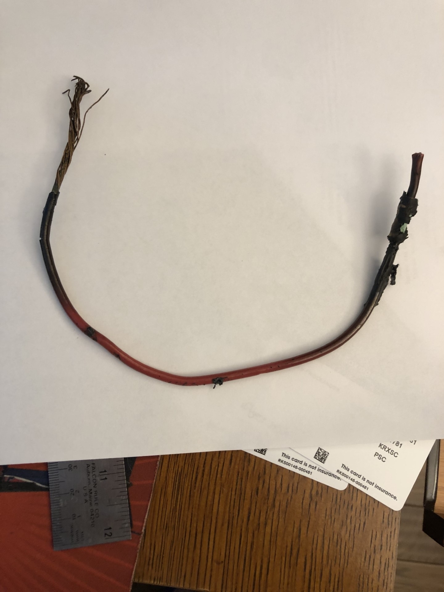

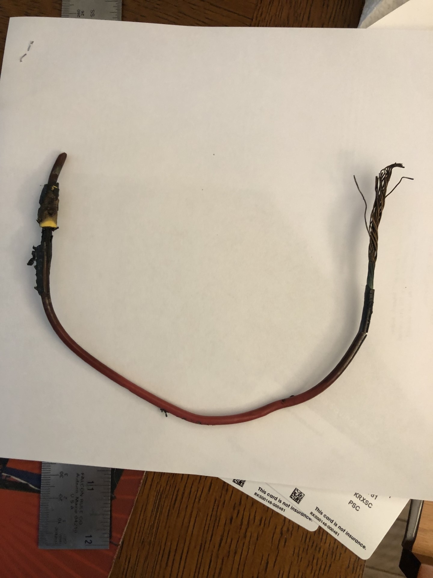

I have already cut out the bad portion of this wire and replaced it and threw away the bad before being able to take a picture. I believe this is called the exciter wire, but the same failure is still happening. I have inspected battery cables and connectors, and all are good. I did notice that when checking the voltage of the "S" trigger wire in the start position there is only 5.4 volts, and I replaced the neutral safety switch. I am still only getting a click when trying to key start, but successful start when jump the solenoid. I am trying to research now where the voltage drop is occurring.
Saturday, August 26th, 2023 AT 5:43 AM
STEVE FRIEDLANDER
  • 8 POSTS
I found the wire I cut and replaced. Images below, one of top-side of wire and the other the bottom side.

I would test through the ignition switch to see where you are losing the voltage. You should have 12 volts at the purple wire when in the crank position.

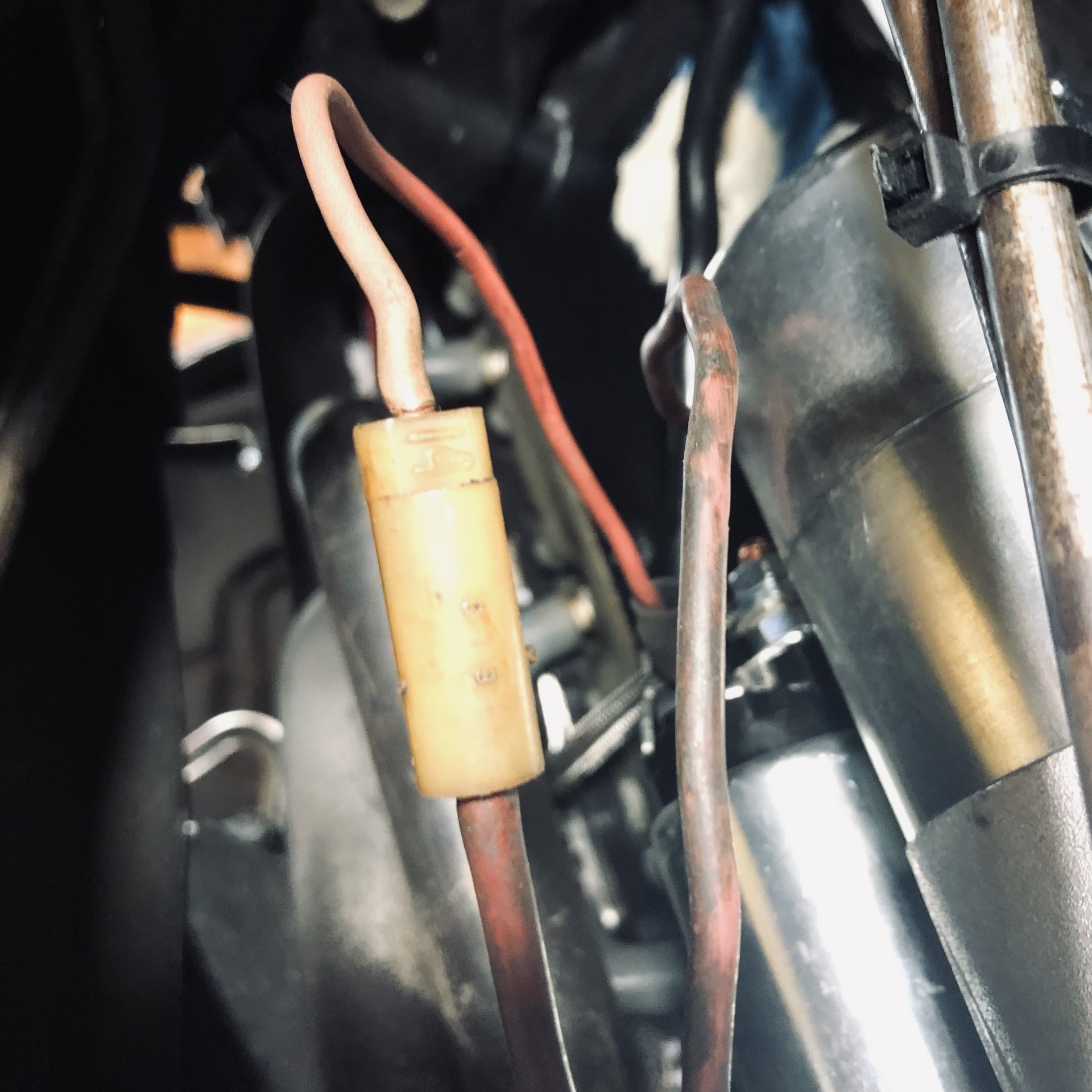

Messing with the wires at the starter trying to get them further away from header, and now truck will not start even with jumping the solenoid via remote start switch. The red wire that goes on the post with the positive battery cable I assume is the exciter wire and has an elongated white component in line close to where it connects on starter post. I assume (again) that this is either a diode or fusible link? Maybe this component has a short? Do you know if this wire can be purchased anywhere for replacement? I am trying to get around replacing the ignition switch because I really don't want to drop the steering column and not knowing otherwise how to eliminate possible problem places. Steve.

It sounds like you found the problem, yes you can get the fusible link from the autoparts store and then splice it in. You can use this guide to see if the ignition switch is getting power after the fusible link is replaced.

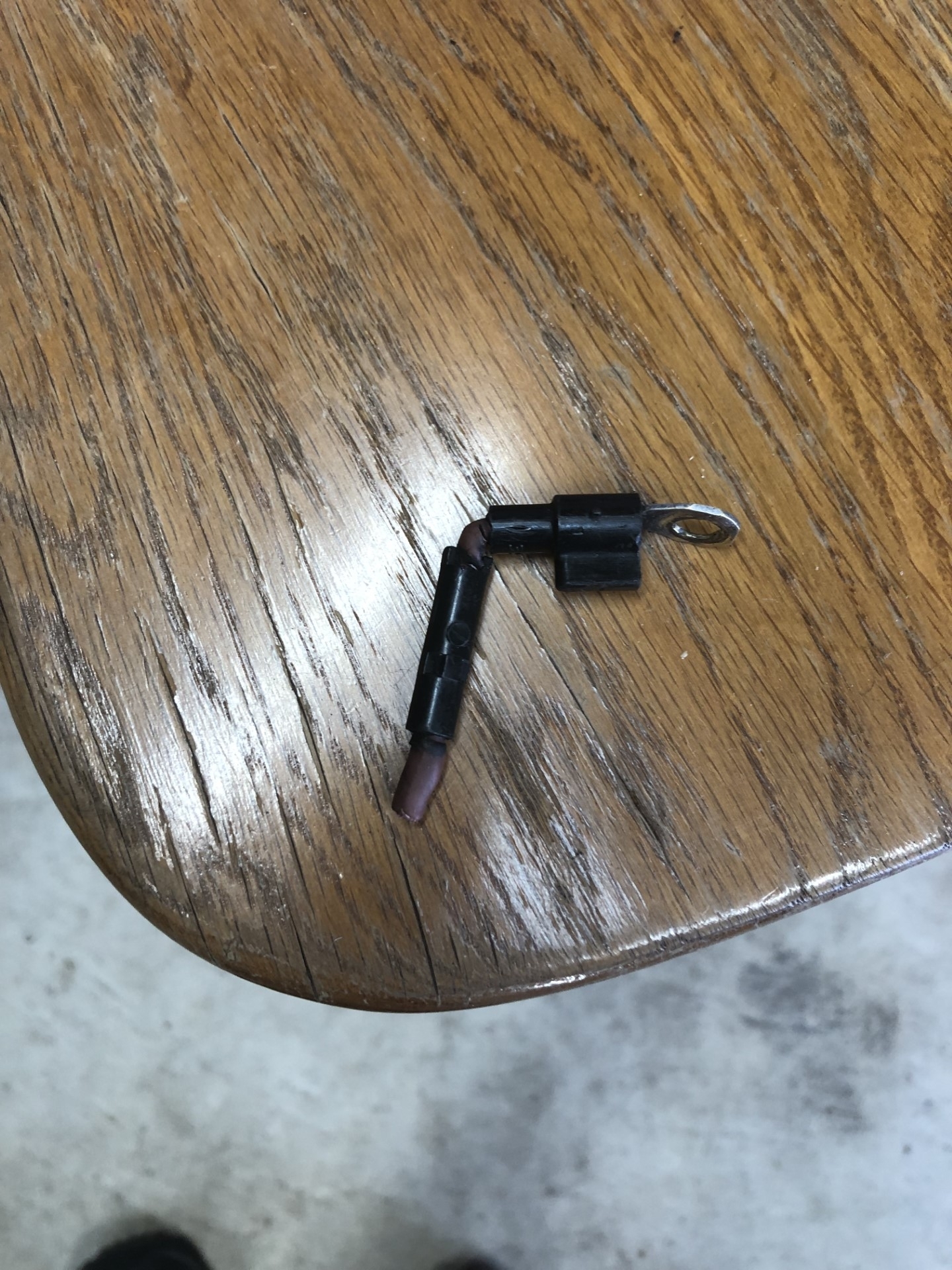

I am attaching a picture of the factory wire that connects to the power lug on the solenoid along with the positive battery cable. In reference to the white-ish component in line here, with "14" marked on it; can you tell me if that is a fusible link, or diode, resister or something else? The other end of this wire is attached to a lug on the back side of the alternator. While at it the second picture is the end of the wire that connects to the small (trigger) lug on the solenoid; is there anything special about the end of this wire? I thought I'd put another connector in its place. I'm getting out of my league here. Thank you.

You are doing good, there is nothing special about the electrical connector, you can just replace it.
