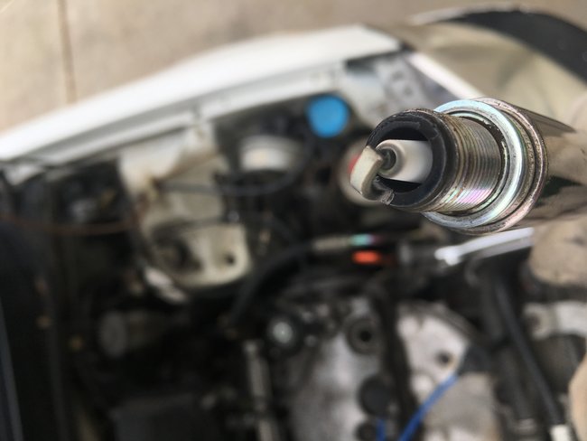

Spark plugs are the NGK ZFR5F-11. I just drove it around and got a cylinder 1 misfire code. I pulled the #1 plug out and took and picture. What do you think?
Monday, April 15th, 2019 AT 10:29 AM
KEN L
  • MASTER CERTIFIED MECHANIC
  • 55,522 POSTS
Looks lean. What do the others look like? if they are darker I would check for vacuum leaks and if none are found replace the injector. Here are two guide to help:
and
https://www.2carpros.com/articles/how-to-replace-a-fuel-injector
Tuesday, April 16th, 2019 AT 11:14 AM
J-D
  • 10 POSTS
The other plugs look similar.I adjusted the valves cause I was thinking maybe they were off a little bit but no help. I will use the carb cleaner and do some spraying. Already replaced the injectors. The engine idles fine but the misfire occurs under acceleration.
