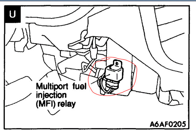

Hello, the vehicle does experience hard starting sometimes, the engine will keep on cranking but it won't start while sometimes it would start with easily. I checked for fuel supply, it was okay. The ignition coils were sparking. when I checked the fuel injectors wires it was not pulsing (no power source). Does that mean that the PCM is faulty?
Sometimes the vehicle would start easily, at that time the injectors would be pulsing.

The ECM is in control of the fuel injection. Have you checked connections to make sure nothing is damaged, loose, or corroded? It's odd that it would work on and off as described.
Also, have you scanned the computer to determine if there are diagnostic trouble codes indicating where the problem is starting? If you haven't and the check engine light stays on when the engine is running, have that done. It may be very helpful.

It is the ECM that controls the fuel injection as you said. Is it not the ECM that controls the ignition spark? During the hard starting there's spark at the plugs and fuel injector were not pulsing.

Have you checked the MFI relay? See pic below. The MFI relay is located under the console side panel to the left of the radio.
