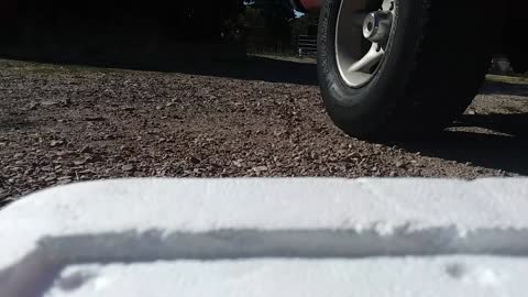

Now, as I stated it does not smoke all the time, so maybe it is not in burn mode?
Ugh, my brain.
Wednesday, August 29th, 2018 AT 3:02 PM
WALKINGTOOLBOX
  • 45 POSTS
White-ish, blue? I do not know.
Wednesday, August 29th, 2018 AT 4:43 PM
  • 52,797 POSTS
That is blue smoke. Most likely from the valve seals on the valves. The oil leaks down the valve guides and goes into the cylinder and burns off when you start the car.
