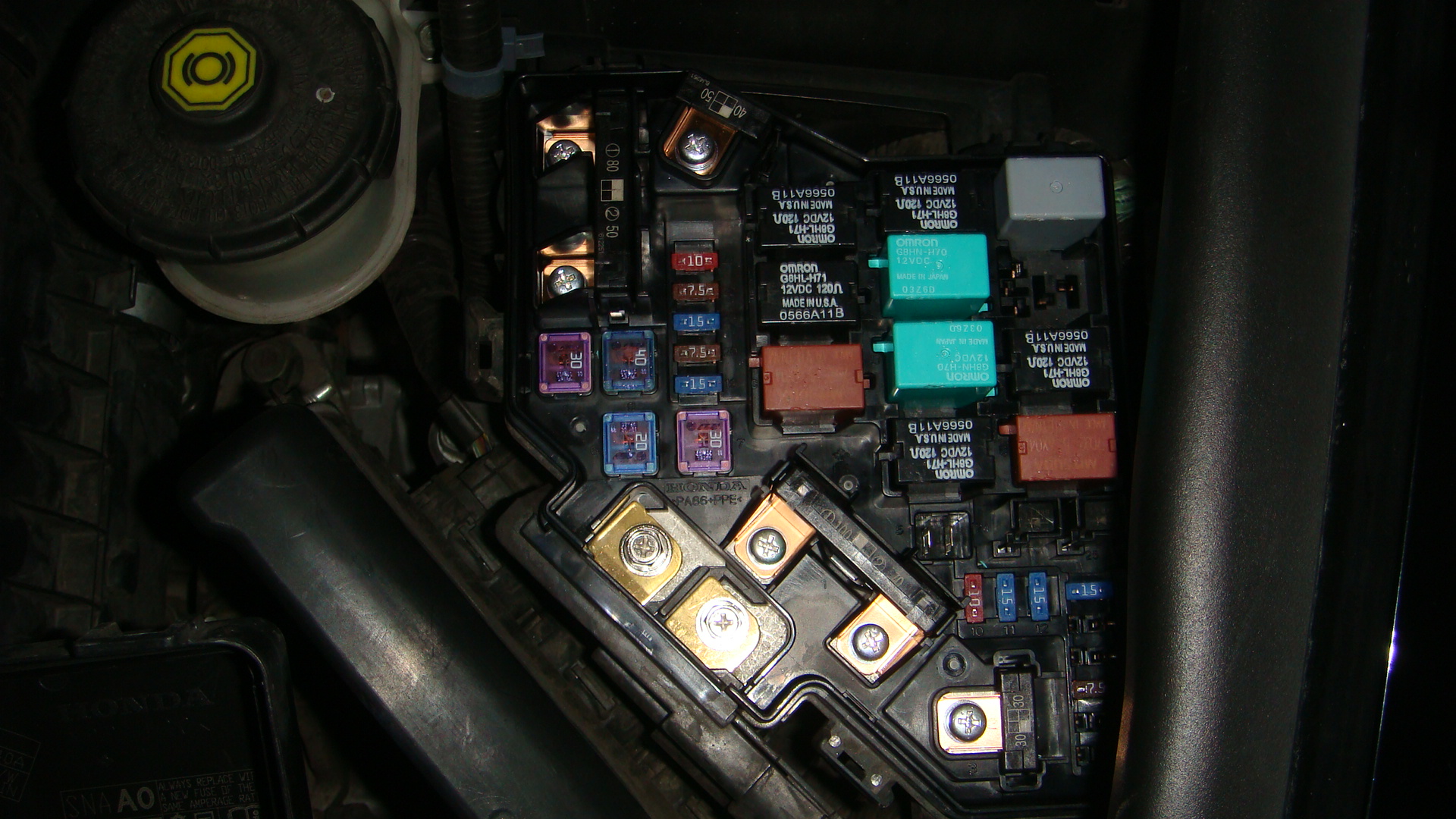

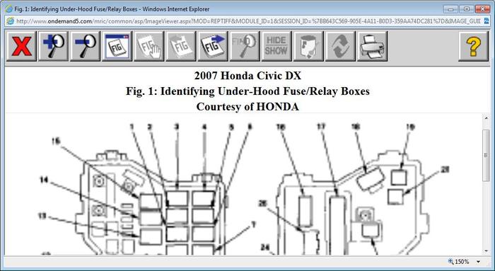

Center row, 2nd relay is the blower motor relay. Diagram seems to be very blurred so no point posting it.
Sunday, September 29th, 2019 AT 9:41 AM (Merged)
SATURNTECH9
  • 30,870 POSTS
Iposted the diagram anyways I know its blurry but you can still make out the numbers you need. The number is 2 for the blower fan relay and khlow2008 said to swap it with relay number 4.

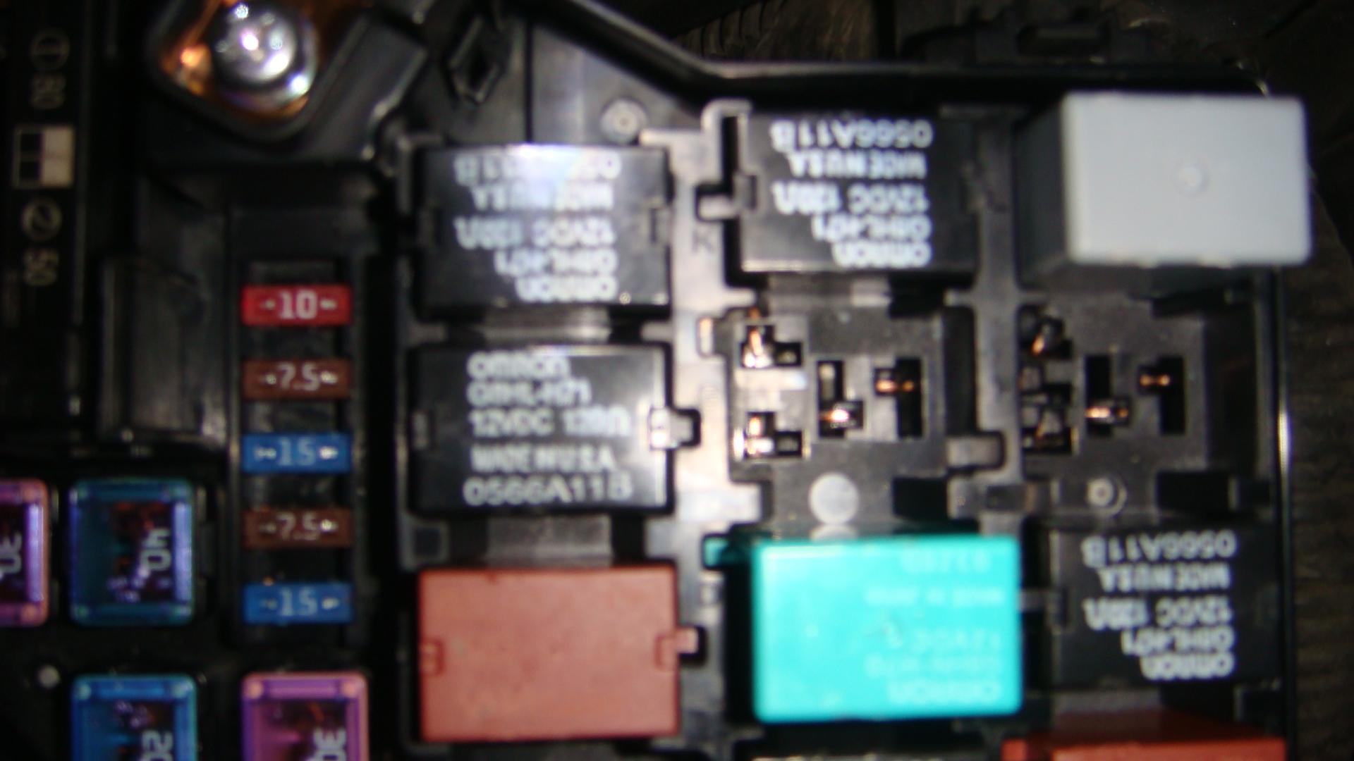

DEO
  • 12 POSTS
2 and 4 are different relays. 1 and 2 relays are the same and I swapped them out but no luck. Also, im not sure which ones are the relay terminals 1 and 2 to try to connect a fused jumper

KHLOW2008
  • 41,815 POSTS
The two terminals that are wider apart would be the terminals to connect.
DEO
  • 12 POSTS
The top left and bottom left terminals?
KHLOW2008
  • 41,815 POSTS
I can't see it clearly but they should be side by side. If you look at the relay pins you would understand. Ensure you have battery voltage at one terminal with ignition OFF.
DEO
  • 12 POSTS
Ok I jumpered the terminal on the right and the one in the middle and I got full voltage on the white wire at the blower with the ignition off.
