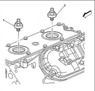

They are two different items. The knock sensor's job is to keep engine timing at it optimum position, just before you get valve ping. Here is a picture:

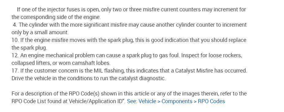

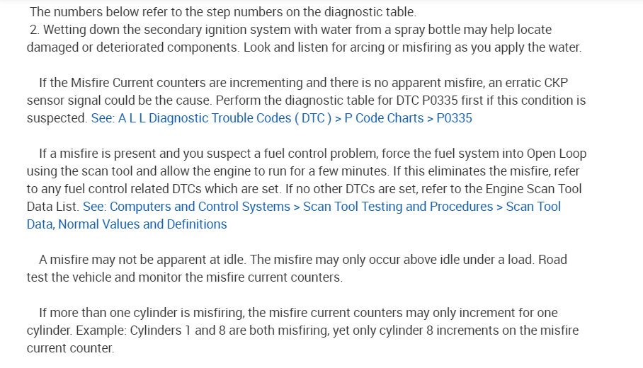

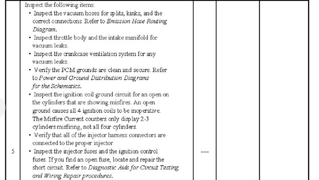

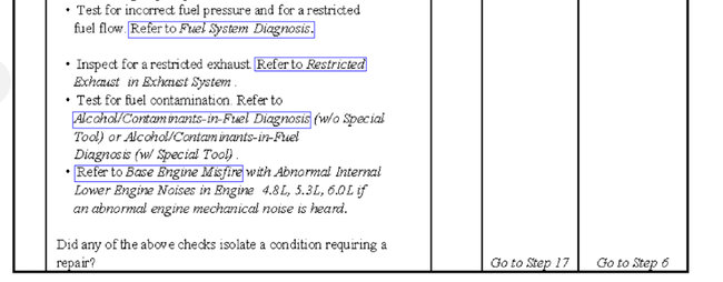

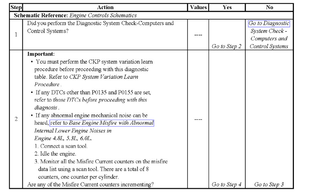

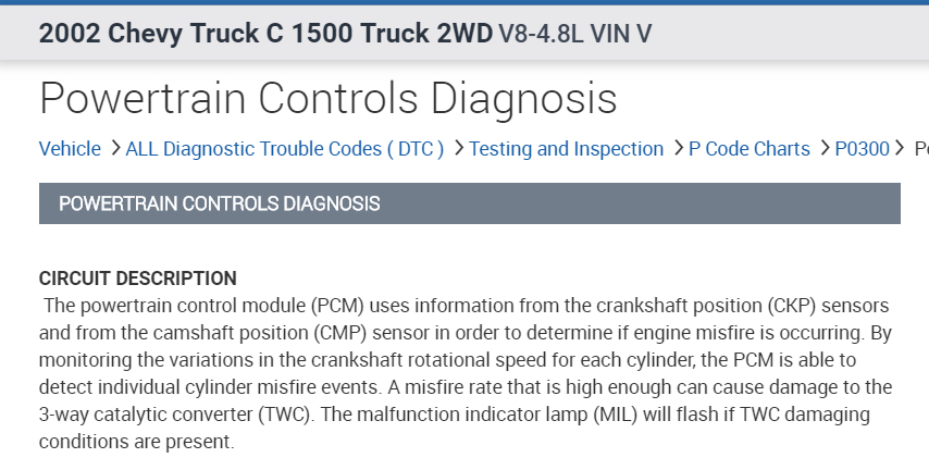

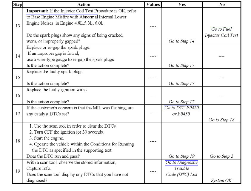

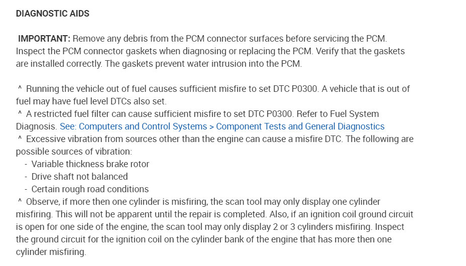

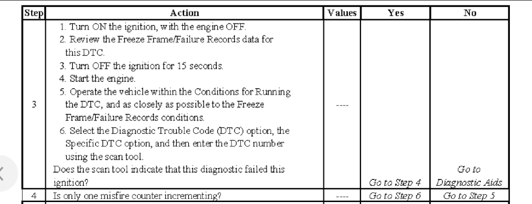

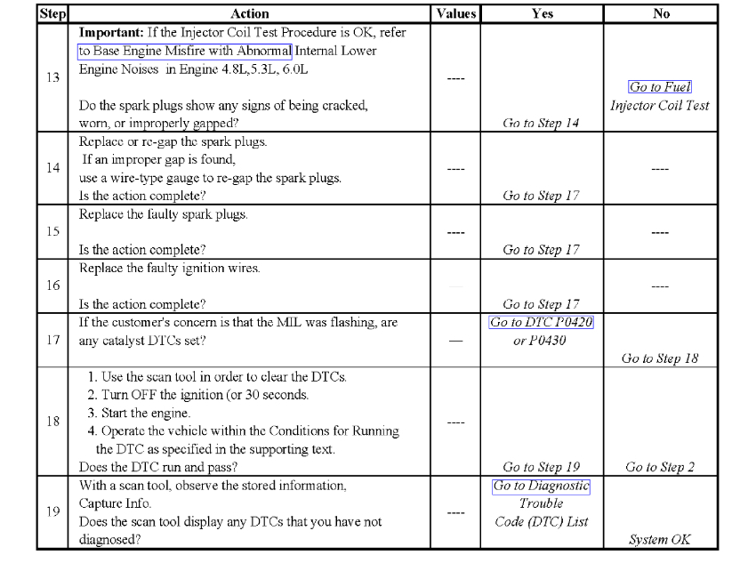

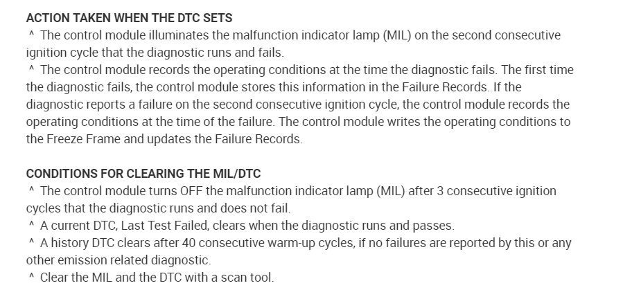

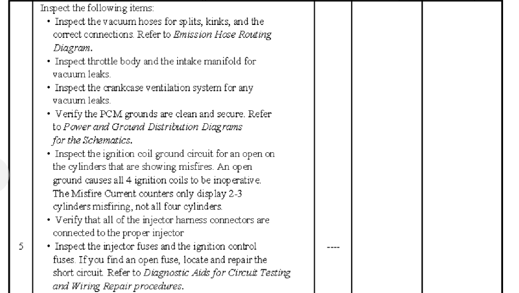

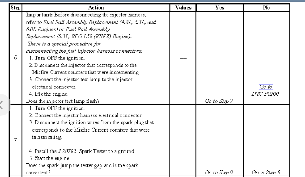

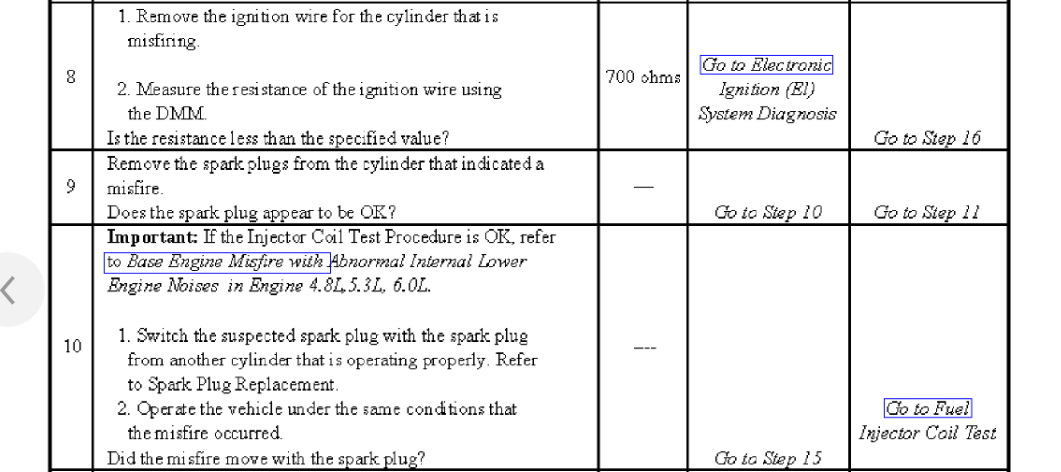

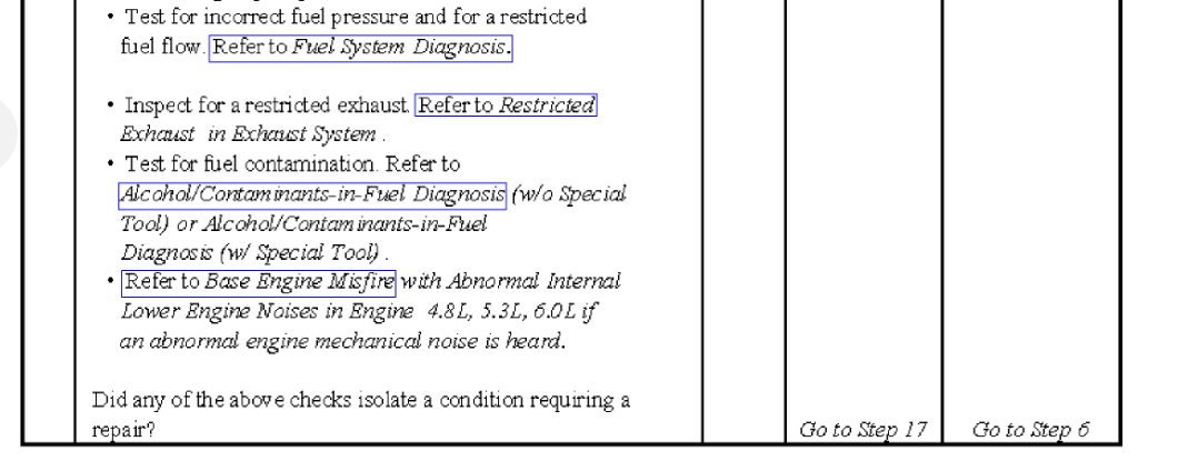

Direct Trouble Code (DTC) P0300 can be set by a variety of conditions. In the diagrams down below I have included the factory diagnostic troubleshooting guide for DTC P0300 for your vehicle. Please go through this guide and get back to us with what you are able to find out.
Thanks,
Alex
2CarPros
Thursday, May 6th, 2021 AT 1:00 PM (Merged)
