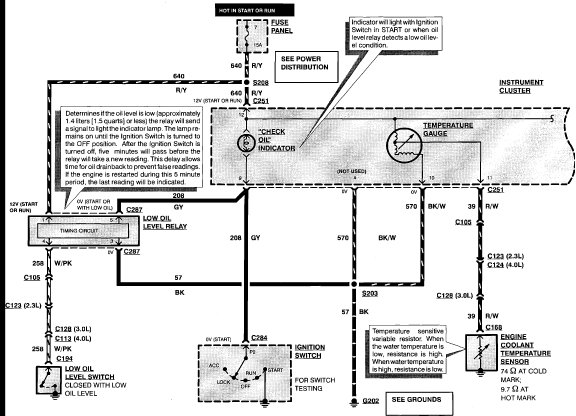

All of a sudden I have no instruments. (Speedometer okay)
Lighting is fine.
Checked all fuses, appear okay (did not ohm them).
Do not like the thought of disassembling and replacing the panel.
Also have 1996 and 2007 Rangers.
Tuesday, May 15th, 2018 AT 11:45 AM
  • 110,192 POSTS

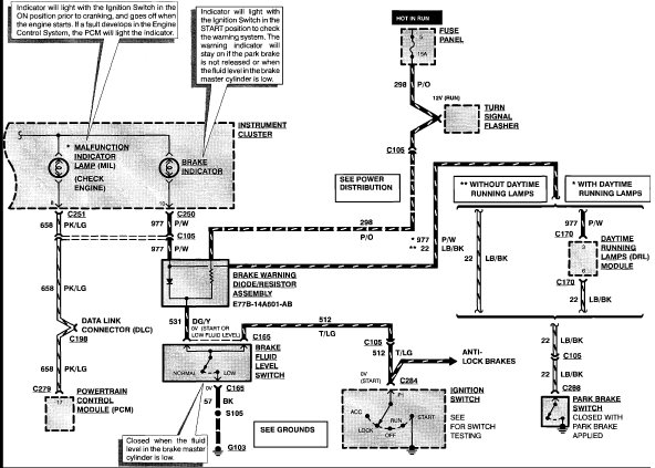

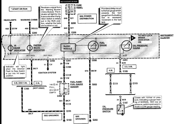

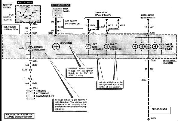

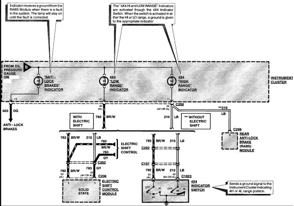

Hi and thanks for using 2CarPros. Com. Since this happened all at once, the first thing I would recommend checking is the ground. The ground in question is G202. Here is a list of ground locations. I have attached all schematics related to the instrument panel. Look closely and you will see most of the components ground at G202.
