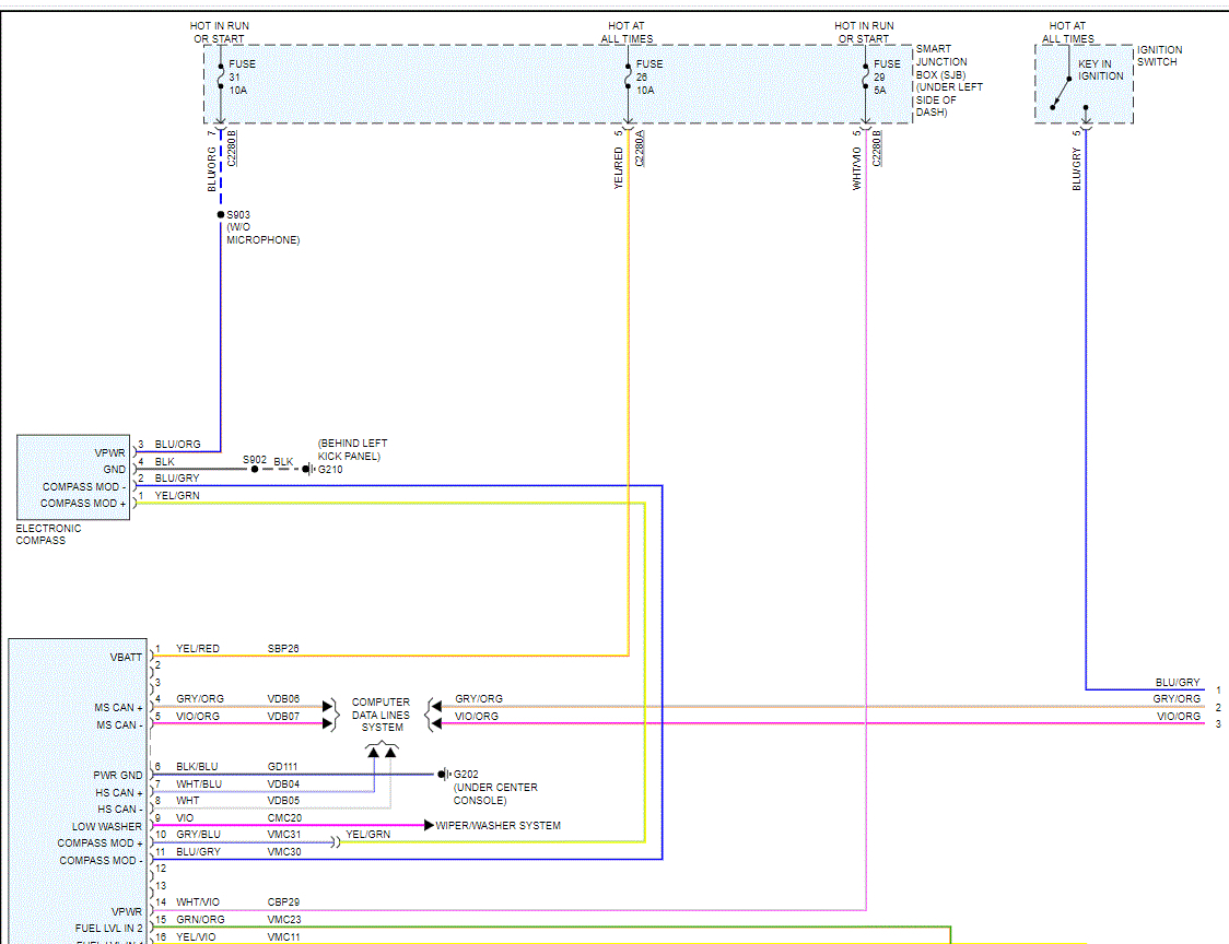

My instrument cluster works just not reading right and I have check everything. Help

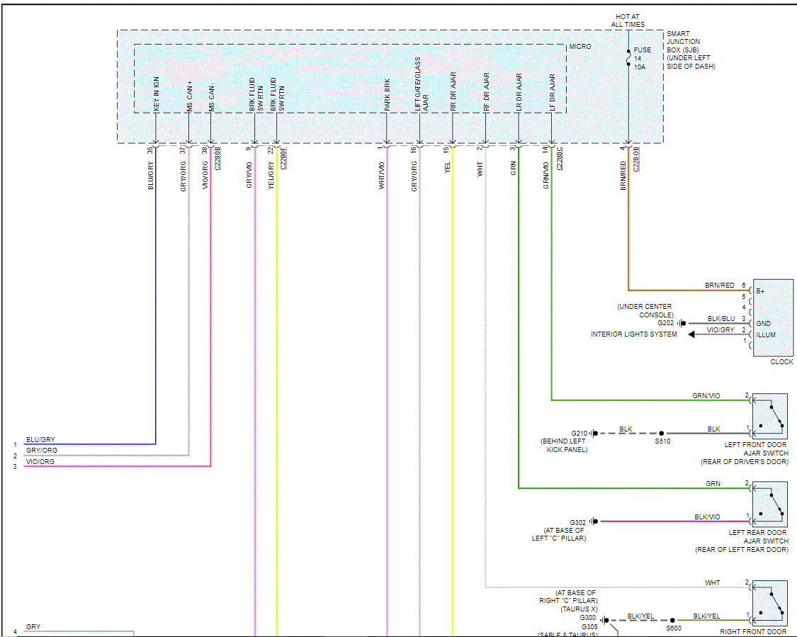

Could you let me know what is actually happening? For example, gauges are not working.
Let me know the specifics so I know where to start looking.

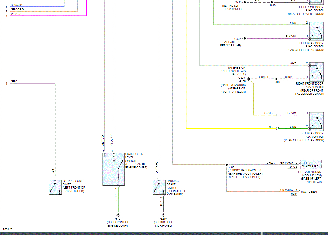

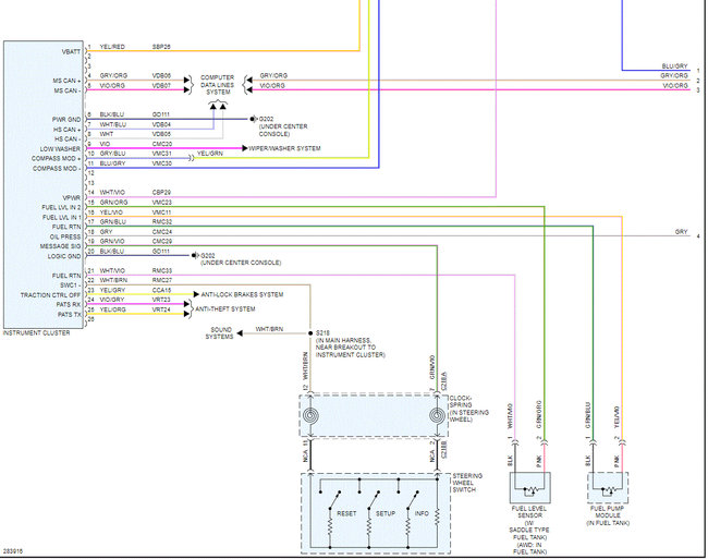

As a reference, I attached the wiring schematic for the instrument panel below. It was two pages long, but I had to cut them in half to make them readable. I did overlap them so you can follow from one to the next.
Additionally, here is a link you may find helpful when testing.
Monday, September 20th, 2021 AT 5:50 PM

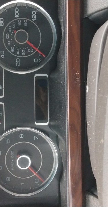

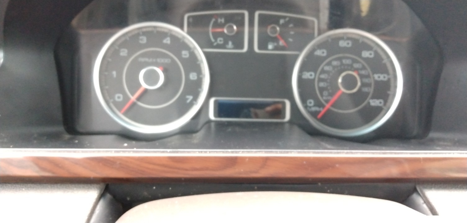

The gauges move they are just off by like 15 or so MPH. Here is a couple picture I took earlier today:
Monday, September 20th, 2021 AT 6:20 PM
  • 110,192 POSTS
Do you mean they are below 0?
Monday, September 20th, 2021 AT 6:39 PM
SCOOBY99
  • 12 POSTS
Yes.
Monday, September 20th, 2021 AT 6:50 PM
  • 110,192 POSTS
I did notice that. By any chance, do you have a live data scan tool? If so, can you compare the gauges with what is listed on the scan tool? The idea that both are down almost seems as though there is power going through in the wrong direction. However, that wouldn't be from a sensor because they work on different circuits. That makes me question the cluster itself or a bad ground using them as a ground path.

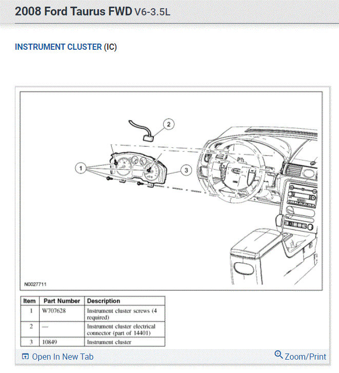

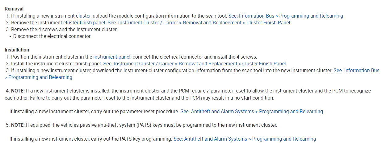

If we get to the point that the cluster needs removed, I attached the directions below. And yes, there is one connector at the top.
Let me know what you find or if you need help with anything.

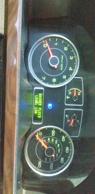

Well, I haven't done a code read yet, but my dad has a voltage meter tester. And I have noticed that when cut the car off the speedometer and RPM needle bounce a little bit. Do you think there is a way to find a factory service manual free downloadable?

Okay, thank you. Also this is what it does when it's started and what number is for the instrument cluster?
