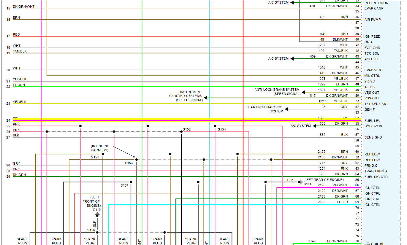

I was referring to the fact of the cluster staying on with the key off. What color wire should I be testing at the cluster for voltage to the fuel sensor? I can't find it on the schematic.
Friday, May 28th, 2021 AT 1:48 PM
  • 52,797 POSTS

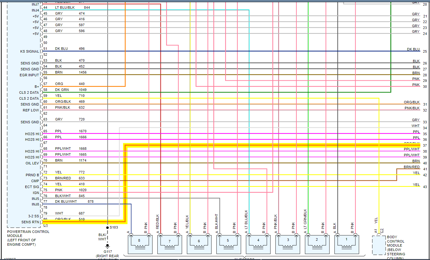

Okay, I sent another diagram for you. The 2 wires for the sender come from the ECM. I highlighted the wire. They are purple and orange/black. The purple is the sent voltage and the orange/black is the return. From there, it is sent by serial data line to the cluster.
Test those wires. The connector numbers are marked in the diagrams. The purple wire should have power back at the sender with the key on.
Friday, May 28th, 2021 AT 2:11 PM
SSROBERTSON
  • 80 POSTS
I checked and I'm not showing any voltage on the purple wire right at the ECM.
Friday, May 28th, 2021 AT 3:09 PM
  • 52,797 POSTS

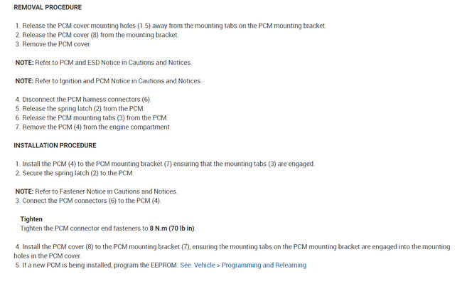

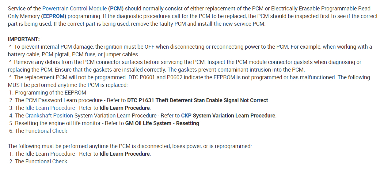

Okay, then you may have a bad ECM. I attached the procedure below.
Friday, May 28th, 2021 AT 3:57 PM

There is no fuse for this control and there is no overlay you can do to get it to work. Sorry, you need to replace it based on your results.

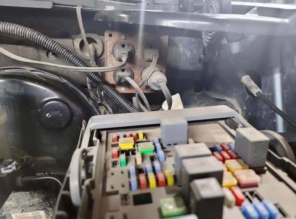

It's just something funny I wanted to send you since we have been dealing with wiring issues.
Monday, May 31st, 2021 AT 8:19 AM
  • 52,797 POSTS
Oh my goodness. What is that and how is it hooked up?
Monday, May 31st, 2021 AT 8:28 AM
SSROBERTSON
  • 80 POSTS
I'm not sure, it's just a picture I found online. It just feels like what I was doing with all the wires. Lol
Monday, May 31st, 2021 AT 8:30 AM
  • 52,797 POSTS
Is that what is under the hood of your truck? If not, why are you posting it? I do not understand.
Monday, May 31st, 2021 AT 8:32 AM
SSROBERTSON
  • 80 POSTS
It's not my truck. It was just something funny I seen on the internet and I wanted to send you for a laugh.
