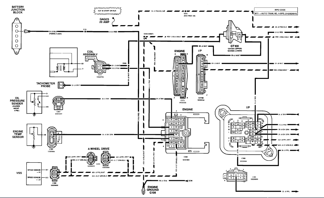

When I turn the ignition on the gas gauge goes down?
PAUL CORDOVA
  • 1991 CHEVROLET SILVERADO
  • 4WD
  • 190,000 MILES
When I turn the ignition off the gas gauge goes up and the speedometer goes up to about 20 MPH.

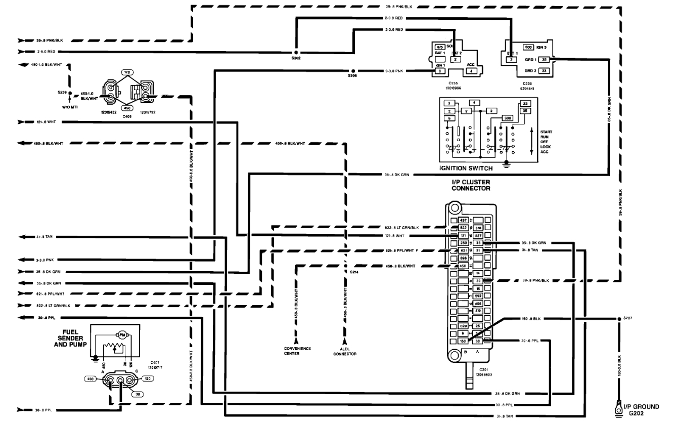

Yes, that is possible, here is the wiring diagram so you can see which wire is for ground, remove the connector from the cluster before you run the test by following this guide.
It is a blk/wt wire if is okay replace the cluster to fix the problem. Check out the images (below). Please let us know what happens.

I was told that it might be a ground wire issue, but I am having a very difficult time finding where the ground wire is and where it is grounded at. Assistance please.
Thursday, June 1st, 2023 AT 2:48 PM (Merged)
KEN L
  • MASTER CERTIFIED MECHANIC
  • 55,499 POSTS
The ground is behind the instrument cluster on the main bulkhead.

Ken, could you please be a bit more specific with where the ground is for the cluster?
Friday, June 2nd, 2023 AT 9:19 AM
KEN L
  • 55,499 POSTS
Yes, the ground completes the circuit for the instruments inside the cluster. Check out the wiring diagrams in the post above.
Saturday, June 3rd, 2023 AT 9:28 AM
PAUL CORDOVA
  • 11 POSTS
Ken.I understand that, but I can't find where the ground is. Tried tracking it from behind the cluster but I cant find where it goes to. I can see where the ground is and where it goes on the diagram, but I can't find where it actually is on the truck

They don't give the ground locations exactly. You can test the ground by using this guide:
Please go over this guide and get back to us.
Tuesday, June 6th, 2023 AT 7:40 AM
PAUL CORDOVA
  • 11 POSTS
Sorry to bother you Ken, but I am completely naive as to how to go about testing the ground. I looked at the link you sent and I still don't understand. Could you please break it down more simply for me. I'd sure appreciate it
Wednesday, June 7th, 2023 AT 6:16 AM
KEN L
  • 55,499 POSTS
Sure, if you attach the test light to the positive side of the battery it now tests ground circuits. You will need a test light with a long lead or just make an extension from extra wire. Use the wiring diagrams above to see which wires go to ground which are the wires headed downward with the three little lines at the end. Let me know.
