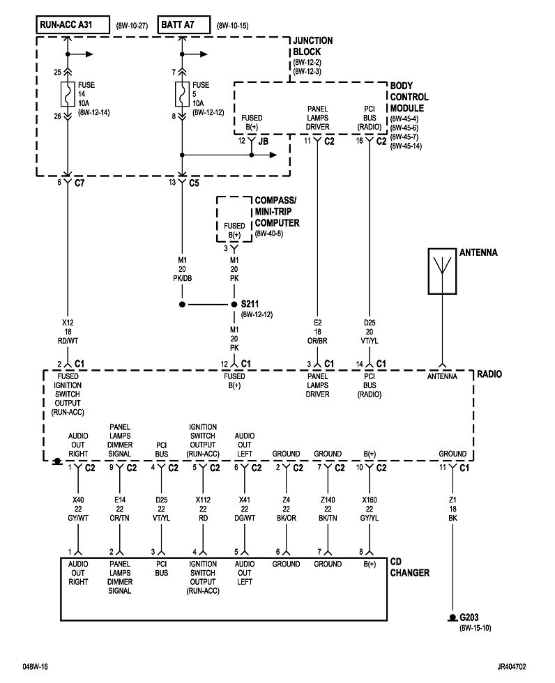

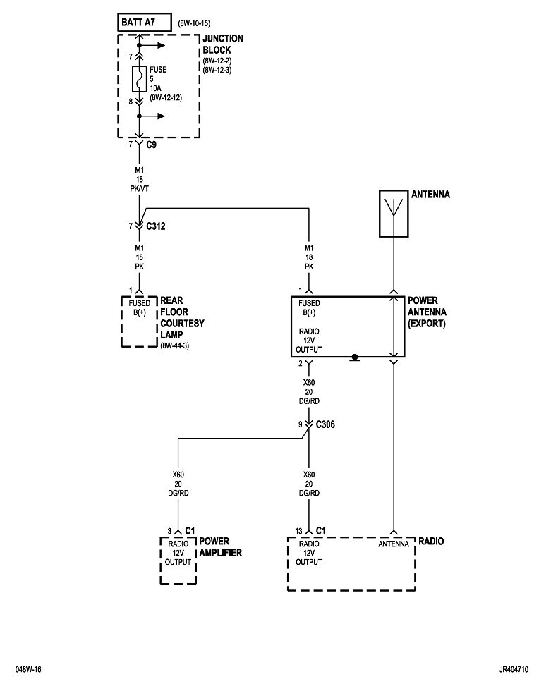

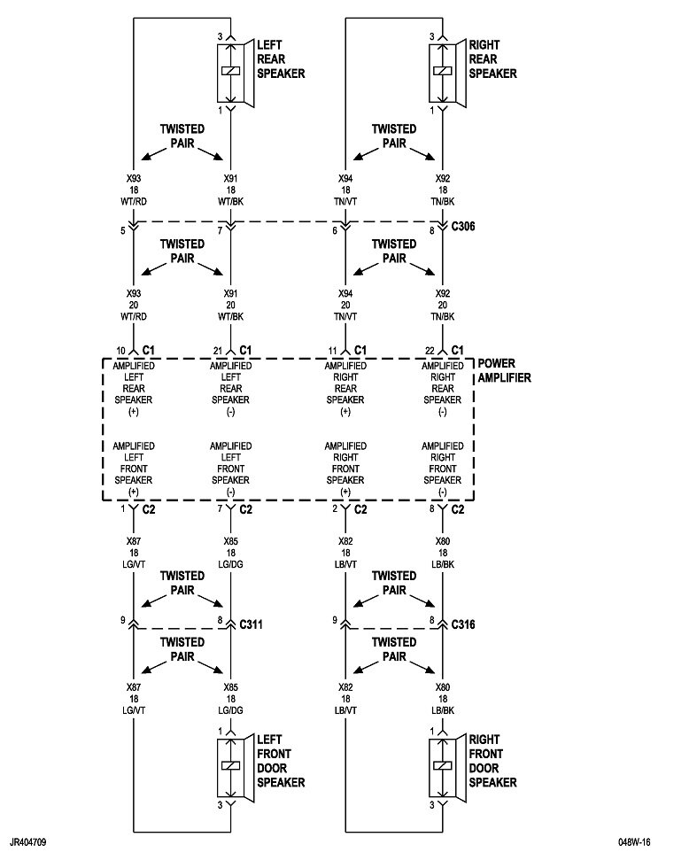

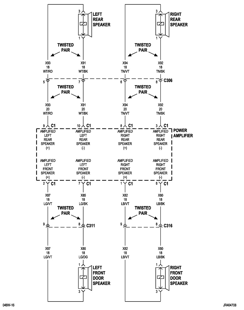

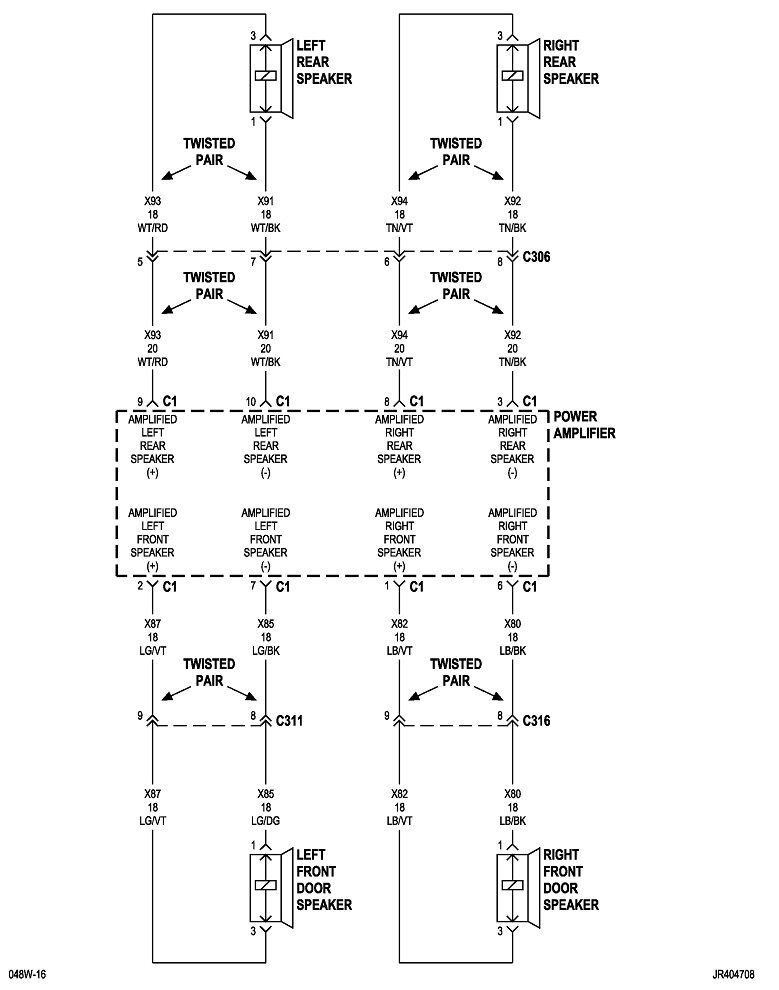

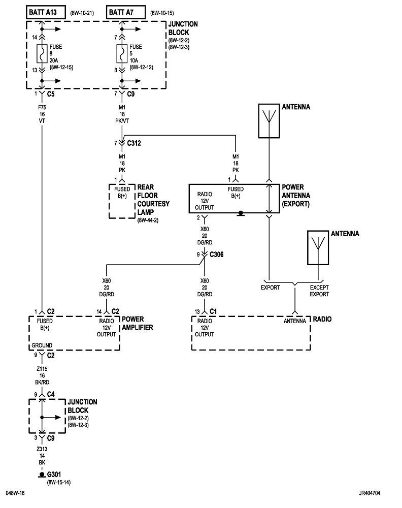

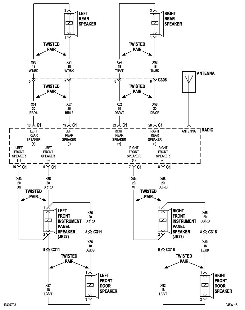

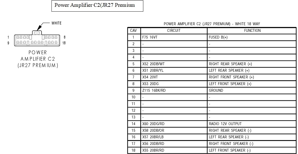

Actually, I am looking for a wiring diagram to install a P05091507AD (Chrysler) head to an Infinity 36670 main amp, and speakers 4 corners. These came out of 2004 Sebring, I believe. This Cavalier is a Z24 with 263,000 showing on the odometer, however, the engine, 5 speed transmission, drivetrain, front end, etc. has been rebuilt about 20,000 miles ago. (Original motor, etc.) No oil leaks, runs sweet. Picked it up at an auction. I think I stole it out from under the guy who did the rebuild, as it cost me 2 grand. And only one person was bidding against me for the last $1,200.00. I am thrilled - now it's turbo time.

Chrysler radios are my specialty, but a 2004 model is a bit too new for my expertise. Let me share what I know, then what I don't know.
With GM and Ford radios, when they are used with a remote amplifier, they must be used with that amplifier. When they don't use a remote amp, they can't be used with a remote amp. To say that a different way, the audio amplifier stage lives inside the radio itself, or it is a separate unit mounted somewhere else, but never both. The story is quite different with Chrysler radios. All Chrysler radios put out speaker-level output and can be used with a remote amp or without it. The amp does not add volume or power. It is only used for tone conditioning for the shape of the body. GM and Ford handle the different car and truck shapes with different radio model numbers that can look identical to each other.

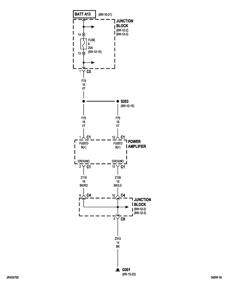

The 12 volts for either type of amp came from a relay that was turned on by the same wire leaving the radio that turned on the power antenna, when one was used. With a separate single amplifier, it has a very fat ground wire and a red 12-volt wire that was hot all the time. The smaller 12-volt wire from the relay was just the turn-on signal for the amp. In later years they did it the same way, but instead of the relay, turn-on circuitry was built into the amp.
Infinity radios put out less bass than the base radio. It is made up in the amplifier. If you run an Infinity radio without the amp, it will sound tinny unless you turn the bass control all the way up. Similarly, if you add an amp to a base radio, you'll have too much bass unless you turn it way down. Either system sounds pleasing when run with or without the amp, as it was designed. You might consider trying the radio without the amp first. Speakers in doors will sound different than if the same speaker is mounted on the rear shelf or in the dash. You might be happy without the amp.

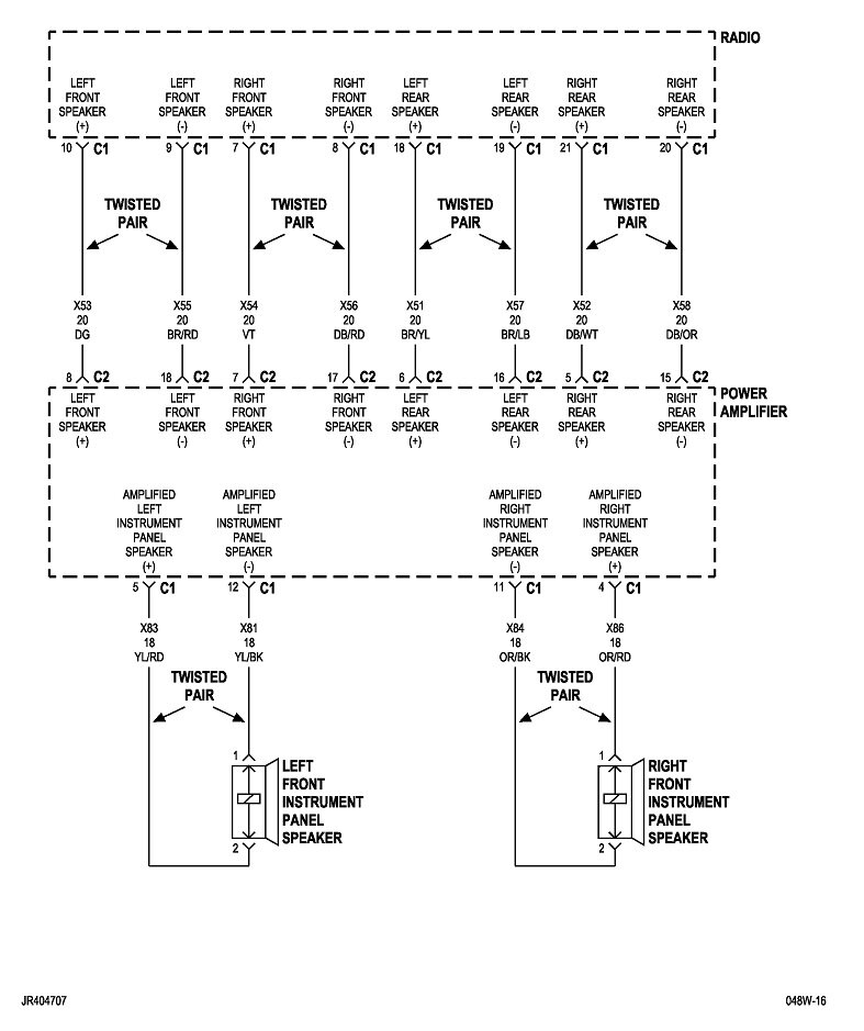

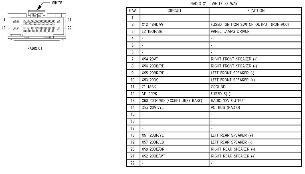

I didn't study these diagrams closely. It looks like the first ones might be for the no-amp version and the later ones are with an amp. There were no titles or headings for me to copy that would indicate the type of system.

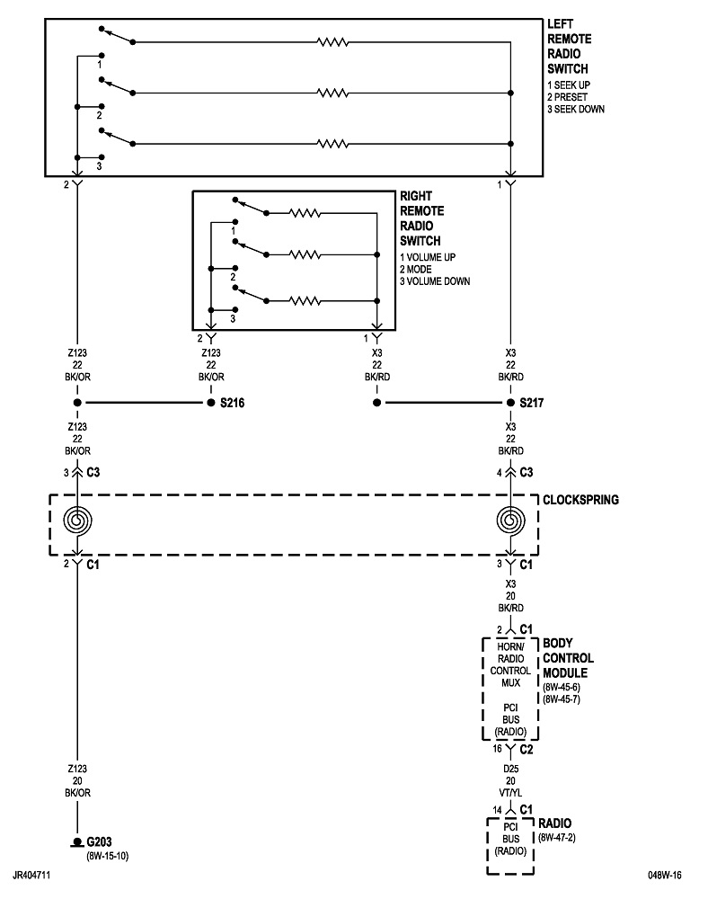

Now I'm going to share more than I know. When you see a reference to a "PCI Bus", that is a data line that connects all the modules on the vehicle together. In the '90s, that was a single-wire data bus that was not needed by the radio. It was in a two-pin connector and served two functions. If you had steering wheel controls, those functions were sent through the Body Computer out on the bus for all the computers to see, but only the radio cared about those signals. All the other computers ignored them. The radio also received road speed from the Body Computer for the speed-sensitive volume system. I don't plug in anything to the PCI bus connector on my test bench. Those radios had two 12-volt feed wires. One was hot all the time for clock and station preset memory. The other was switched on by the ignition switch to turn the radio on.
By the mid 2000s, there was just one 12-volt feed and it was constant. When you turn on the ignition switch, you're just turning on the Body Computer. It sends out data pulses over the data bus to tell everyone else to turn on, including the radio. If that is the system you have, the radio will not turn on without the Body Computer in the system. Looking at the first diagram, I see there are indeed two 12-volt feeds, one constant from the battery and one switched from the ignition switch, so you may not have this problem with the Body Computer.

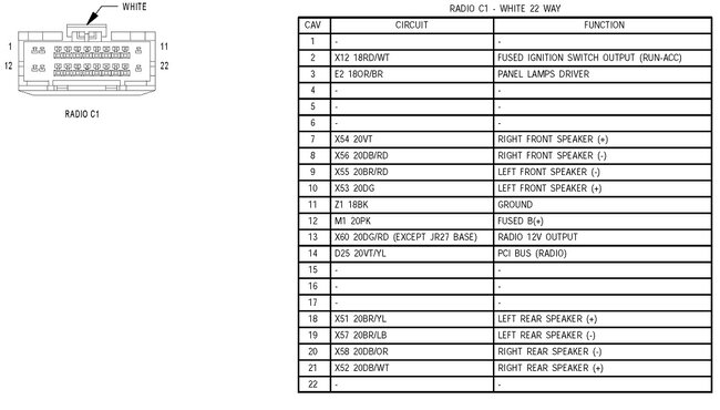

This is a good time to point out one potential source of frustration that's easily avoided. Chrysler wiring diagrams can be very confusing at first, but once you get used to them, they're fairly easy to follow, but you need to be aware of one shortcoming. Looking again at the first diagram, two thirds of the way down, the box labeled, "radio" shows a wire at the top left. The "C1" stands for "connector 1", and the "2" at the left is for wire number two in that connector. That part is easy. Right under that, they list that wire's function, in this case, "fused ignition switch output". In all tv and vcr service literature, that means that module or I.C. is producing the output and sending it somewhere. The engineers at Chrysler didn't understand that. Here it means the ignition switch produced the output, (12 volts), and sent it to the radio. This is exactly backward and can get you "wrapped around the axle" if you dwell on it too long. In this case, the designation means this is where something is coming from, not going to.

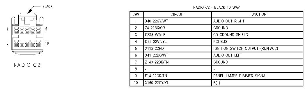

Connector C2 is only used if you add a remote CD changer.

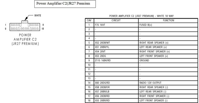

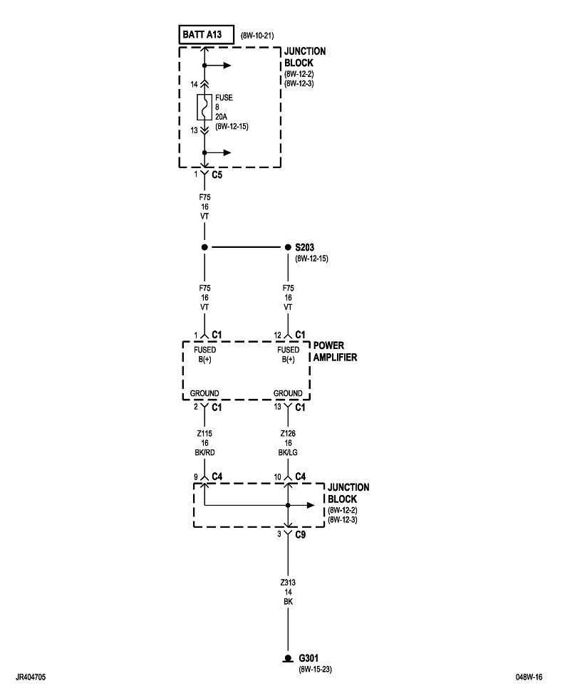

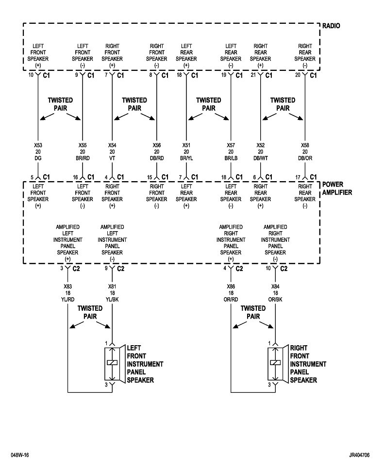

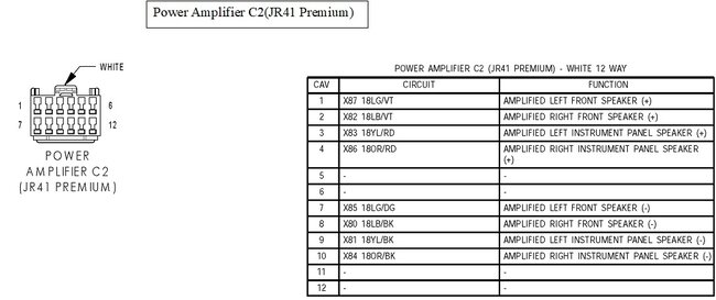

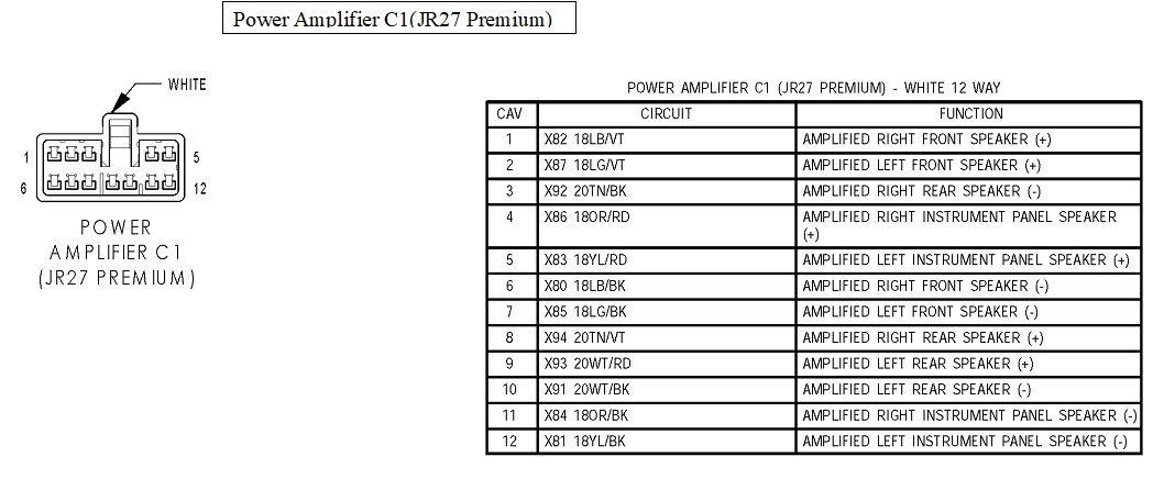

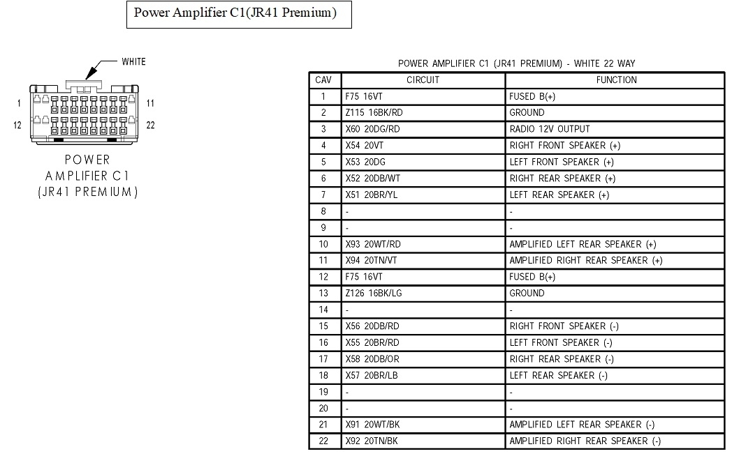

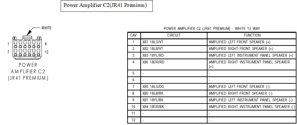

The last four images are for the amplifier plugs. You'll only use two of them. Some genius at Chrysler never figured out it would be confusing to give the name "Sebring" to three different models. One is an import, one is a convertible, and one, . . . isn't. As luck would have it, they had both versions shown in the literature, so I didn't have to ask which model you have. You'll need to look at the vehicle's VIN if you can't figure out from the wire colors in your connectors which one you have. The first two are for connectors C1 and C2 when you find "JR27" in the VIN. The last two are used if you have "JR41" in the VIN. If you don't have access to the donor vehicle, you have to go by the wire colors and locations.
By the way, for the wire designations, "X12 18 RD/WH" means it's circuit X12, an 18-gauge wire, and the insulation is red with a white stripe, or "tracer".

To run a 4 or 6-disc remote CD changer, the radio must have the numbers under the station preset switches, and C2 on the back for the cable. The numbers let you select a CD directly. Some radios only had the numbers 1 through 4. If you install a 6-disc player, you have to use the "Disc Up" or "Disc Down" switches to get to the fifth and sixth disc. Some radios have the numbers 1 through 6. If you have a four-disc changer, it will just ignore the fifth and sixth switches. I sell mostly 4-disc changers at the car show. The 6-disc are harder to come by.

If the diagrams are too small to read, copy and paste them into a typing program like MS Word. They show up very nice there, but you can expand them too. Please keep me updated on your progress. I'd like to know if you get this to work, and how it sounds.
