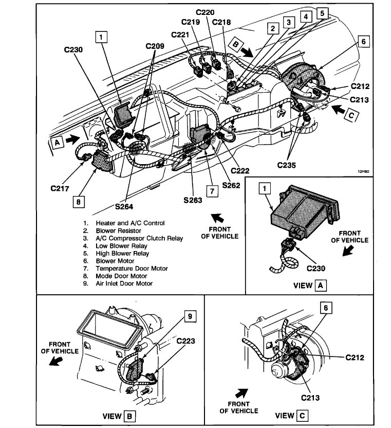

What is the easiest way to change the inlet air actuator?
THOMAS J JONAS
  • 1993 CHEVROLET SILVERADO
  • 5.7L
  • V8
  • 4WD
  • 232,000 MILES
Which is located on the fire wall on the passenger side of the truck. Do you have to pull off the whole dashboard to change it? I keep hearing a clicking noise around that area, do I have to pull out the HVAC system too? I changed the actuator that is in the front middle of the dash but I still have the same clicking noise. Thanks

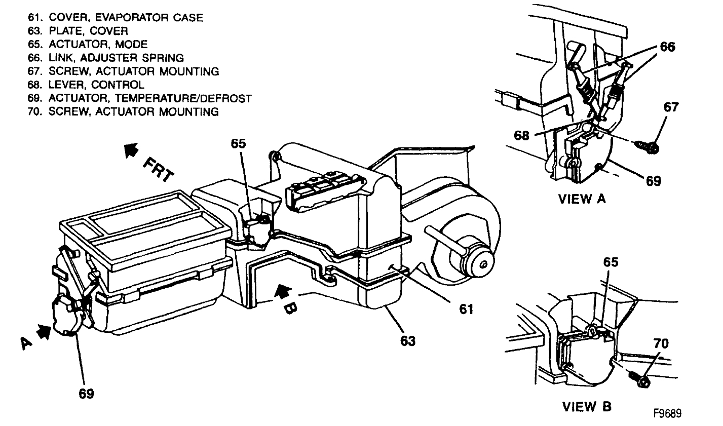

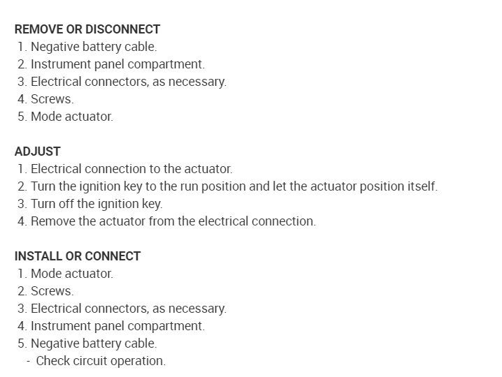

They can be difficult to change depending on which one needs to be replaced, when the clicking noise is occurring, see if you can feel which one is making the noise. You can remove the glovebox to help gain access and I have all of the actuator locations in the images below. Check out the images (below). Let us know what happens and please upload pictures or videos of the problem so we can see what's going on.

It's the actuator that's on the firewall of course how do you change this one without a lot of work? I don't feel anything on the other two actuators. Thanks
