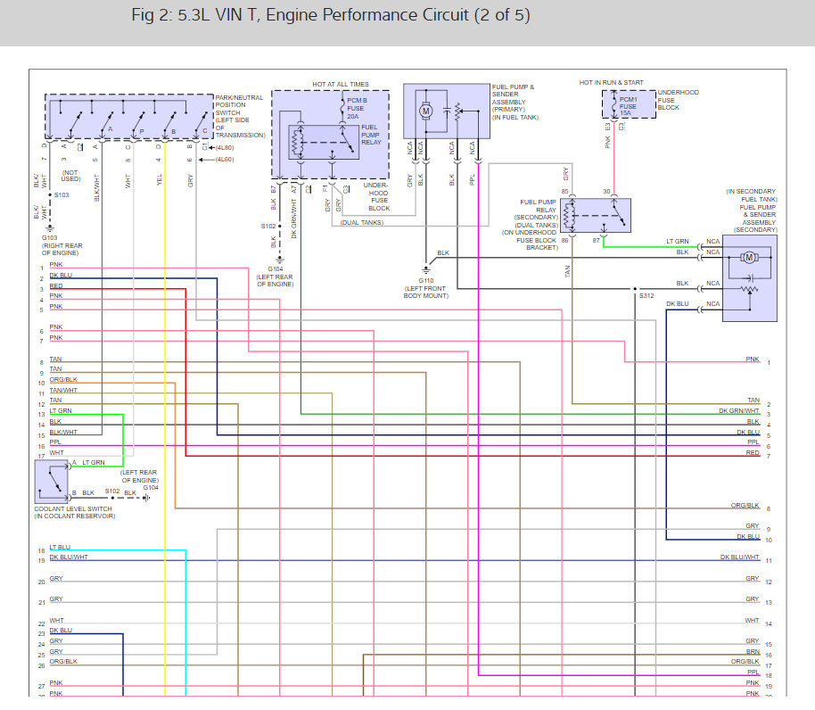

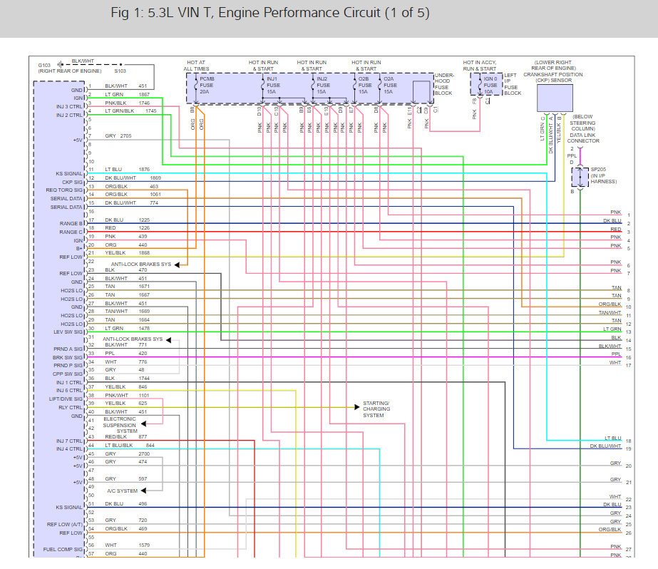

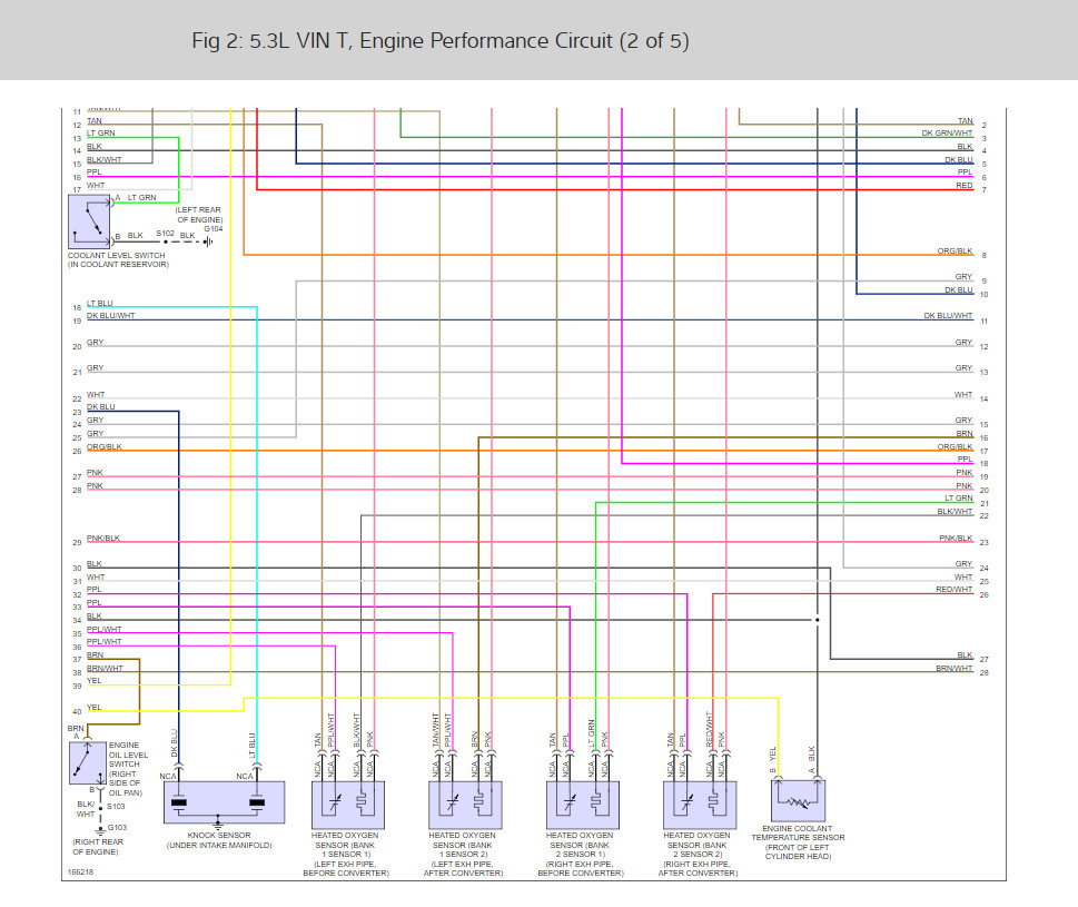

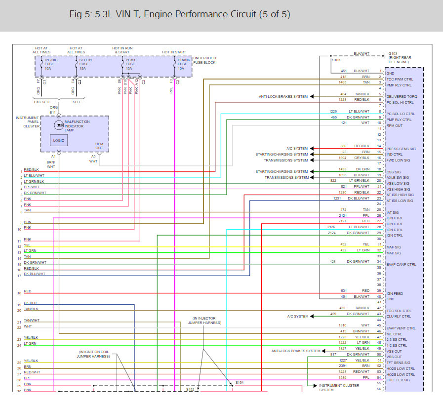

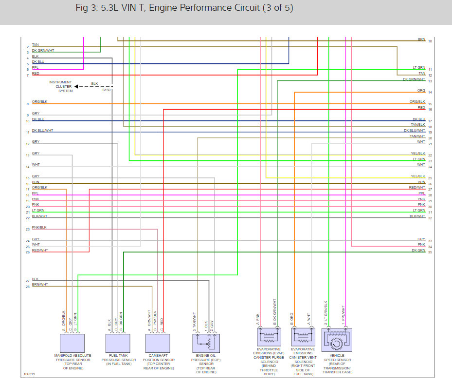

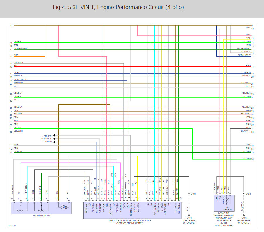

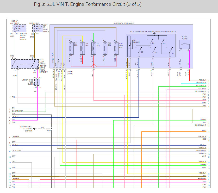

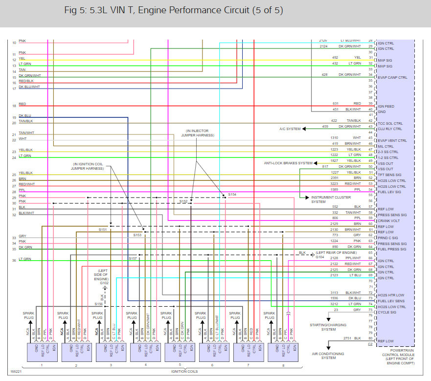

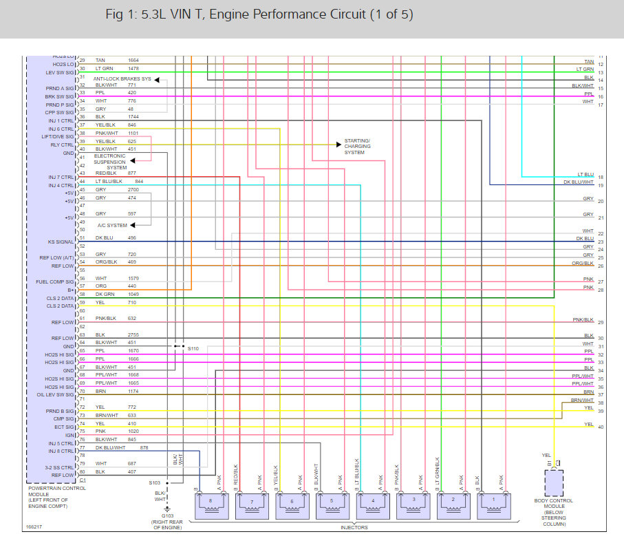

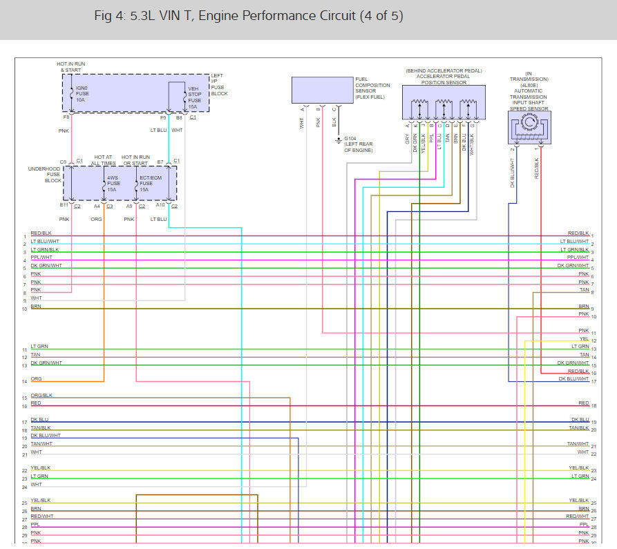

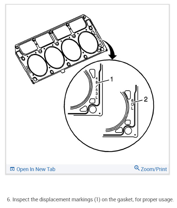

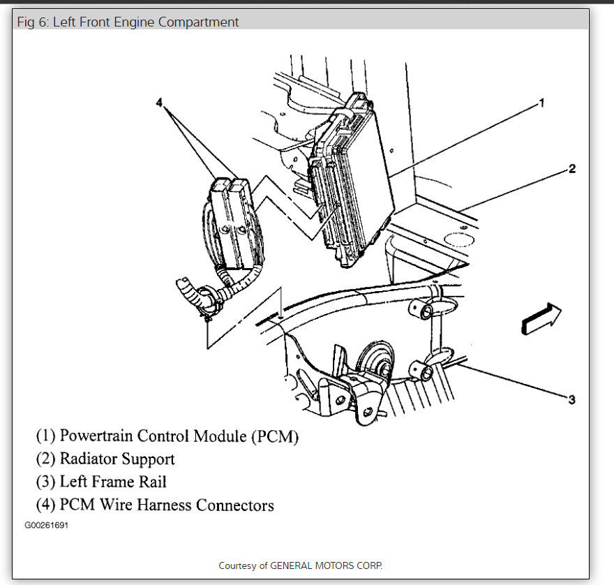

I couple things come to mind. These engines had a problem with the camshafts going flat. Can we remove the valve covers and do an Inspection on the lobes, use a flashlight? If they seem okay I would do a pin to pin the make sure there is no high resistance to any injector/ignition coil. Here are the engine wiring diagrams and guide to help:
If all okay swap the PCM out for a used/rebuilt unit to see what happens.
Check out the diagrams (below). Please let us know what you find.

Ken, I am new to this. What am I looking for when I take off the valve covers? Do I remove rocker or anything? Where do I look with flashlight?
I have checked the injector outputs with a NOID tester. But have not measure pin to pin on connector. On the coil connector I did measure pin to pin and all of the signal or igniter violates on bank 1 are the same. I think they all were around 3 volts. I will find my information and share.

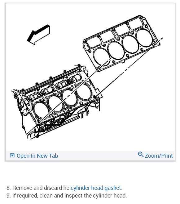

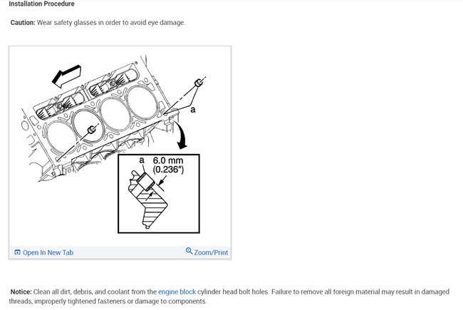

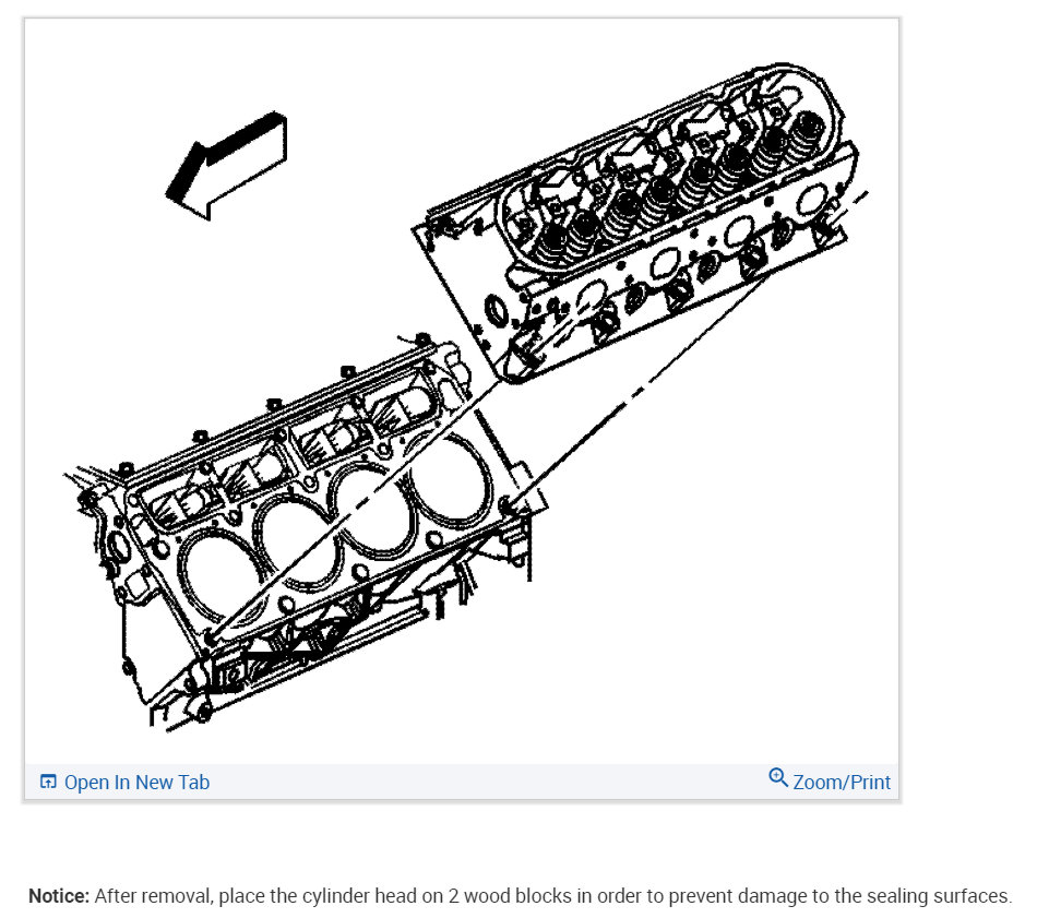

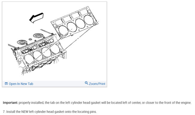

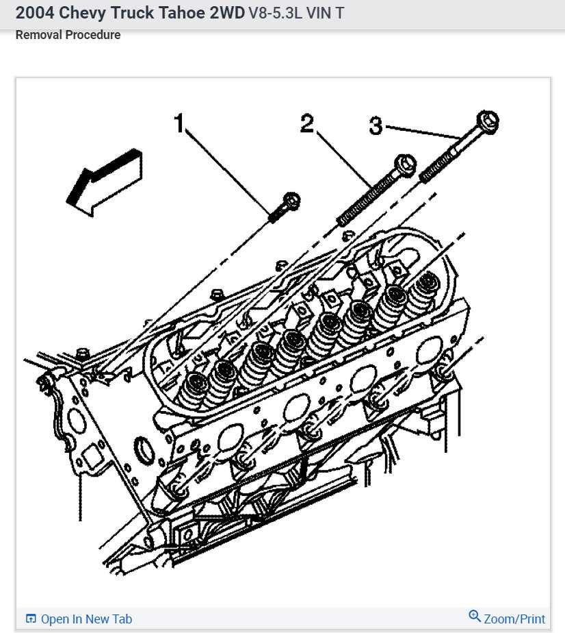

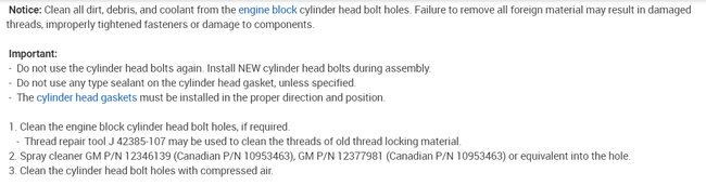

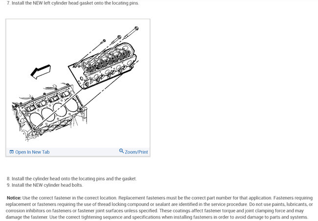

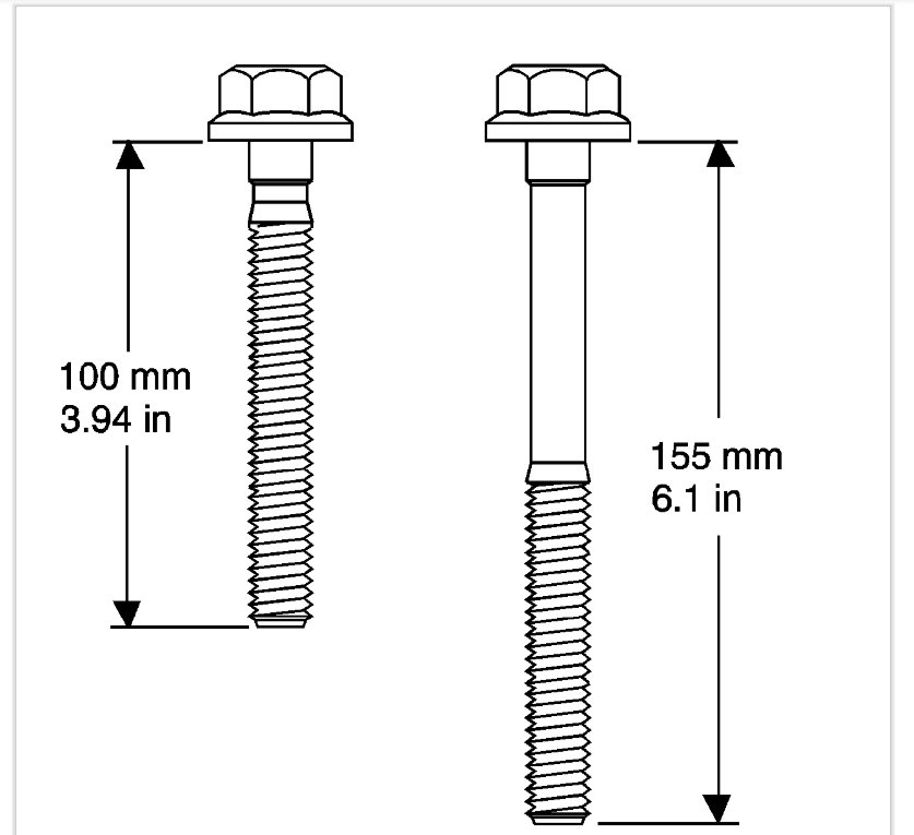

I have decided I am going to pull the heads, clean the valves and top of pistons, lap the valves with either the wooden lapping tool, or with drill and 1/8 vacuum tube, and install new lifters.
It will be my first time ever but looks like fun. I have watched several zero (0) lash setting videos and will do it per attached link below.

I am going with new head bolts but not sure if I need first or second design bolt kit.
I will dig deeper.
