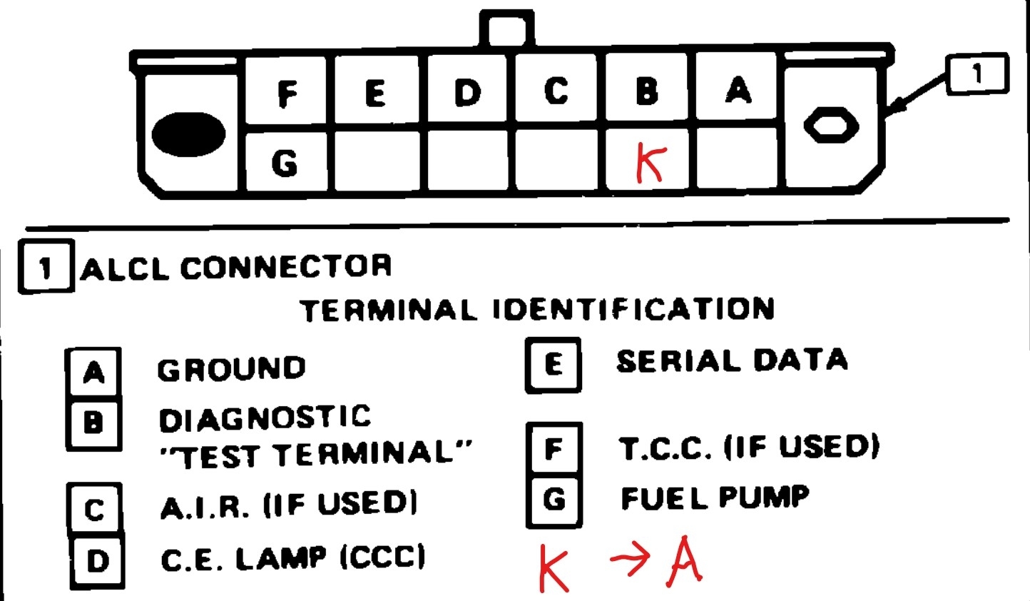

How to read codes for infl rest light?
1991 CHEVROLET CAMARO
42,000 MILES • 5.0L • V8 • 2WD • AUTOMATIC
TOBY LEE2
Infl rest light.
May 19, 2025 at 8:16 PM
STEVE W.
  • 15,172 POSTS
You can read the codes in flashes of the air bag light, but only the current code(s)
You ground the K terminal to the A terminal in the ALDL connector. Then turn on the key and count the flashes. It will start with a 12 then the code(s) that are stored. So if you see one flash then 2 flashes, the 3 flashes and 1 flash, that would be the 12 and a code 31 and then it will repeat until you remove the jumper. Then post them here and we can look them and relevant testing up.

TOBY LEE2
Thank you. I am not getting the vehicle until next week. I will respond with more at that time. Thanks

TOBY LEE2
The only code that flashed was 12. Reset light. On the test drive the lights were off. Thanks again.
