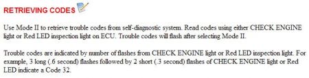

1992 Infiniti G20 NO START

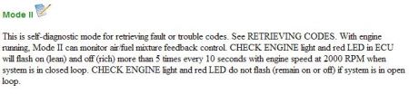

HOW DO YOU CHECK COMPUTER FOR CODES ON A 92 AND IT WONT START i'M GETTING FUEL AND A YELLOW SPARK AT THE PLUG KIND OF WEEK ANY HELP WOULD WOULD BE GREAT

To retrieve your codes, perform the following operations:
https://www.2carpros.com/forum/automotive_pictures/261618_Noname_34.jpg
https://www.2carpros.com/forum/automotive_pictures/261618_Noname2_16.jpg
Post the codes you retrieve, if any, and I will follow up with the definition and diagnosis for the code.
