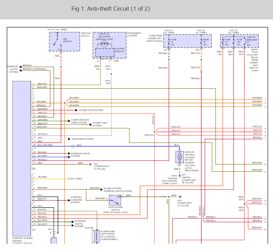

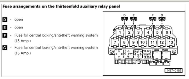

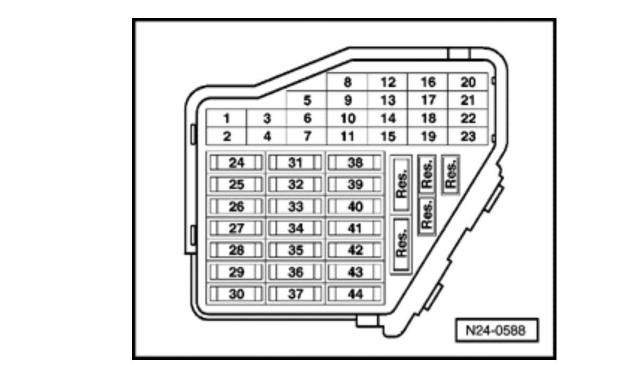

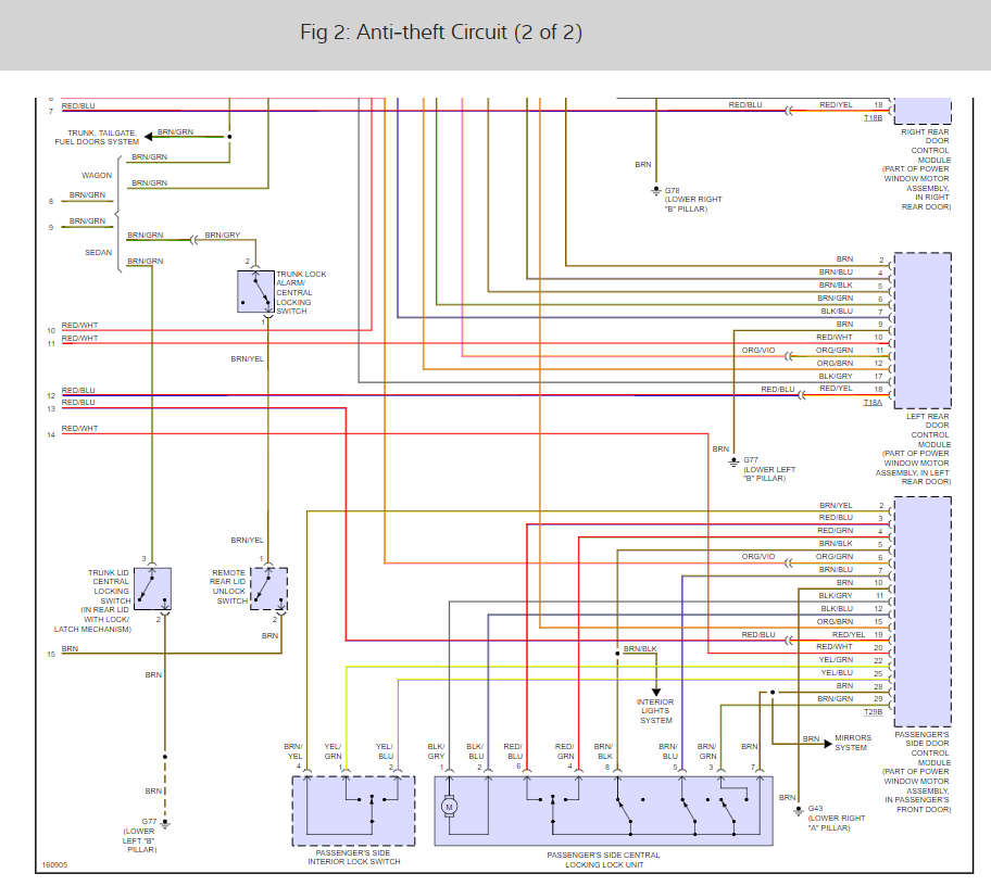

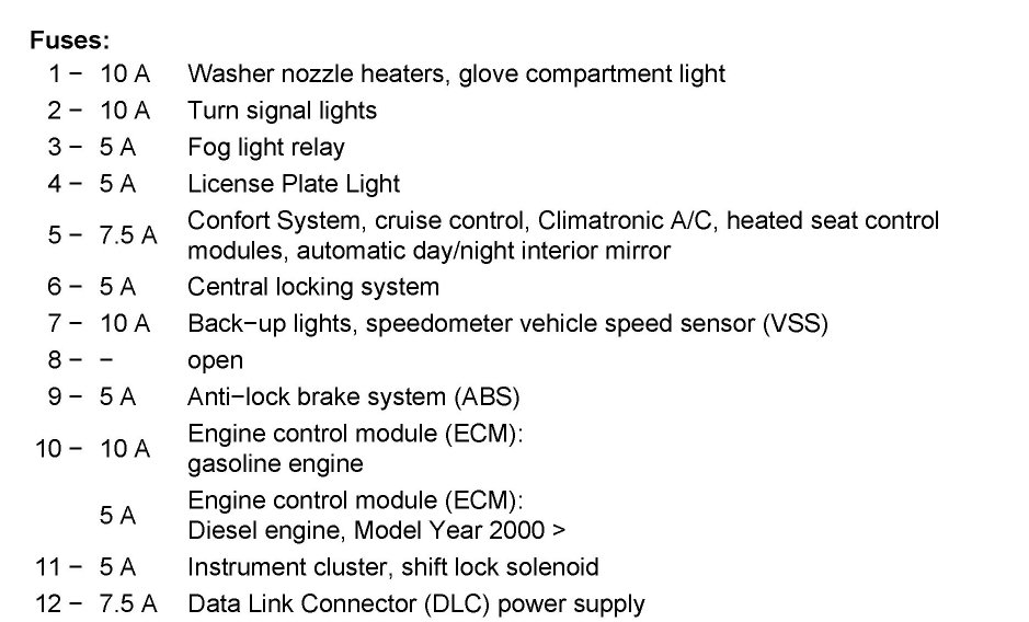

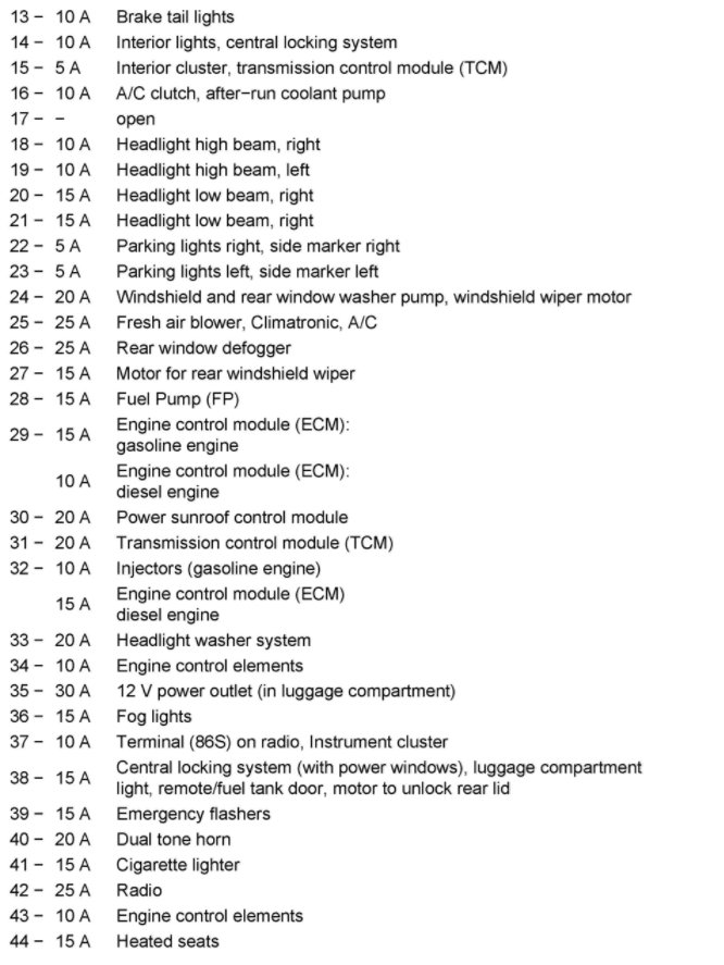

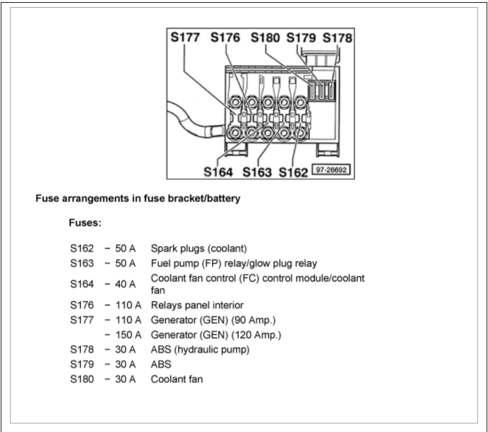

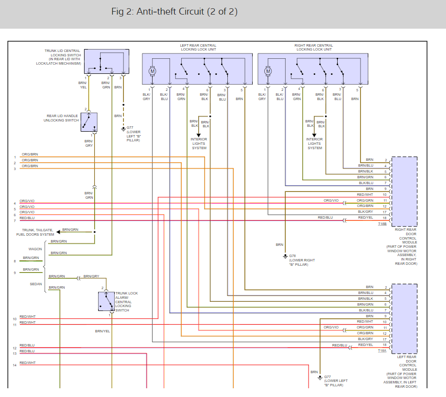

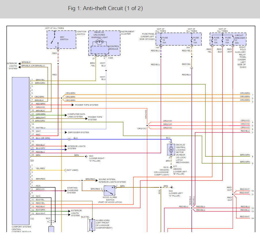

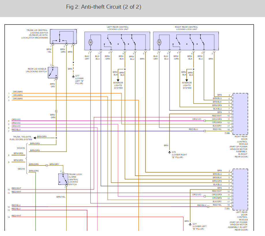

There are alarm control modules in all of the doors along with a central controller along with a module in the instrument cluster. I have heard of the drivers door module going out.
Lets start by checking the system fuses which there are five.
Here is a guide and the alarm wiring and fuse panel locations to help us get started testing:
and

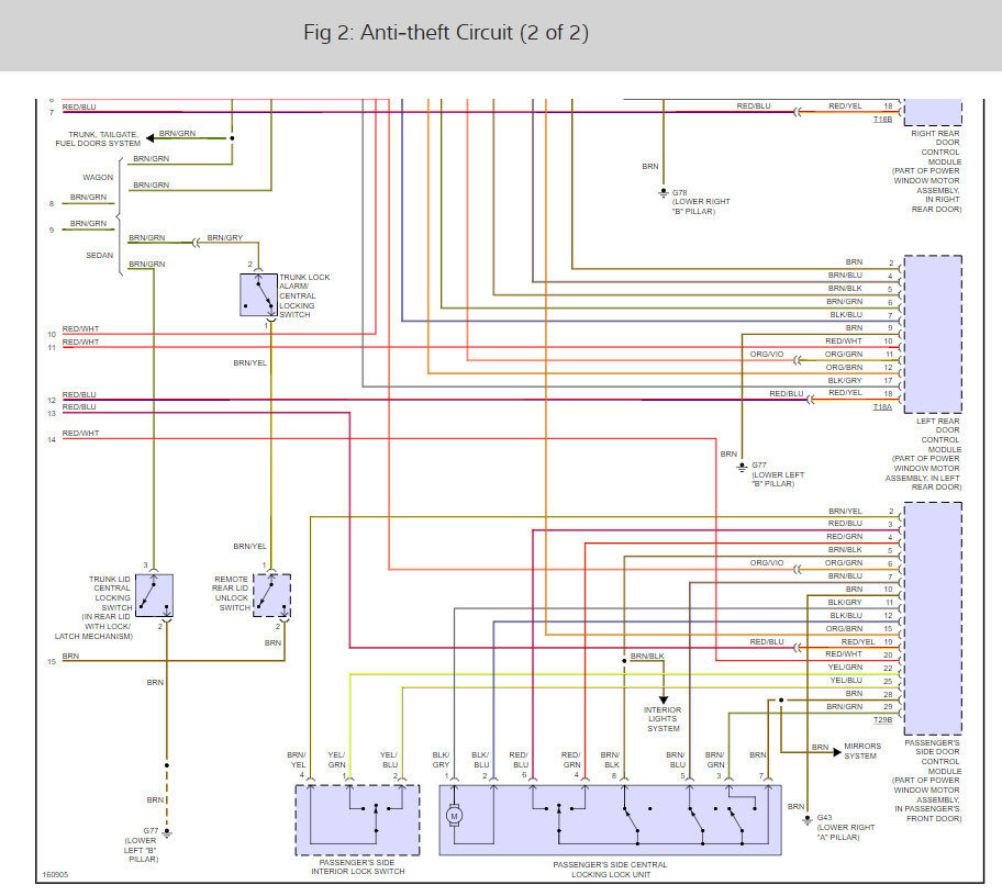

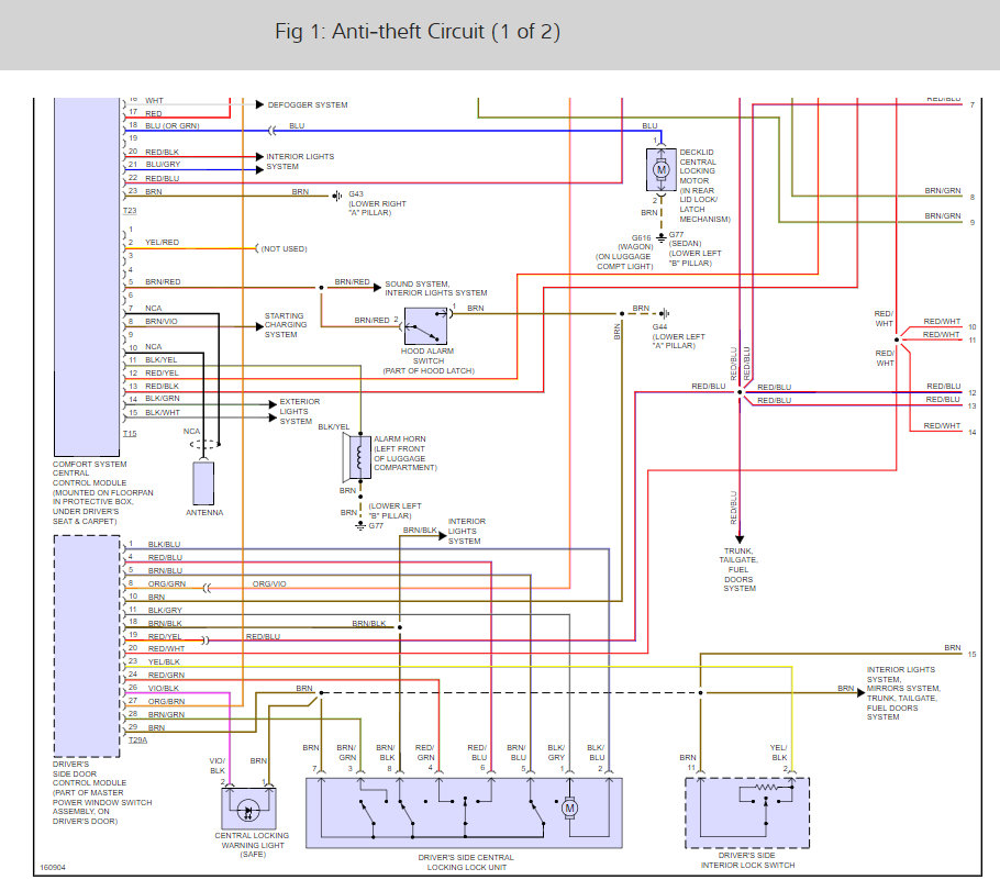

Yes the have broken the system up into many controllers not just one centralized unit. You can see by the wiring diagrams how the system is set up. If I had to make a prediction I would say the drivers door module is out because they get the most abuse.

Yes you can tell by the wiring diagrams they are all connected the CCM under the drivers seat but the drivers door module goes through the most abuse naturally.

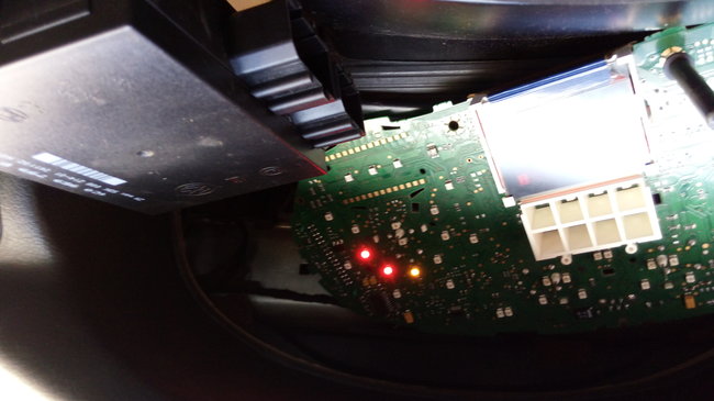

Hi Mr Ken,

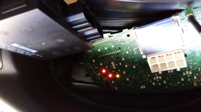

I depose CCM module, I make ignition on then the message "immobilizer active"com on.
I tried to start engine, it start and it shut down after 1 second.
Conclusion H1 hypothesis is true.
Let's chuck image of my experience:
Saturday, February 3rd, 2018 AT 9:52 PM
LHOS
  • 9 POSTS

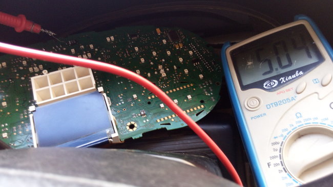

By the way, I made a voltage mesurement on pins of green and blue connectors with ignition in on position. Any one can comment plz?

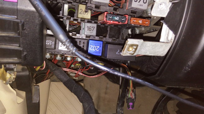

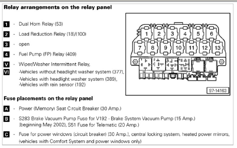

Ok. I try to test relay n 167 (i suppose that it was designed to command injection pump). I pick up the couvercle the turn ignition on. The relay shut for a moment then it open. Is this normal?
Sunday, February 4th, 2018 AT 12:41 PM
KEN L
  • MASTER CERTIFIED MECHANIC
  • 55,291 POSTS
Yes, it sounds like a normal cycle.
