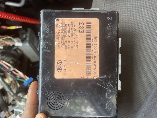

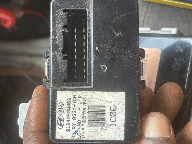

Where is the Immobilizer control unit located?
ANDRIN ATEM
  • 420 POSTS
Which of the anti theft system does it leave the pcm to? Referring the orange and brown wire.
Wednesday, August 27th, 2025 AT 6:03 AM
KEN L
  • MASTER CERTIFIED MECHANIC
  • 55,291 POSTS
Only the brown/org and green wire go to the cluster.

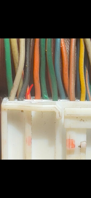

Thanks Ken, you have been super supportive. Problem solved. That connector to instrument cluster, I noticed a short on 13 pin, so I had to cut it, then the key light showed with key on run position. Later I reconnected the wire and the light stayed on and kick the car and it started.
Wednesday, August 27th, 2025 AT 2:26 PM
ANDRIN ATEM
  • 420 POSTS
The wire I marked in red was shorting, because I ran a continuity with a multimeter and noticed the bit was shorted to ground.
Just as the fault code described
