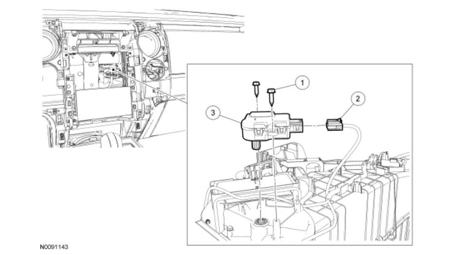

Clicking noise in dash, possibly the blend door actuator?
Good evening.

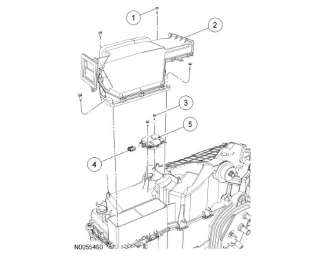

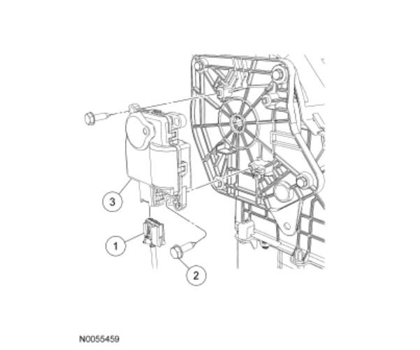

Try commanding heat and cool and see if it gets louder or stops. Then try going from defrost to floor and vent and see if the noise changes. Check out the diagrams (Below). Please let us know what happens.
