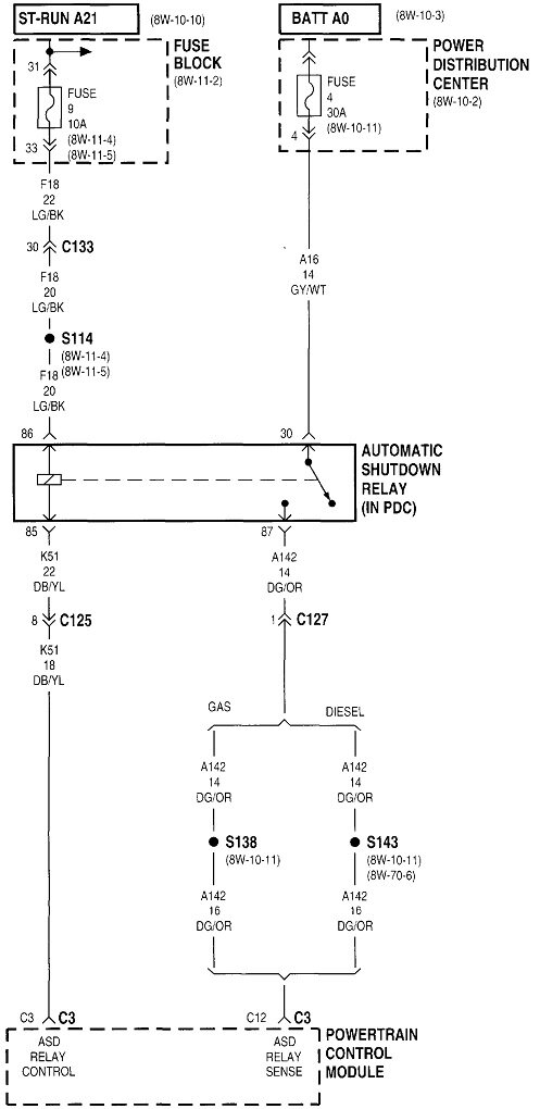

After many months of down time I have concluded that the dark green with orange strip to coil is dead, my scanner says short on ASD, and should there be 3 hot prongs where the relay goes?

What kind of symptom are you chasing?

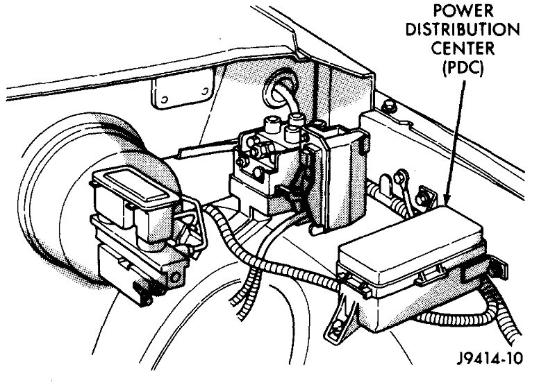

I've never seen that fault code or message on any of my scanners. Instead, poke a test light into that dark green / orange wire by back-probing at the ignition coil or any injector, and see what it does. You should see it light up full brightness for one or two seconds when you turn on the ignition switch, then it will turn on again during engine rotation, (cranking or running).

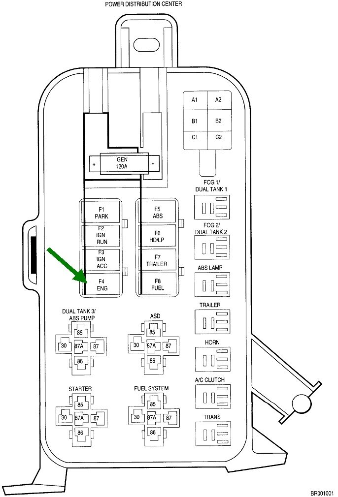

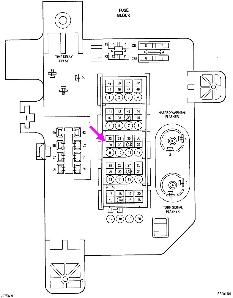

If the test light never turns on, there may indeed be a short to ground on that wire. The best place to look for that is at the oxygen sensors. They have heaters inside that are powered on that same circuit. Sometimes a harness can fall down onto hot exhaust parts and develop a short.
If the test light never lights up on that dark green / orange wire, move its clip lead to the battery's positive post. It will light up now if there is a short on that line. I'll type up a neat procedure to help you find the short.

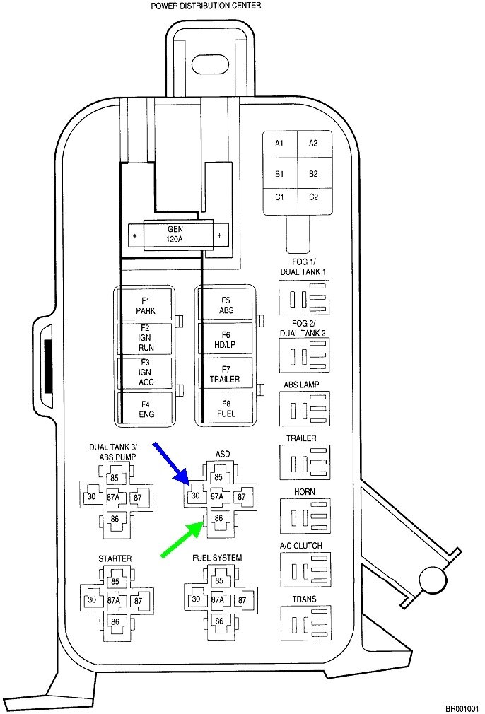

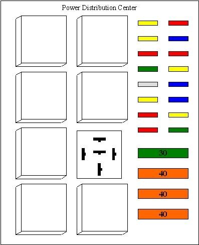

Also, if that line is shorted, fuse # 4, a 30-amp in the under-hood fuse box will be blown. The green arrow is pointing to that fuse in the third drawing.

The Engine Computer turns the automatic shutdown, (ASD) relay on for up to two seconds when you turn the ignition switch to "run", then it turns it back off until it sees engine rotation. That is a safety system built into almost all fuel injected vehicles. If a fuel line is ruptured in a crash, the fuel pump would dump raw gas on the ground, creating a serious fire hazard. Instead, with no fuel pressure, no fuel can spray from the injectors. The engine would stall, there would be no signal pulses from the camshaft position sensor or the crankshaft position sensor. That tells the computer to turn the ASD relay off to remove power to that circuit. The 12 volts is switched off to the ignition coil(s), injectors, oxygen sensor heaters, alternator field, and the fuel pump. On some models there is a separate relay for the fuel pump, but it is switched on and off at the same time as the ASD relay.

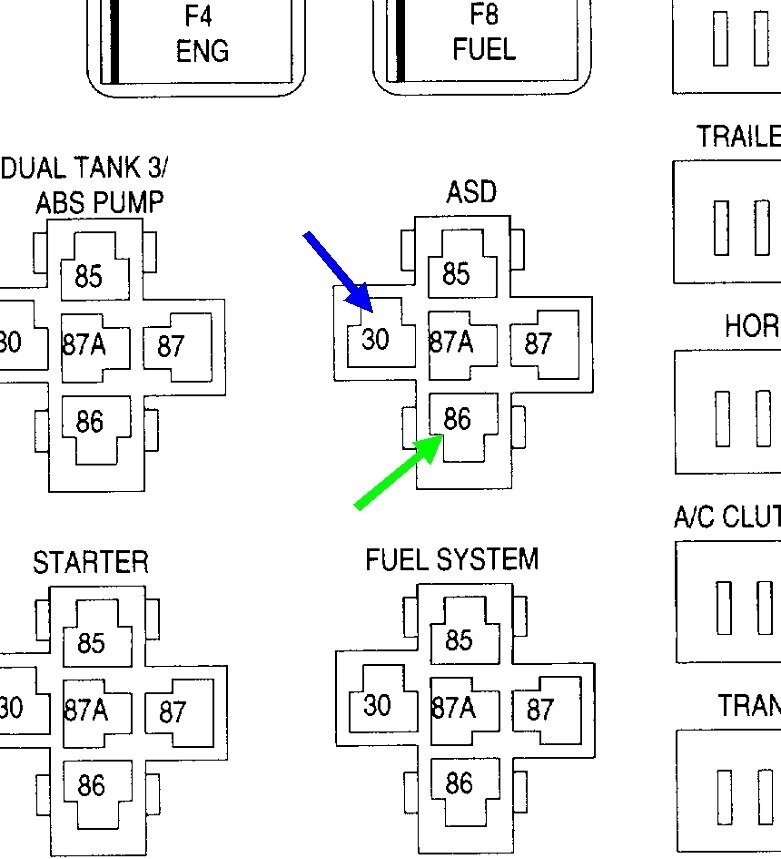

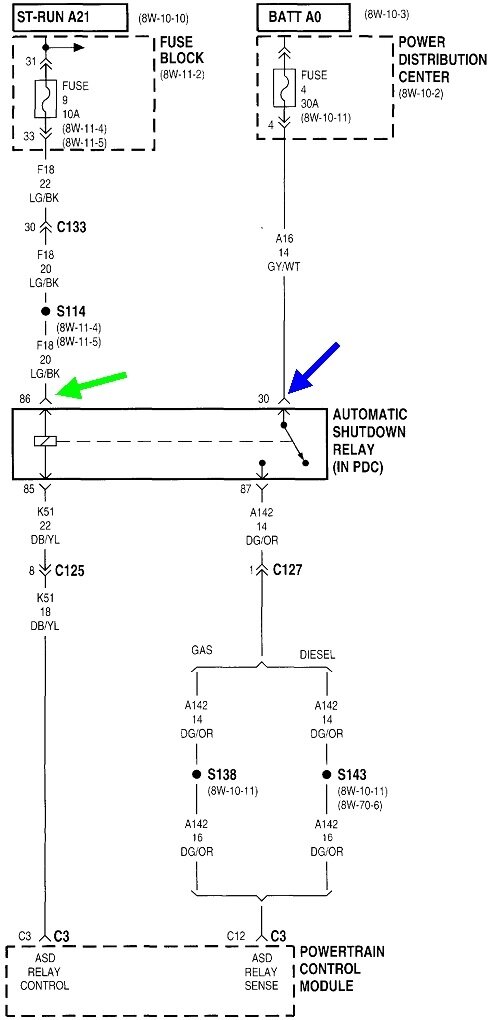

To back up a step, if you do indeed find no 12 volts at any time on the dark green / orange wire, we have to look at the ASD relay circuit. Either it isn't turning on or the switched 12 volts is being lost. Remove the ASD relay, then in its socket, check for 12 volts on terminal # 30. It should be there all the time. Just touch the probe of the test light, (or voltmeter) to the terminal. Don't poke the probe into the terminal as that can spread it leading to intermittent problems in the future. Terminal # 30 is shown with the blue arrow in the second drawing. These can be hard to read, so I blew it up for you in the third drawing. The fourth drawing is just the same thing in generic form for all the different relay styles. The one in the upper left corner pertains to your truck. I'll come back to terminal # 30 in a minute.
If you do have 12 volts on terminal # 30, check next on terminal # 86. That one should have 12 volts when the ignition switch is in "run". If that's missing, check fuse # 9, a 10-amp, but he is in the Junction Box, (inside fuse box), purple arrow in the fourth drawing. That box is on the left side of the dash, (fifth drawing).

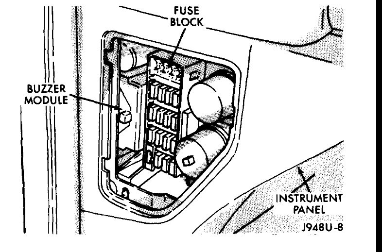

If there's 0 volts on terminal # 30, fuse # 4 is blown. It will have to be replaced for the next test, but first, use your ohm meter to check for real low resistance to ground on terminal # 87. You can use a paint-free metal point on the body or on the engine for ground. If you find close to 0 ohms, the new fuse is going to blow when you reinstall the ASD relay and turn on the ignition switch. Instead, leave the relay out, then we will bypass it with a light bulb. A 3157 brake light bulb works well for this procedure. To simplify this for the benefit of others researching this topic, I put together a series of drawings to show what we're about to do. The bulb will limit current to a safe one amp, and it will give a visual indication when the short is present. When it is, the bulb will be full, normal brightness, and hot, so be careful that it isn't in contact with anything that will melt or burn. When you do something to remove the short, the bulb will get dim or go out. At that point the circuit will resume trying to work, but the bulb will likely limit current too much. You can wiggle wire harnesses and unplug things to see what makes the short go away. Look for harnesses that fell down and are laying on hot exhaust parts or on top of metal brackets with sharp edges. Also look for a fat harness laying on the inner fender. Those can slide back and forth as the engine rocks, leading to worn paint and wire insulation, then an intermittent short.

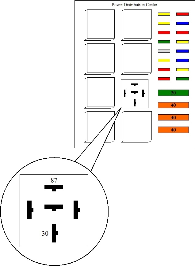

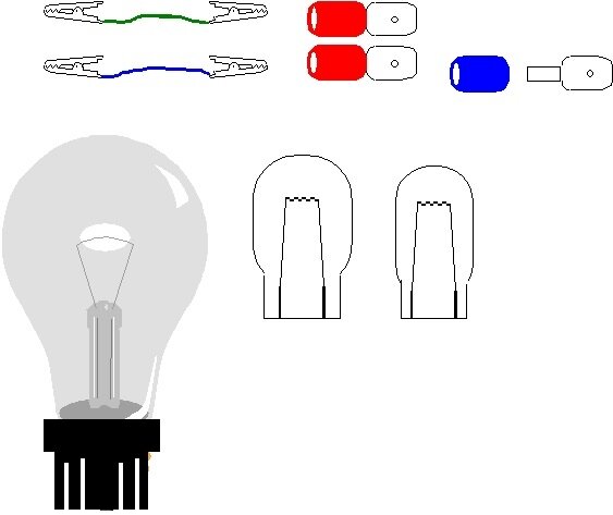

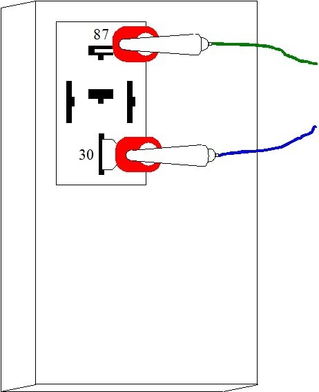

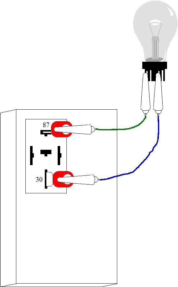

This light bulb procedure can be done by replacing a fuse or a relay. Starting with the sixth drawing, I showed the steps for bypassing the relay because that allows you to safely power up the circuit without needing to turn on the ignition switch. Also, in this circuit, if you replaced the fuse with the test bulb, you would need the computer to turn the relay on. That's a miserable job unless you have a scanner to do that.

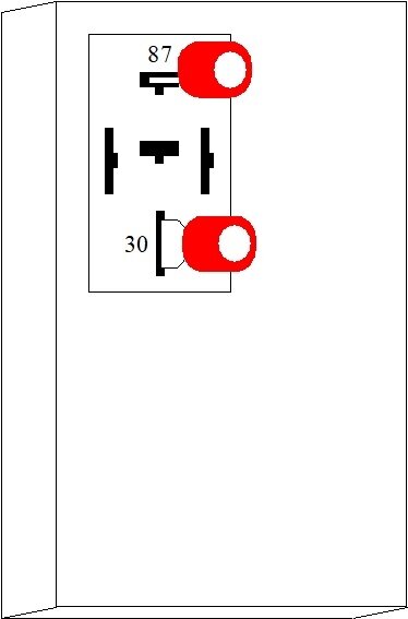

Drawing # 7 just shows an expanded view of a common, typical relay socket. # 8 shows the items needed. Two small jumper wires with clips on the ends. A dozen cost around $4.00 at Harbor Freight Tools. I use the small ones because the alligator clips fit into most things being tested. The size of light bulb depends on the type of circuit being diagnosed. A common 3157 brake light bulb will allow a maximum of one amp of current to flow. The smaller 194 "peanut" bulb allows up to a half amp. If you need more current, such as when working in a heater fan motor circuit, a common 9004 head lamp bulb will allow five amps with the low beam and around six amps if using the high beam filament. You'll need two generic flat spade-type universal crimp-style terminals. A small box of them costs only a couple of bucks at any hardware store. These are the same thickness as a relay's terminals, so they won't spread or stretch the terminals in the socket.
Starting in drawing # 9, the universal terminals are plugged into relay terminals # 30 and 87. (They form the letter "T"). Next, the clip leads are attached, and finally, they're clipped to the bulb. At this point if there's a short present, the bulb will be lit up full brightness. The new fuse won't blow because only one amp of current is flowing. Start by shifting wire harnesses around and unplugging things to see when the short goes away. When it does, the bulb will get dim of go out. You might unplug the oxygen sensors to see if one has a heating element that has become grounded inside. A deformed rear cover on the alternator could touch the 12-volt supply terminal. A shorted injector or ignition coil is pretty much unheard of, and won't show up with the test bulb because none of those circuits are being turned on on their ground sides by the computer. If the short is related to those things, the better suspect is a grounded wire going to one of them.
Once you find and repair what is shorted, reinstall the ASD relay and the engine should start and run.

You need to jump terminals 30 to 87 in the ASD relay's socket. That simply allows you to check for 12 volts at the various places without needing the Engine Computer to turn that relay on. It also allows you to take your time instead of being limited to that two seconds the computer turns the relay on.
Terminal 86 has nothing to do with this part of the circuit. That's one terminal for the relay's oil.
I put this drawing together some time ago to show which terminals to jump for the different styles of relays.
