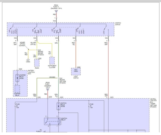

My car listed above has the V6 2.6L engine. I am having what seems to be either and electrical problem or a bad ignition switch. When ever I turn my key to the on position I have power (dash lights up, head lights are active, radio works). I also notice things like the humming sound that the fuel pump usually makes is no longer there. Whenever I turn the key to start nothing happens. A few of my gauge lights turn off and some stay on but engine does not turn over (brand new Optima battery). But, when I pop start my engine using a screw driver touching the start it turns over, but still does not start. My ignition coil is not receiving spark to any of the plugs. Whenever I use my battery tester to test my alternator and check to make sure its receiving power and it is giving me a negative reading. My shifter does not move out of park. Whenever I press the button to shift I hear a clicking sound from the ignition switch. I have tried everything I know. Need help.

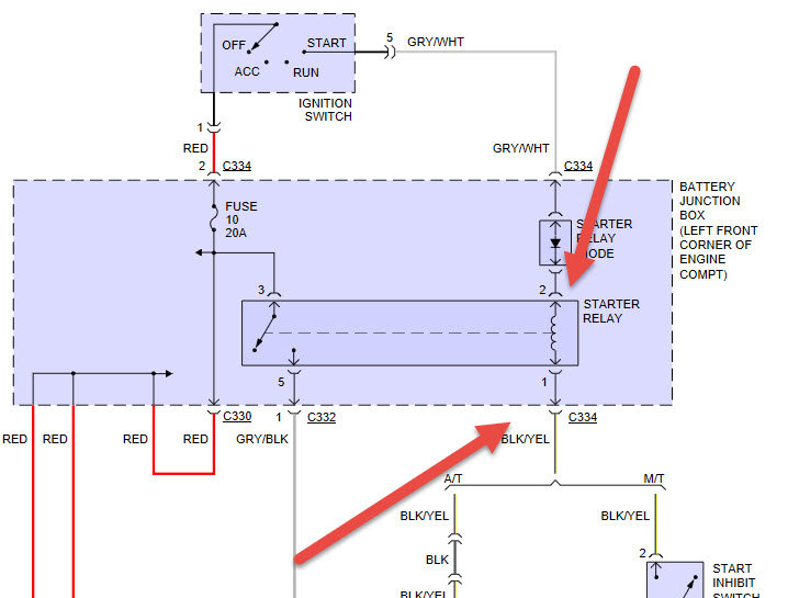

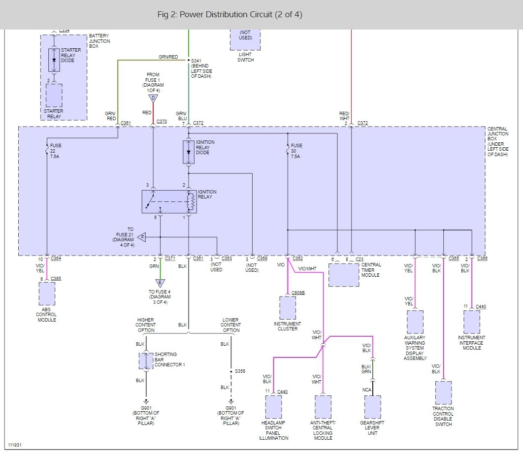

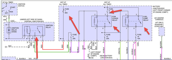

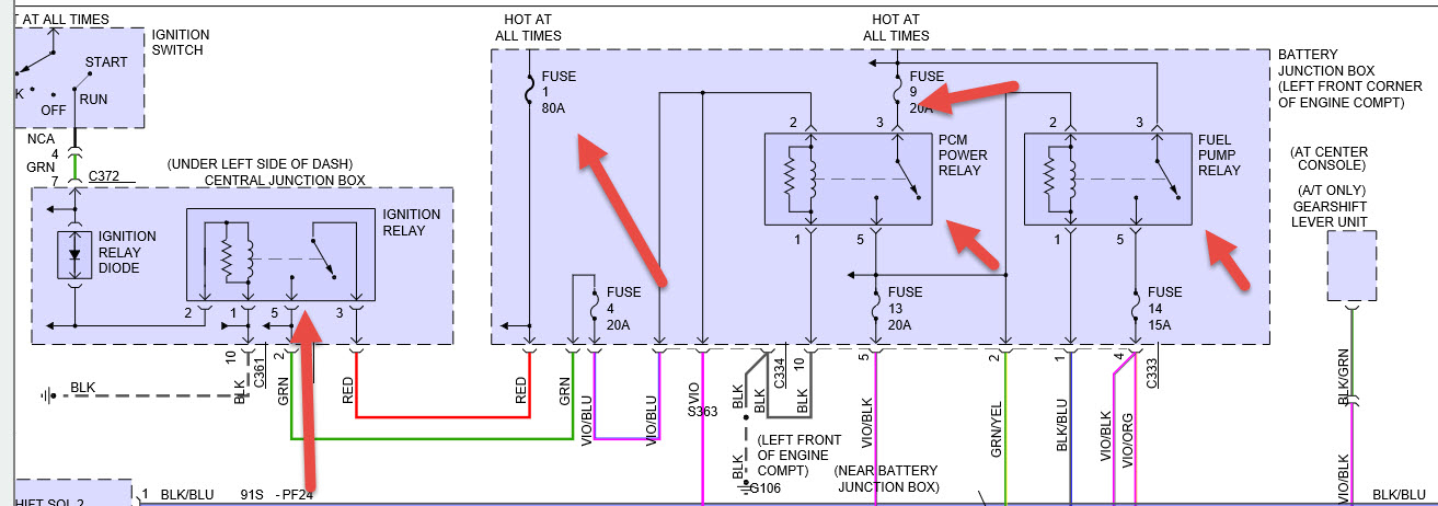

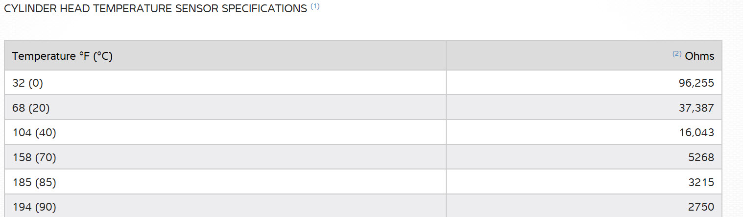

Check ECT resistance it will be similar to cylinder head sensor in picture as temperature goes up on car resistance goes down. Then check start relay under hood if not turning over see if power goes to both places. If no communication check fuses under hood and in car may have a blown fuse. Check all items in pictures marked with arrows. Also, check inertia switch behind left hand kick panel.

I used my multi-meter to test the starter relay in the power distribution box and it has readings that rose as high as.855. I used and old wire to connect terminals 85 and 37 and it cranks my starter. The fuse is not blown.

My Conjunction box has no slot for number five it is not in use in my manual. In my engine compartment (power distribution box) The Fuse number one is my main power supply it was giving my a rising reading when I connected my positive lead to it, and the negative lead of the multi-meter to the battery. My fuse number nine is my engine management and ten is starting, ignition, and headlamps. Those fuses did have resistance, and when I switch to check the current they did have power. I tested the fuel pump relay as well which I believe was the last arrow. Left me a bit confused but I tested the relay as well as the terminal. I used a wire to run together terminals 85 and 37 and I can hear the fuel streaming threw the check valve located above the radiator hose.

I will be taking over this question. Using you voltmeter test the input and outputs of the ignition switch to make sure it is working here is a wiring diagram to help you.
Test the power going in and the power going out once the switch is turning on. I believe the switch is down on the column.
Please run some tests and get back to us so we can continue helping you.
Best, Ken
+1
Sunday, February 19th, 2017 AT 11:54 AM

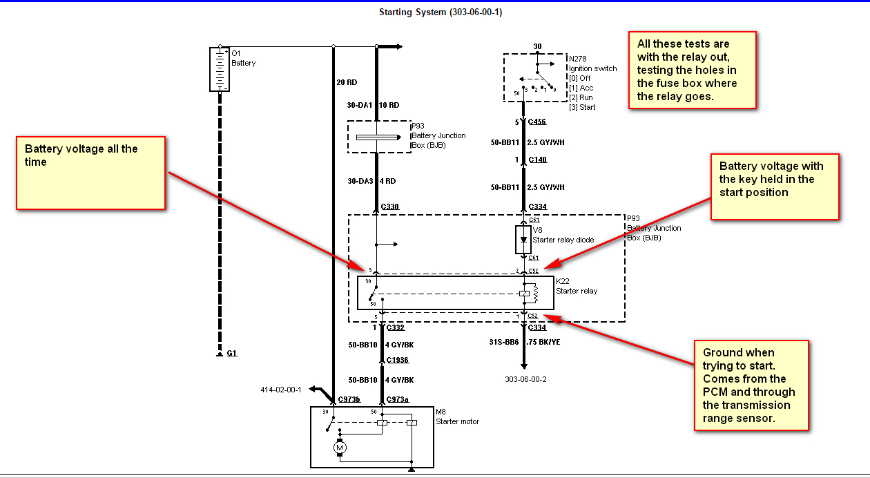

After Doing these test here are the readings I got
Ignition Relay (4 Pins)
Pin 1 and 3 Are Powered 11.84v
Starter Relay (5 pins)
Pin 3 is power with 11.85v
Pin 1 has 00.1v
Pin 2 has 2.6v
Engine Management (2 pins)
Pin 1 has 5.6
Pin 2 has 00.1
Monday, February 20th, 2017 AT 3:39 PM

This is the diagram I used for the starter.
Monday, February 20th, 2017 AT 3:44 PM
KEN L
  • MASTER CERTIFIED MECHANIC
  • 55,281 POSTS
Pin two having 2.6 volts is the problem if the key is in the crank position. It needs to have 12 volts.

Okay, any idea how to find where the loss of power is coming from? What are some things I can test or try to find the issue? My ignition relay from conjunction box is good. I hear the switch click when I press the button on the shifter. I also notice that my alarm light never flashes. Even when car is locked. But the clicker still locks my doors and sounds my alarm. But whenever I put the key in the door and turn it to deactivate the alarm it does not shut off.

Check fuse 10 in the fuse panel for voltage, and then pin 4 of the ignitions witch it leads right to the relay.

Fuse 10 has voltage so do pin #5 on ignition switch relay
