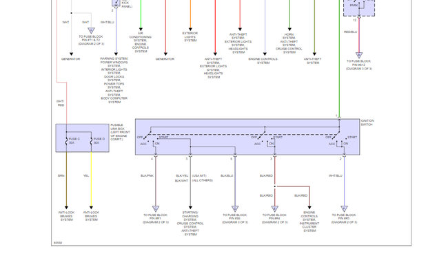

Put the key in the ignition turn it to the on position lights come on turn the key won't start, release the key lights go out no lights. Now when the key is on and it won't start. Headlights work, four way flashers work, the beeping of the door the key in the ignition work, other than that no lights on the dash. Batteries good, check the connections. The fuses all good. I haven't personally checked the relays or I'd not sure which ones to check underneath the hood. But that's what my problem is the car won't start, the lights won't come on the dash, I have no power to the ignition helping guide me. Also I have like a anti-theft key on the bottom left underneath the steering column. Maybe a car immobilizer usually has a red light on all the time when it's plugged in and it's not working.

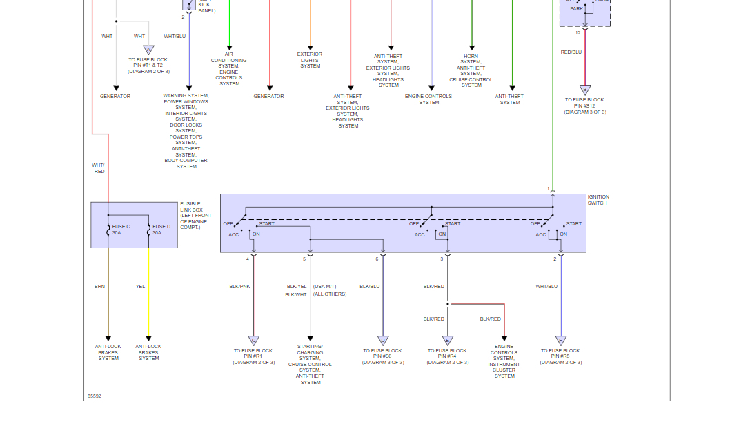

It sounds like you have an ignition switch problem but to be sure lets test this. please run down this guide and the wiring diagrams below to make sure you have power going through the switch.
Check out the diagrams (below). Please let us know what you find.

Hi this is Michael Edwards I try to start my car on again and underneath the hood it blew the 30 amp fusible link fuse that runs the anti-theft system, starting/ charging system and the cruise control system. So with that fuse out and ignition off and the key out, I took a continuity test from behind ignition switch from the black wire with a yellow stripe to ground and there is continuity. Also there was a white wire with a red stripe on the backside of the ignition switch and I took a continuity test from there to ground and it showed continuity. Is there supposed to be continuity on both those wires to ground.

Wire 1 should have continuity between 4, 3 and 2 with the switch on. Can you confirm?

With the key in the on position from the white wire with the red stripe (assuming that is number 1 ) I have continuity on all the wires on switch.
Can you send a diagram of position 1 and where 4 3 2 are?

Yes, check the wiring diagrams above they show the numbers.

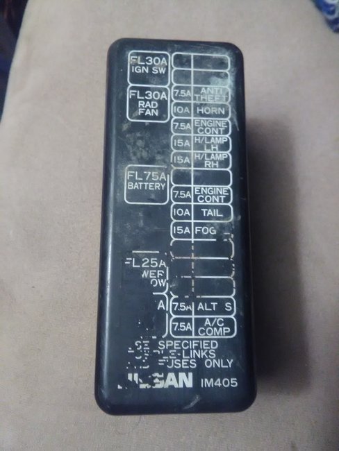

I sending you an attachment of the cover of the fuse box under the hood the 30 amp fuse that is blowing is the top one or when this cover is on like the pic shows the (FL30A. IGN SW) is the first fuse closest to and facing towards the windshield as I stand in front of car driver side. That 30 amp fuse is the one that blows.
This is what happens:
With key on off and stereo blower fan and resister disconnected and amti teft wired direct I turn key to acc. First position beeping for door open happens then turn to second position On lights on dash come on and from the time I turn the key to the on position you can count 1, 2, 3, 4 seconds and the 30 amp fuse glows like its arcing and blows. The metal on top of fuse melted and a gap. Every time It takes between three to four seconds to blow.
What do you think? Can you walk me through steps to trouble shoot. A site that has a complete wire diagram for a 1996 Sentra only? I notice the wire diagram you sent me is the right color code once the ignition wires go from the back of switch to first wire connection 9 inches from switch under steering column
The wires past that first connection is where your color code starts on your diagram. I couldn't figure out because I couldn't follow the colors from switch.

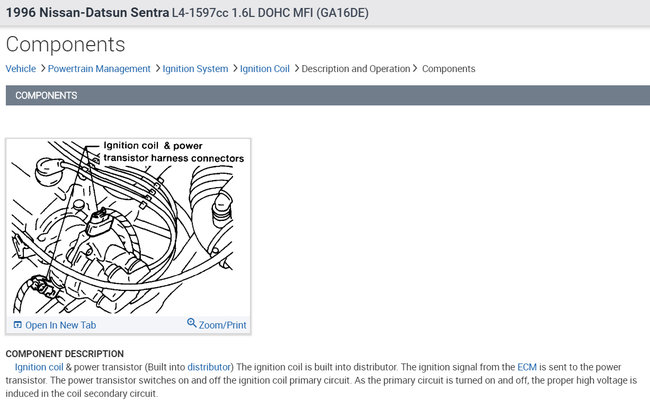

Can you unplugging the ignition coil and the replacing the fuse? Turn the key on the see if the fuse blows.

Is the ignition coil inside the distributor cap? I've tried to google for a picture or video of where the ignition coil is and nothing comes up. Please help by posting a picture or video showing where it is and how to get at it. Thank you

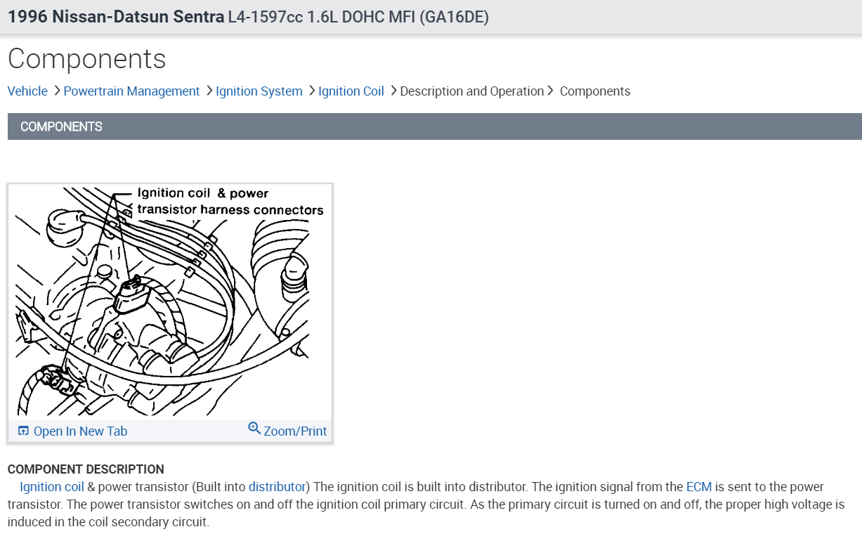

The coil is inside the distributor so just unplug it. Here is the diagram that show the location.

Well Ken, you solved the mystery! I unplugged the two wires as you said and the car was turning over and no blown fuse! Awesome! I sure took apart a lot of stuff to figure it out! But am totally grateful for your help and walking me through this nightmare. Now, does that mean I need a new Ignition coil?
