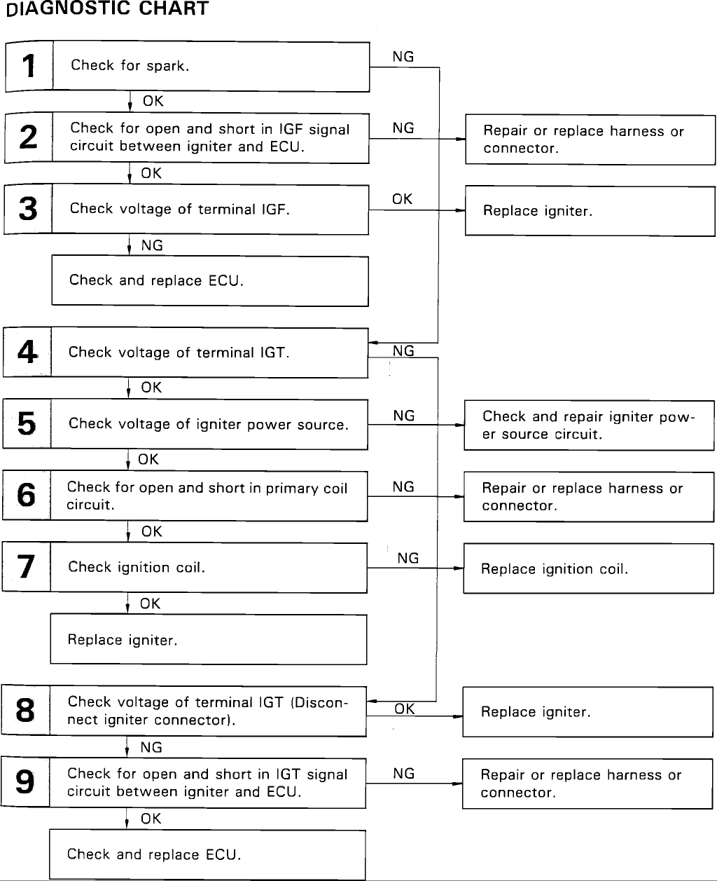

Ignition error code 14
1994 TOYOTA WINDOM
100,000 MILES • 3.0L • V6 • 2WD • AUTOMATIC
JUSTYOUNG

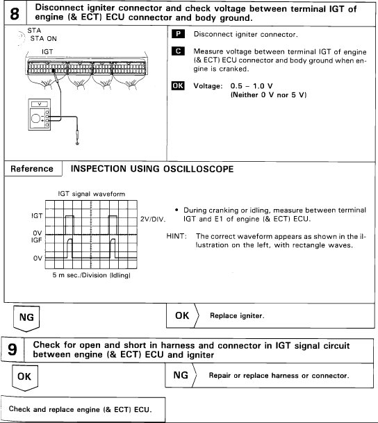

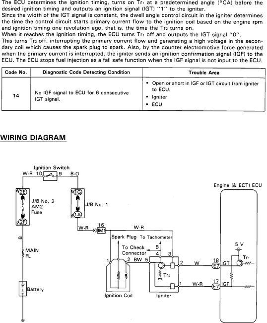

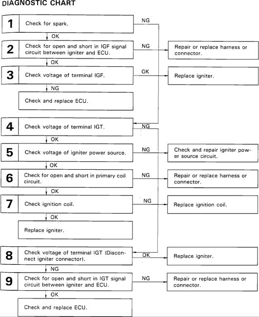

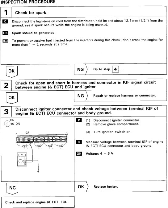

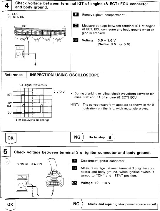

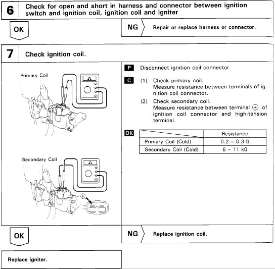

The problem with the vehicle is I am not getting a spark from the ignition coil. not sure if it is ECU, igniter or coil.

Lets start by checking the positive side of the coil for power when the key is on.
Here is a guide to get us started:

This is the diagnostic list for that code. Might help some.
