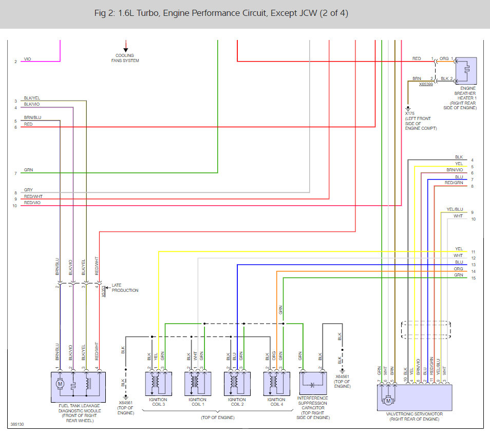

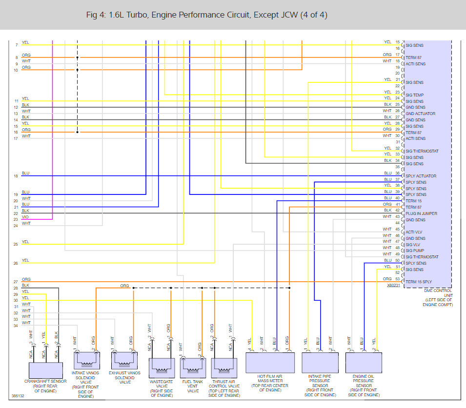

Today I have received the car listed above. I need help to know what is the correct colors of ignition coil connector wires diagram.
current diagram as following:
Cylinder number 1 : (green + white + black).
Cylinder number 2 : (blue + blue + black).
Cylinder number 3 : (green + yellow + black).
Cylinder number 4 : (green + orange + black).
is it correct?
I need to know the correct wires because engine is misfiring with several cylinders and all above wires can replace other : (1 and 2 can replaces the other)
( 3 and 4 also can replaces the other).
Any help please.
Thanks

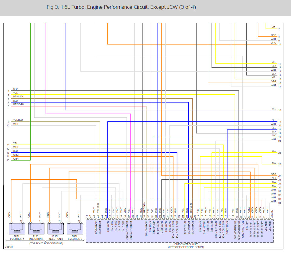

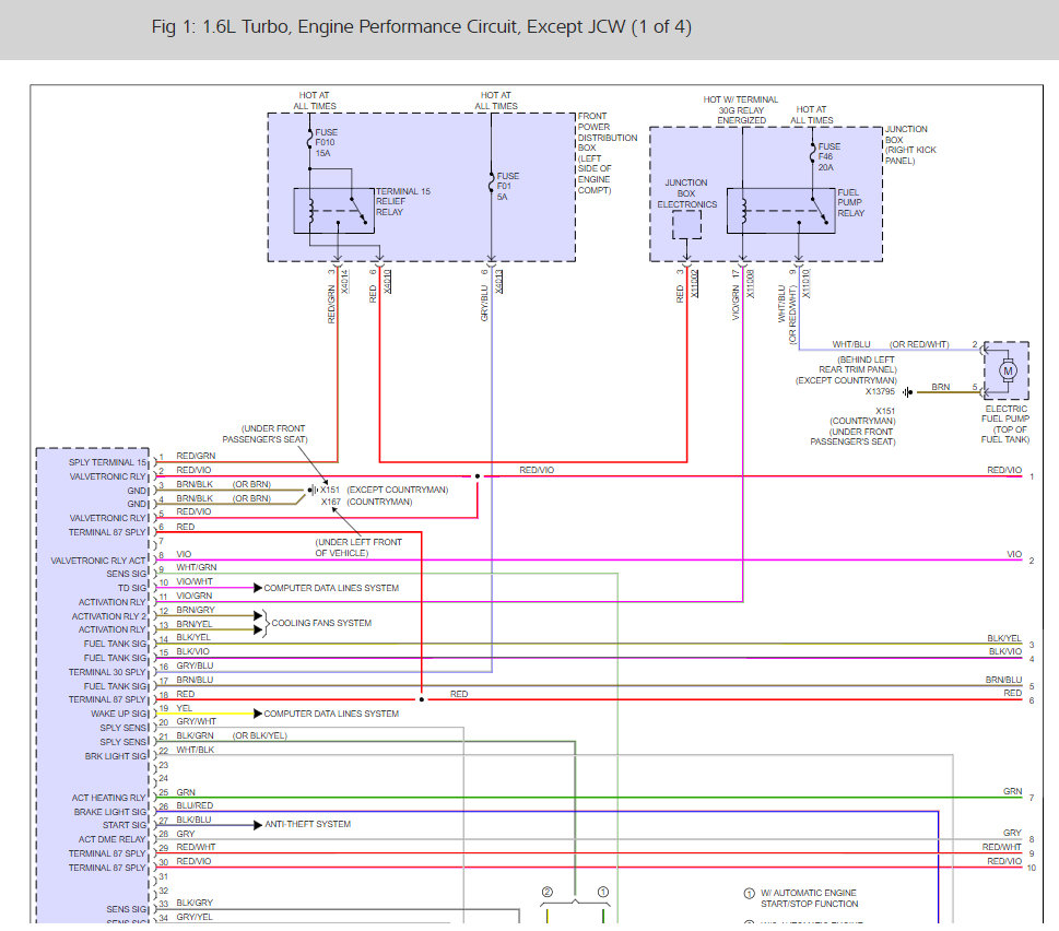

Here are the engine wiring diagrams so you can check them out and get the problem fixed. (below)

Checked then scanned and found following codes :
2C58 / 2D60 / 2EE1 / 2EE8 / 2EEB / 2EEF / 2EFE / 2F00 / 2F01 / 2F02
assistance please.

It sounds like you have a vanos going out not indexing the camshaft correctly. Can you clear the codes and then just turn the key on to see if any hard codes come up?
