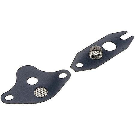

Steve, after getting a few notifications from resellers that the Kleen Screen (product number 47007) is not compatible with the Buick 98 LeSabre 3.8L, I called Dorman, and spoke to a senior technician named Peter, who said Dorman does not make a Kleen Screen for the Buick.
At that, I asked Peter what he would recommend, but he had no recommendations.
Good idea, though, and thanks!
Thursday, May 23rd, 2024 AT 12:47 PM
STEVE W.
  • 15,676 POSTS

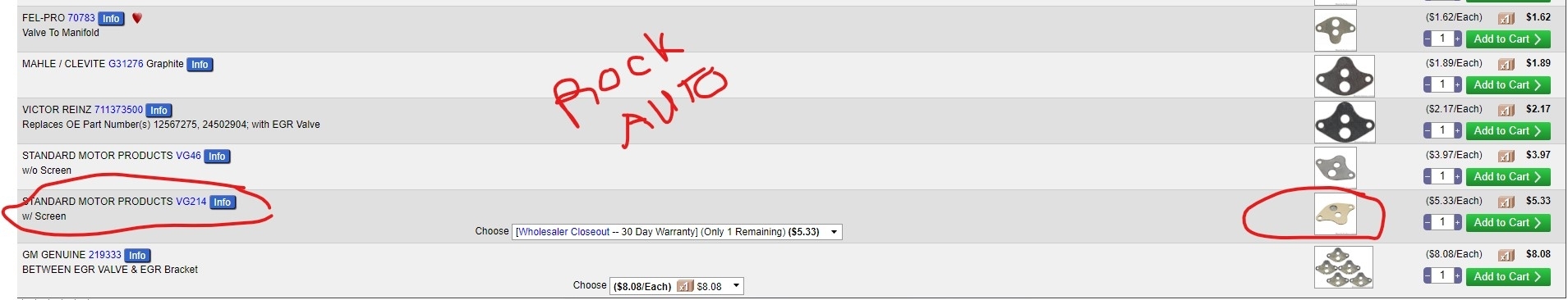

Yeah, there were a number of different companies that made them, there are also screens that just pushed into the port like a freeze plug. They have sort of gone away because of design changes that deal with carbon better. These days just finding the correct parts can cost you hair! Finding a part that was only made for a specific use can be a real headache.
BUT if you look at the Standard Products VG214 you might be surprised, and if you look at the two in the image, I attached above you might also notice something, IE just because they say it "isn't right" doesn't mean it doesn't fit. GM only used a few EGR base designs.

Steve, one of the gaskets has exactly the right footprint for the original, so I'll call Standard Products now, and ask about their #VG214. And if they claim incompatibility, I'll ask why it will not work.
Thanks for the link to the 3800 forum-- these are very useful, which is why you use them.
Will keep you posted.
Thursday, May 23rd, 2024 AT 1:11 PM
STEVE W.
  • 15,676 POSTS
Well, considering it is in their catalog and can be bought for the 3.8 in multiple parts stores. I don't know what they will say unless they stopped making them. But the Dorman one is the same base design.
+1
Thursday, May 23rd, 2024 AT 1:24 PM
ALPHAA10
  • 232 POSTS
Standard's technician said product VG214 will work with the pneumatic EGR valves, but not the electronic EGR valves. According to the tech representative, the wire screen "screws up the electronics".
