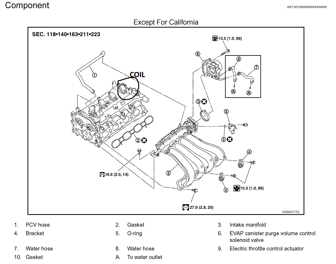

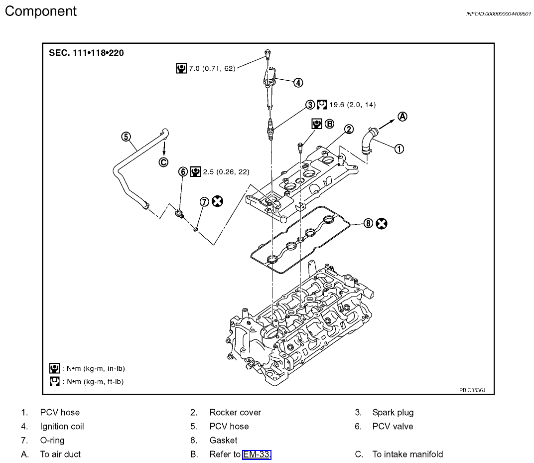

Are you able to send me pictures of instructions of where to find the location of the ignition coil?
Thursday, November 17th, 2016 AT 4:28 PM
JIS001
MECHANIC
3,412 POSTS
You need to remove the intake manifold to access the coils.
