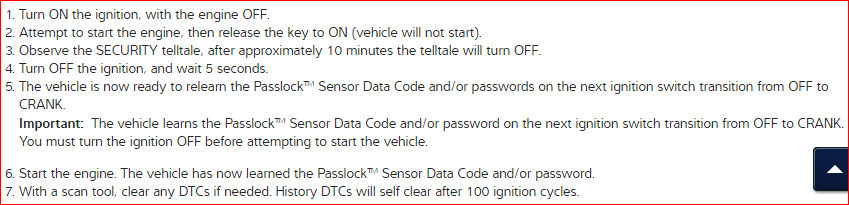

Had a problem with my car not starting awhile back, had it towed to shop, they said it was some kind of security lock out and they reset something but did not tell me what they did. Now it is doing it again and I tried the ten minute battery thing I saw online but no go. Help?
Tuesday, August 7th, 2018 AT 7:19 PM (Merged)
DANNY L
  • 5,648 POSTS

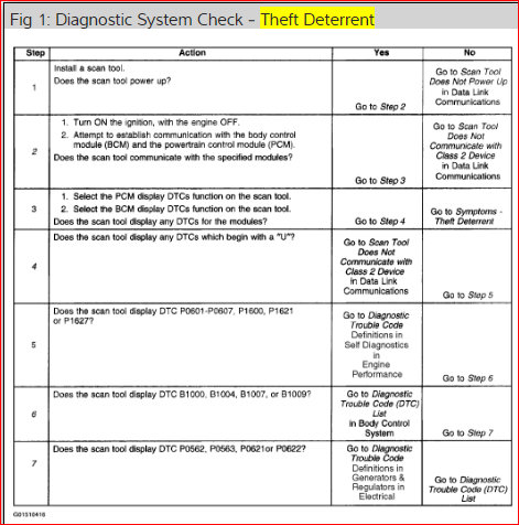

Hello, I am Danny.
Here is a relearn/reset instruction for your car. I have also attached a link for general how-to reset procedure. Hope this helps!
Danny-
https://www.2carpros.com/articles/how-to-reset-a-security-system
-1
MOLLYDAD
  • 28 POSTS
Which fuse is it? It does not say in the owners manual which one.
DANNY L
  • 5,648 POSTS

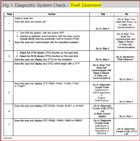

Here is a test procedure for your anti-theft system. Do you have access to a diagnostic code scan tool? Did you try the Oldsmobile factory reset I provided? I will look to see if I can find your anti-system fuses. Danny-
