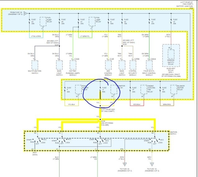

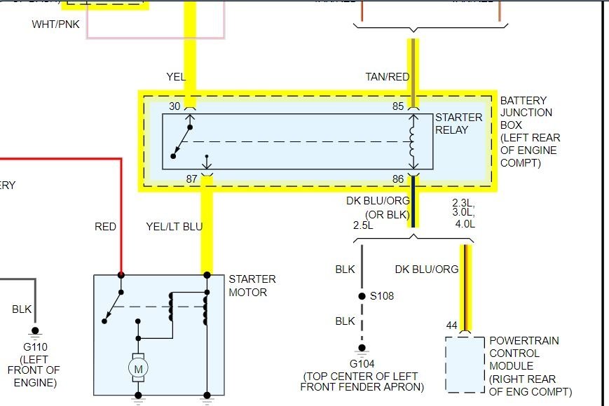

Everything was fine and went to start truck and nothing happened. Main wire to starter shows 14 volts. Solenoid wire shows no power but shows it is grounded out. Swapped relays (assumed its good) and checked 7, 5 starter fuse (no power). Ran jumper wire from battery to solenoid and the engine cranks but will not start (I believe fuel pump has also shut down). Also have no dash lights.
I had to replace lock cylinder and have transponder key programmed two years ago and I am thinking that transponder key needs to be reprogrammed but I tried the second programmed key and still nothing. What do you think? Thanks
Monday, March 8th, 2021 AT 5:21 PM (Merged)
Good morning,
I attached a wiring diagram for you to view. Do you have a test light or voltmeter to do some testing?
What wire is grounded?
Do you have a security or theft light? If you do, does it go off after about 10 seconds with the key on?

The wire triggering the solenoid is showing it is grounded (continuity between battery negative post and wire) and is not hot. Checked with voltmeter. Starter wire is getting 12+ volts. No dash lights working except when you turn on there is a very faint instantaneous glow of the theft light (about 0.5 seconds). Do you know if the transponder key needs reprogramming would it automatically ground out the solenoid wire. If not maybe a wire in the ignition switch has chaffed and grounded out. 7.5 fuse is good but shows no power getting to it when trying to crank engine. Again thanks for your time.

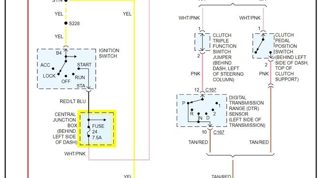

Okay, first, we need to address the 7.5 amp fuse. It needs to have power in the start position only.
Can you verify that? That comes directly from the ignition switch. We need to start there.

Okay, then if you looked at the diagram I sent you in the beginning, the ignition switch sends that power. You need to test for output from the ignition switch itself. You may have a bad ignition switch.
The switch is under the dash. Check the wire listed in the diagram I sent for power in the start position.

Used test light to check red/light blue and all yellow wires coming from ignition switch when cranking and no power. Checked continuity from red/light blue wire coming out of ignition switch and 7.5 amp fuse and had continuity.
Okay, then it looks like you have a bad switch. The red/light blue should have power in the start position only.

One question so that I understand. None of the wires that plug into the ignition switch has any power going in or out. For the ignition switch to put out power as the key is turned where is the power coming into the ignition switch?

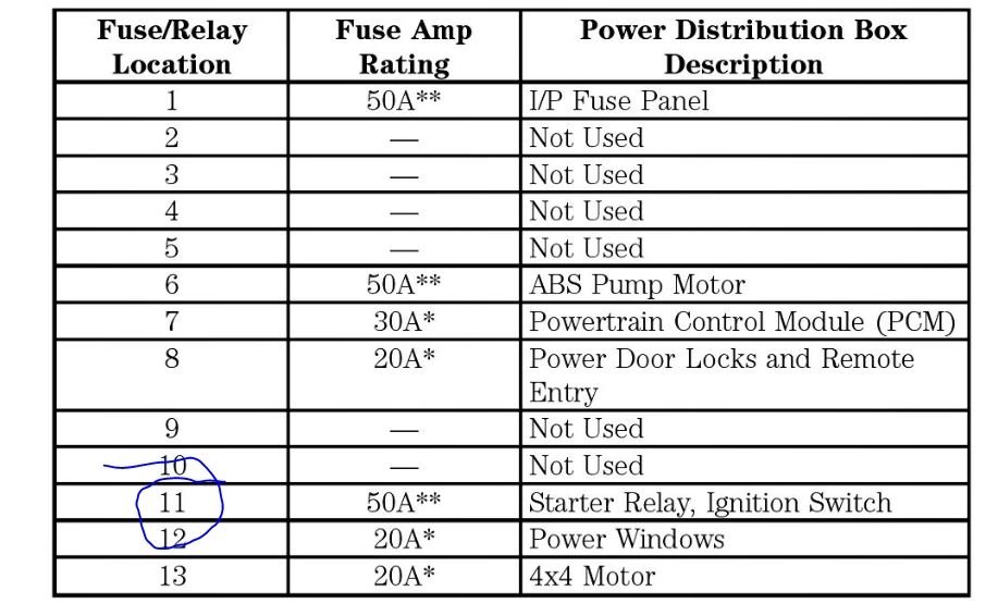

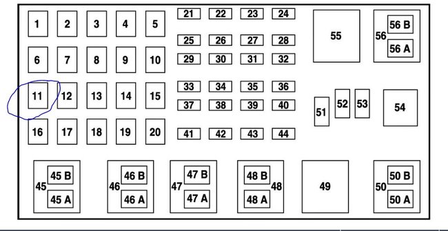

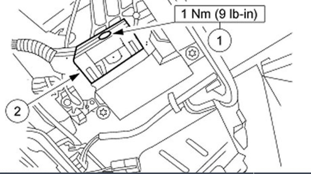

Okay, I attached a diagram for you. The yellow wires are powered by a 50 amp fuse in the under hood fuse block. Check this fuse for power at the fuse.
I also attached a fuse box diagram for the location of the fuse to be tested.

You were right 50 amp fuse blown. Power is getting to fuse just not going though. Not sure why fuse blew but I will replace and hopefully it will not blow again. If it does whole new set of problems. Thanks very much for your time and walking me through this process.
Monday, March 8th, 2021 AT 5:22 PM (Merged)
You are welcome.
It will fail again. Fuses fail for a reason.
I would replace the ignition switch itself as that is the most common failure for that fuse to fail.
